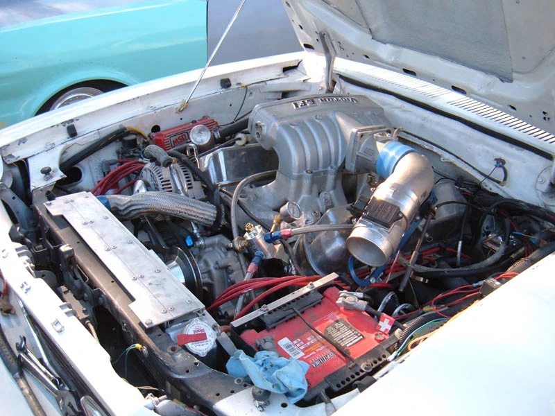

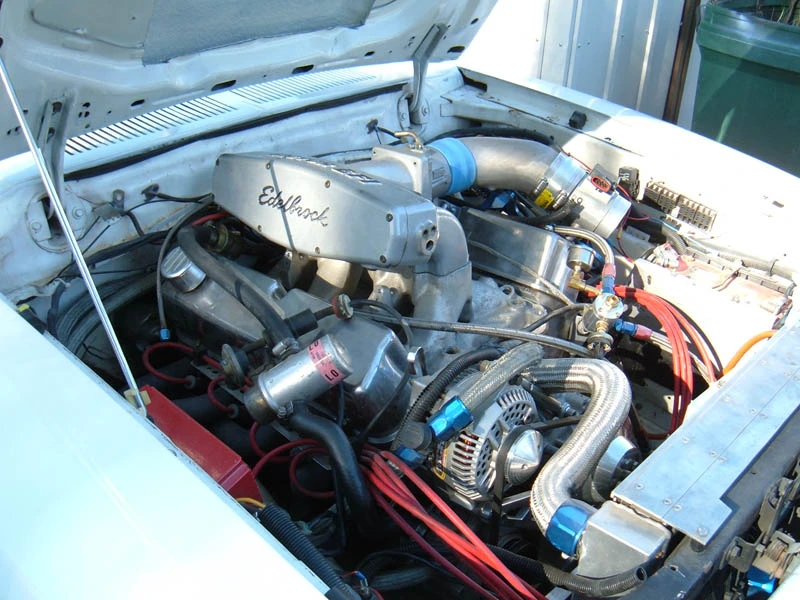

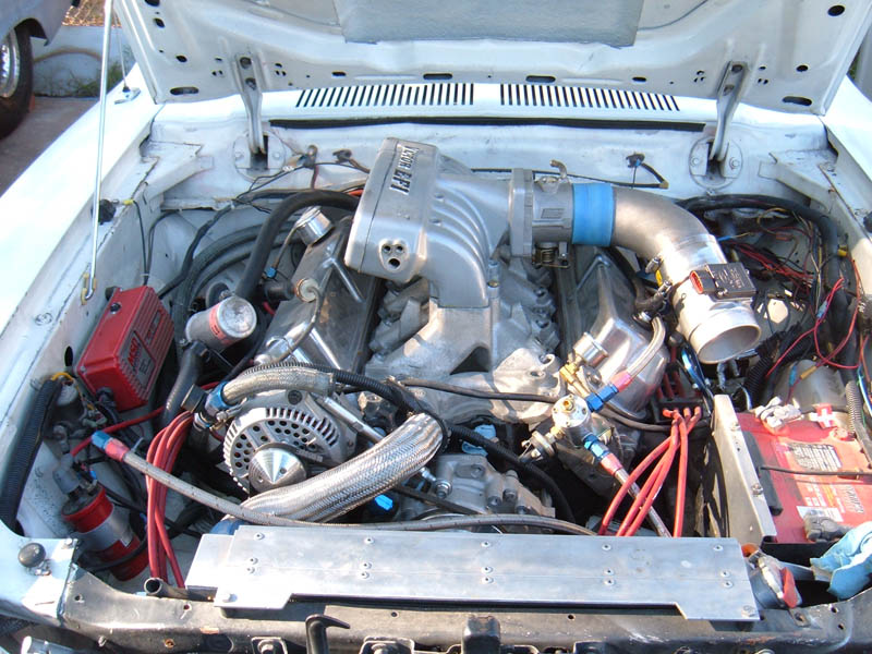

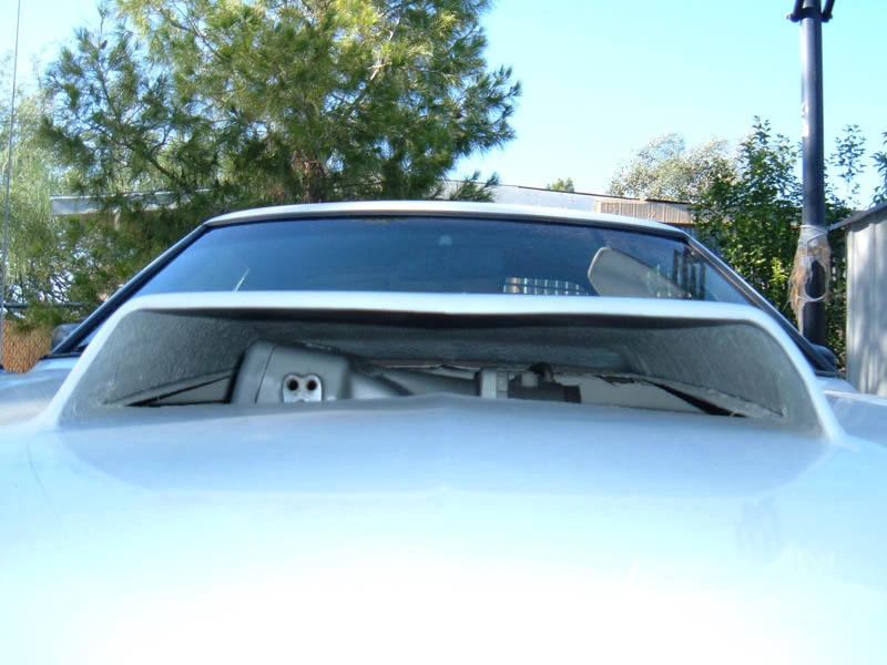

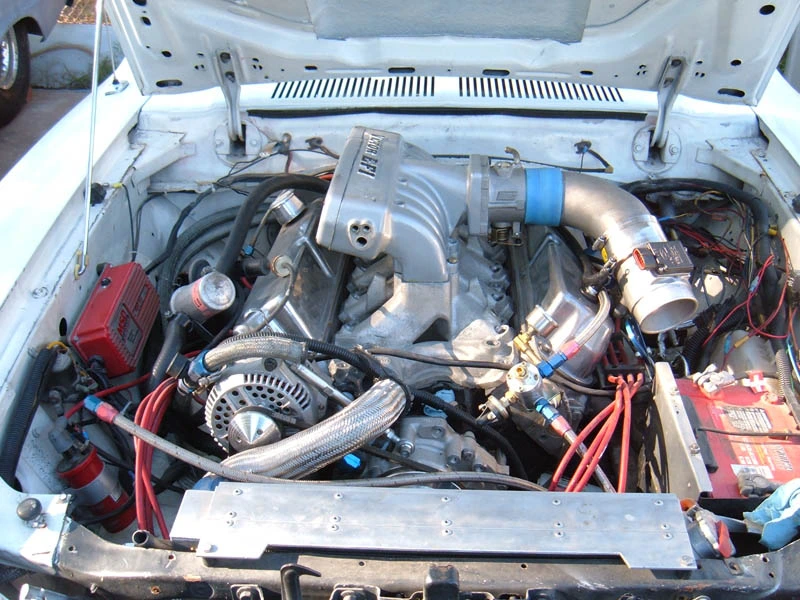

It has begun. Old intake out, new intake mocked up.
Gonna have to get used to this though...
I'll keep adding replies as I make progress. I'll be making backwards progress soon.. intake has to come off, as well as the heads, and radiator.

Yea, I didn't realize I had it backwards.. supposedly it'll work either way though. We set it up like it is cause my dad thought it made the most sense for the throttle linkage on the TB.. we've only known carbs, so this stuff is all new to us.
My battery will be headed to the trunk either way though, so it could stay how it is, just haven't decided.
In my project, progressing but no pics till I can repair/replace the camera, I found the intake is better routed the opposite of how you are doing it, this allows for the use of 87-95 5.0 stang parts w/ less hassle. You can use the later model mustang throttle cable, throttle cable bracket, ect. By going this route you open up a large source of aftermarket of parts and accessories and reduce fabrication.
