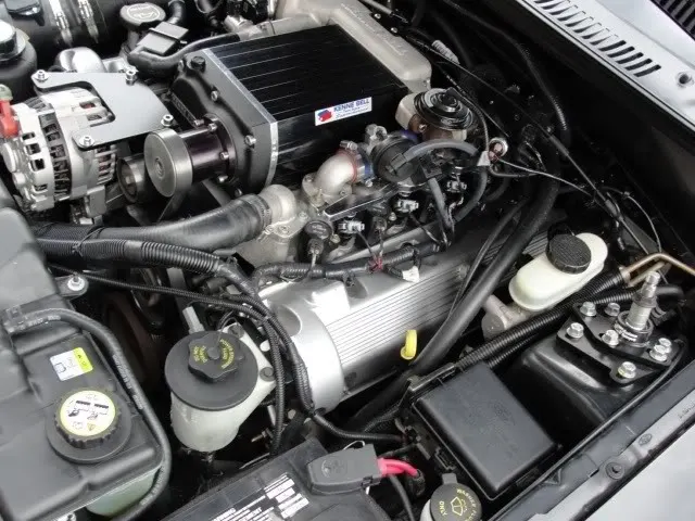

Here's a pic, that Gatorback belt sounds interesting if it changes the sound of the supercharger, I actually think mine is way too quiet, I guess I figured it would whine louder since I've heard so many loud ones on Youtube LOL.

I wouldn't think the A/C delete would affect the belt length.
Nice clean engine bay but what's with the strut on the driver's side? Is it normal that the thing protrudes that high through the strut tower?

Kenne Bell emailed me back already, said to use the 108" Gates or Dayco.
