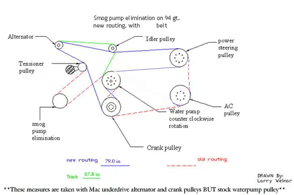

belt length to bypass the a/c and the smog pump.....
well in the accident i had, my ABS box on the left side of the bottom of the engine bay hit the smog pulley, and cracked it into many pieces, and i dont wanna get started finding smog pulleys and crap, and my a/c is already out, so what length belt do i need to bypass both smog and a/c??? any part numbers or whatever would be great :nice:
since you're not going to be using that belt anymore, cut it so its one long piece, wrap it around the pullies with the tensioner held up, mark where it meets back up with the other end, then measure it... Maybe add 1/2" onto it because of the belt tensioner... It'll give you a good starting point if not the exact size you need.
This should help :nice:

underdrives are crank, alternator, and water pump pulleys. this diagram shows keeping all of them. so, i dont see why this wouldnt work because a stock belt works with underdrives. the different size pulleys compensate for eachother.
did u get a short belt on yours that eliminated the smog and a/c?? i seem to remember us having this conversation on AIM once before..... :shrug:
mine currently eliminates/bypasses a/c (which is completly gone from the car) and i have a smog delete pulley which i have to get rid off since the flipped header for the turbo will hit it.:bang: . so this diagram is exactly what i need :nice:
