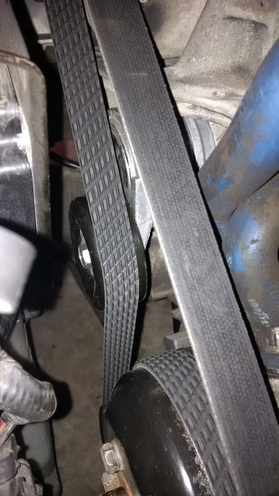

This spring my first trip with the car it threw the belt off which I thought was really odd. It destroyed the belt in the process, so I purchased a new Goodyear Gatorback belt. I also noticed that the belt was riding on the front of the new tensioner pulley which I thought was maybe why the belt came off.
So I used a 1/4 spacer behind the tension to push it out so the belt rode on the middle of the pulley. The belt no longer flew off but now I had horrible belt squeal at startup and a slight chirping at idle. I figured maybe my spacer meant that the tension was not 100% straight and thus causing the squeal, so I went back to no spacer and the squeal is still here.

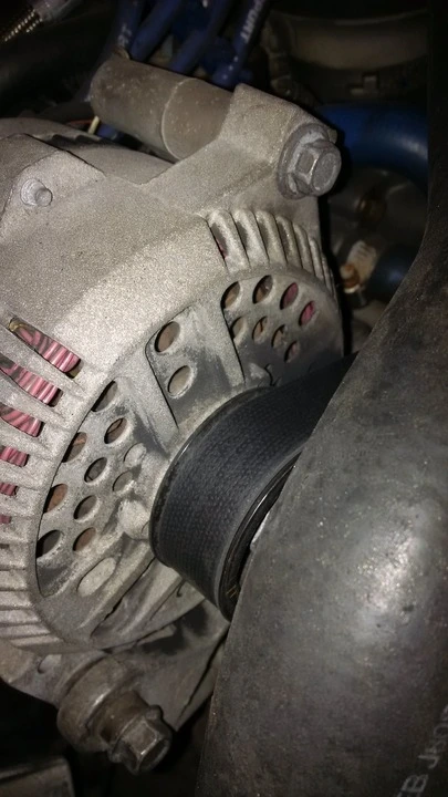

So three things come to mind now. One; my new belt could be glazed from the squealing and needs to be replaced again. Two; the aftermarket tensioner is crap and I should replace it with a Ford unit, or Three; I noticed a lot of rubber build-up around the alternator and perhaps my alternator is the cause? It is charging find and spins freely, but there is a lot of build up around it. Pictures attached to maybe help.

Shimming the tensioner pulley should not cause any problems, I've had to do so before as well as not all aftermarket parts are created equal. I'd be surprised if that was rubber dust on the alternator, usually metal dust collects there due to magnetism.

Usually when an idler is brand new it will spin a little tight, if it's well-worn it usually free-wheels pretty well. It may be worth a shot before you spend the money on a tensioner since they're pretty cheap. But it's hard to argue with the history you have -- if it was fine before, it's quite possible the tensioner isn't up to snuff. It's also important to check that the tensioner isn't bottoming out because the belt's loose. I also have a smog delete, and some brand belts seem quite a bit bigger than others. It should have some marks on it to tell you if you're within an acceptable range (the one you linked has two hash-marks on the top, between which the other one should sit when the belt is installed)..
I would remove the spacer to see if the squealing stops. If it does, you have the problem solved. The tensioner has a belt wear indicator on it. If the marker is in the good zone the belt length is okay. Also, using a soap bar, apply the soap to the belt to see if the squealing stops.
