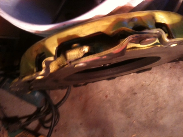

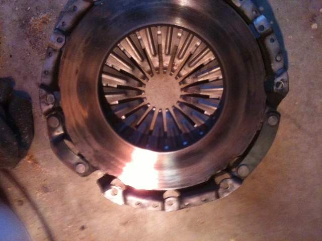

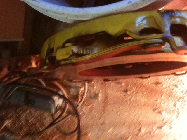

Bending the drive straps on a pressure plate!!
Has anyone else had this problem??? its happened on the street both times clutch is rated for 600hp hi rev clutch kit that i bought from promotion when i bought the tranny. 347 probably 500hp N/A. when it bends the straps it keeps it from properly seating back on the flywheel and kicks it out of balance.

The drive strap should be an even ‘S’ shape. It is designed to transmit power
from the cover to the pressure plate and subsequently the clutch disc. Distortion
will cause clutch Drag, harsh clutch operation and clutch Judder.
This is normally caused by:
Incorrect bolting sequence used during cover fitment, damage caused during
improper alignment of the disc,or dropping the cover prior to fitment.
If all the drive straps have a similar degree of distortion, the cover may have
suffered a severe shock during operation from poor driver technique.
(e.g. Selecting the wrong gear at speed, towing heavy loads, driving with
severe clutch Judder or with loose engine mountings.
...or not. What's the combo? What kind of torque numbers are you making? What RPM are you dumping the clutch at?
If in fact, you're causing that kind of damage from launching, then it may be time to step up to a multi-disk setup.
BTW, a clutch rated at "600 HP" doesn't really mean anything. How much torque is it rated to hold? How much torque are you making? What tires are you running?
Your pics of the face of the pressure plate look like that thing has been slipped brutally so.... heavier PP or multi-disk.

I have done the damage to the face of the pressure plate by slipping the clutch playing with my 60 foots . But have never had any problems with the clutch slipping.
