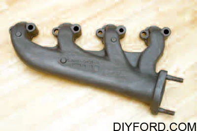

(Copied from DIYFord.com...)
The 289 High Performance exhaust manifold looks like an iron shorty header. It also resembles the 351W exhaust manifold. This is a C3OE casting number manifold that may have been cast by an outside supplier. There are no foundry markings on this manifold.
