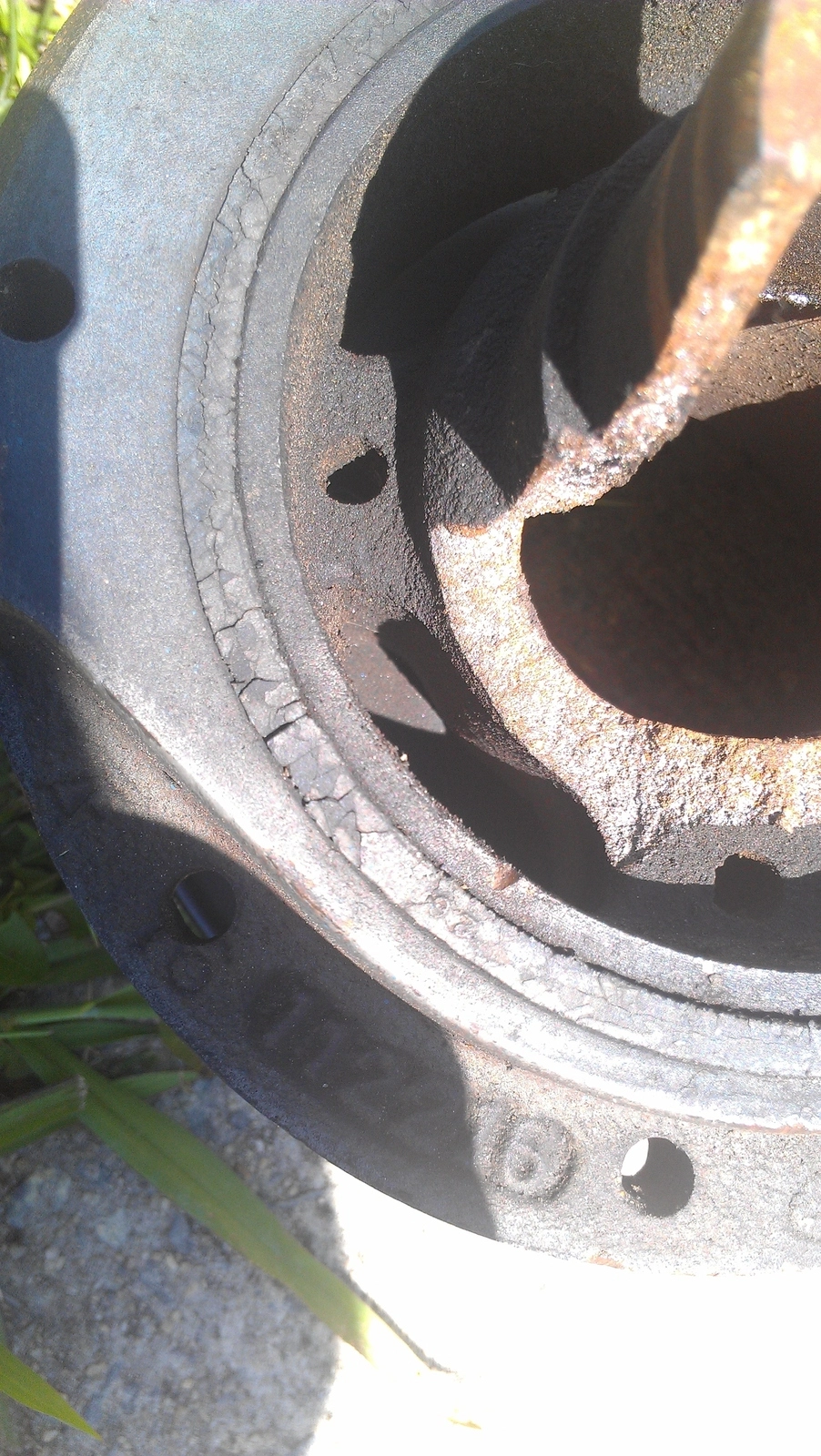

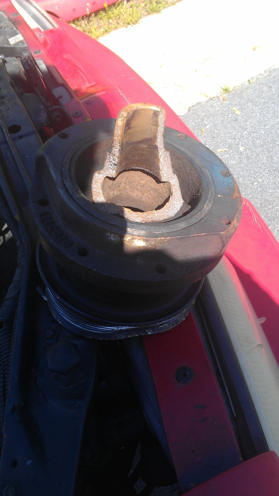

Well i found the old balancer ( Had Thought i threw it away)
