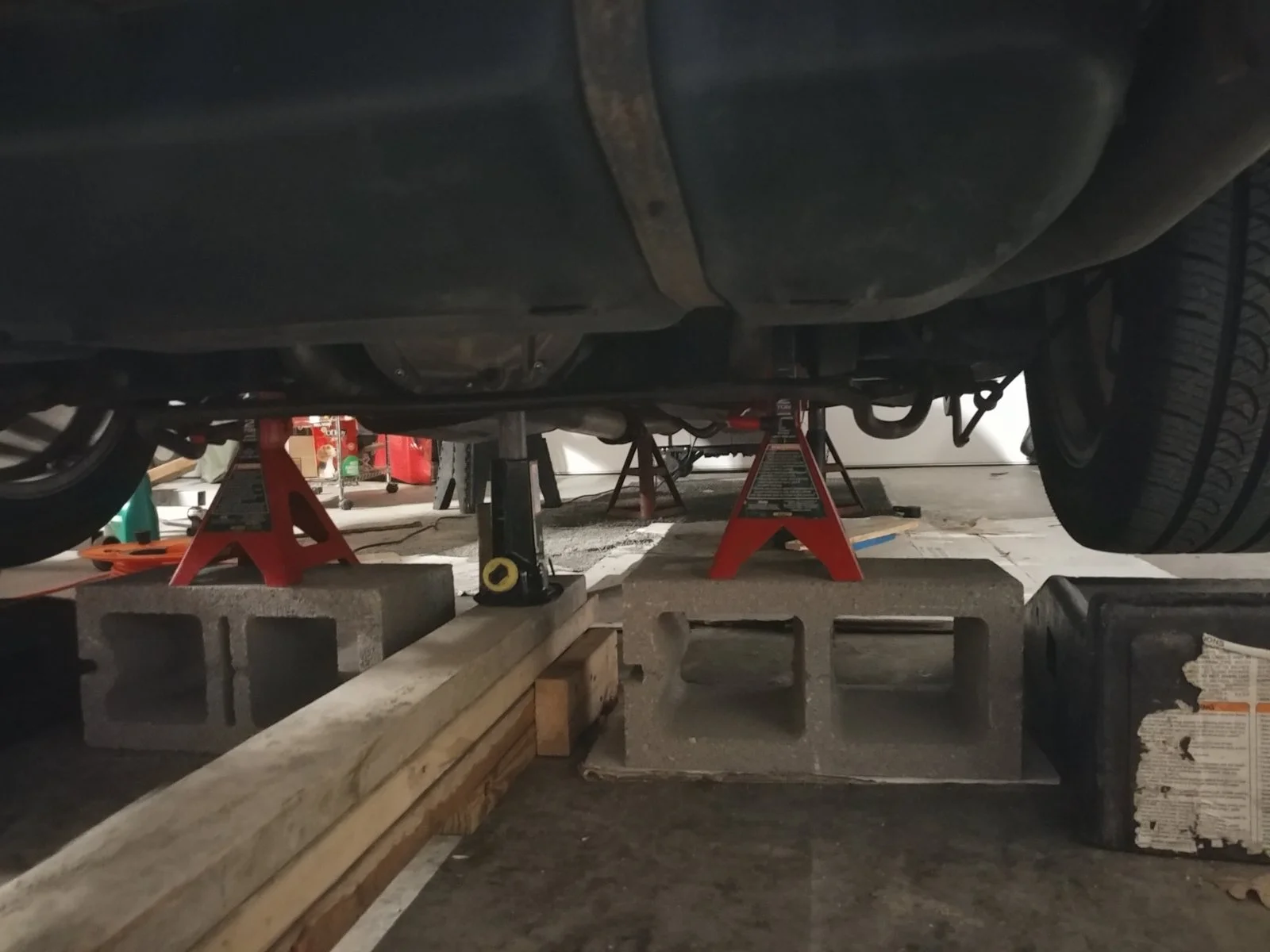

Brings up a good point, Where to support the car is probably the most important thing in any of our builds. If not supported correctly, we can do more harm than good in the end, to the vehicle or ourselves. This Picture is NOT what the "OP" was asking about but will serve to get my point across. As you can see the car at this point was on 4 Jack Stands but prior was on 2 in the front and ramps in the rear. It was supported properly. Then I had to get the rear end higher and posed a problem. Since the rear was on ramps and I needed the pumpkin elevated, I needed to fine out how to get this up.
1. The first idea was to simply use a floor jack to do this and then support it properly. That wouldn't work because as we all know a floor jack will roll the car to the direction the fulcrum takes it. So Since I could not do that with the front on jack stands and no wheels, I needed a better solution.
2. The next idea was to use an old bottle jack and to straight up. Mind you this was a jack that I planned to be rid of since I never had a use for it before. Gladly I didn't do that. So, in the picture you can see that I used a few pieces of wood for spacers and slowly rose the car to a desired height.
----- In this, I had the choices of where to stabilize it.
----- 1. On the Pinch Rail
----- 2. On the Axle
----- 3. On the Pumpkin
I was going to use the pinch rail, but in that I figured I would lose room to move under the car because I was using the cinder block and jack stand combo, plus my reason to lift was to get clearance to remove the 4 12pt 12mm bolts on the drive shaft.
I chose the route that you see here. Cinder block under the jack stand and then lowered the bottle jack so it isn't touching. (The Jack Stands are on the Axle)

Cinder blocks are a bad idea under cars. I've done it too, I'll admit, but I've not only heard/read about them crumbling without warning, it happened to me once. Luckily I wasn't under that car when it happened.
