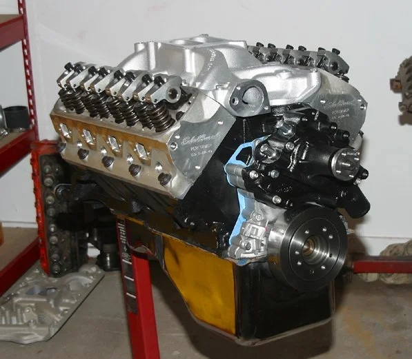

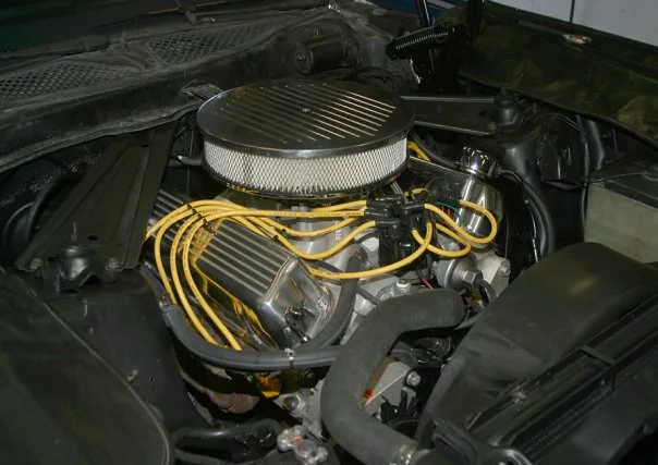

Which One for My New 351W?
I just got my new 351W in my '72 Mustang. It's a pretty mild, flat tappet build. It's bolted up to the old exhaust manifolds right now, but I'm planning on getting some Hedman headers next. What do you all think about the 2 1/4" Motive Industries vs. 2 1/2" Pypes exhaust?

Nice! I put a 400+ horsepower 351w into ,my 72 fastback with a 4spd. Try headaders seems to work pretty good but haven't done a really nice exhaust yet. Even without knowing your whole combo I know that car will haul a**. Let me know what you use for headers and exhaust. Good luck and keep us 71- 73 guys posted.

your motor looks anything but mild to me! Alum heads are nice!
