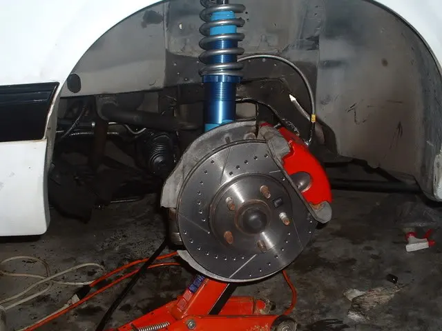

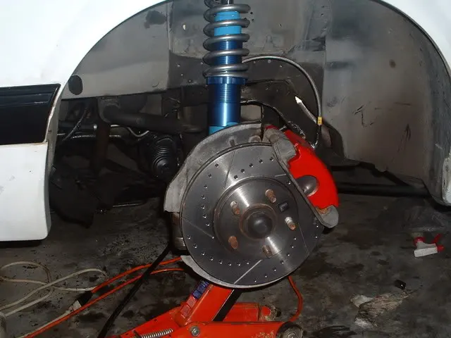

Heres mine...98 front spindles,calipers,and rotor. I also use the stock master cylinder. A friend of mine has the same front plus 96 rear with disk brakes and he runs a stock mc. I can tell you that its has a heavy feel. The stock mc will work,but you can always change over to a SVO , 93 Cobra,or any 95 and up.
Kelly
