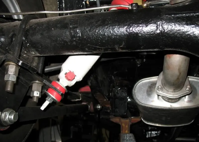

When I started to drag race, I switched to Rancho adjustable shocks--RS99204. About $100 each. These are spec'ed for a Nissan truck, but work great on the Mustang and are a popular Mustang swap. I like them because I can dial my ride soft or hard with just the turn of a knob. Oh yes, I do run this car on the street too (on rural farm roads.)
If you really want a better shock than that, the QA1's will fit your bill, but you will be out somewhere around $200 per shock.
