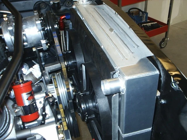

I bought a nothern and got a custom bracket built by Vintage Mustangs here in California. The whole install came out pretty neat... Also got the radiator from them also. Here is a picture of the install of this type of radiator.

Which one is the picture you posted?
