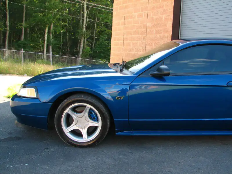

dont they look purdy?
i thought i had a close up pic of these
thanks...i cant remember what brand it was...maybe duplicolor, but its actually spray on high heat engine paint.. it was the only color i could find that was close to atlantic blue...i think the only reason i didnt go with actual caliper paint was because they only had red, silver and i think yellow at the time i went to the parts store

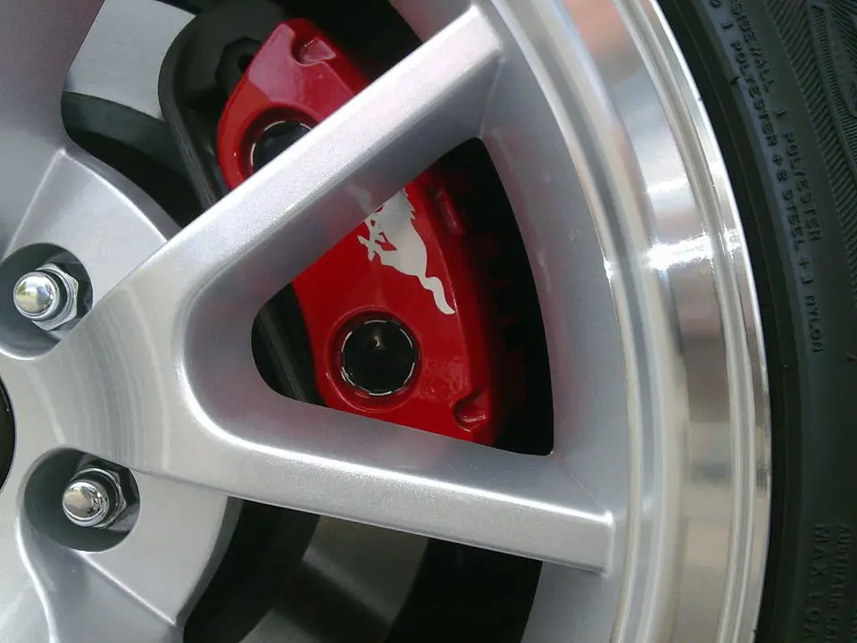

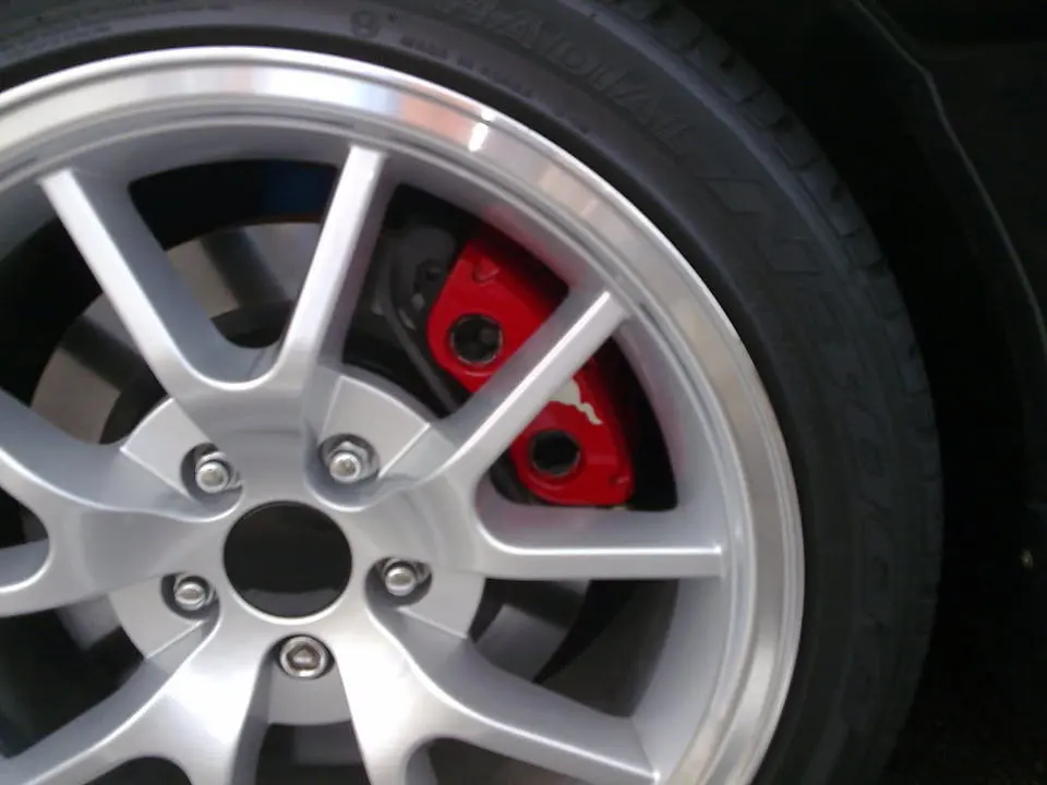

Here's a couple pics of the Mach 1/Bullitt kit.
