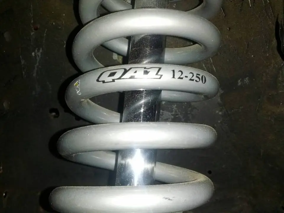

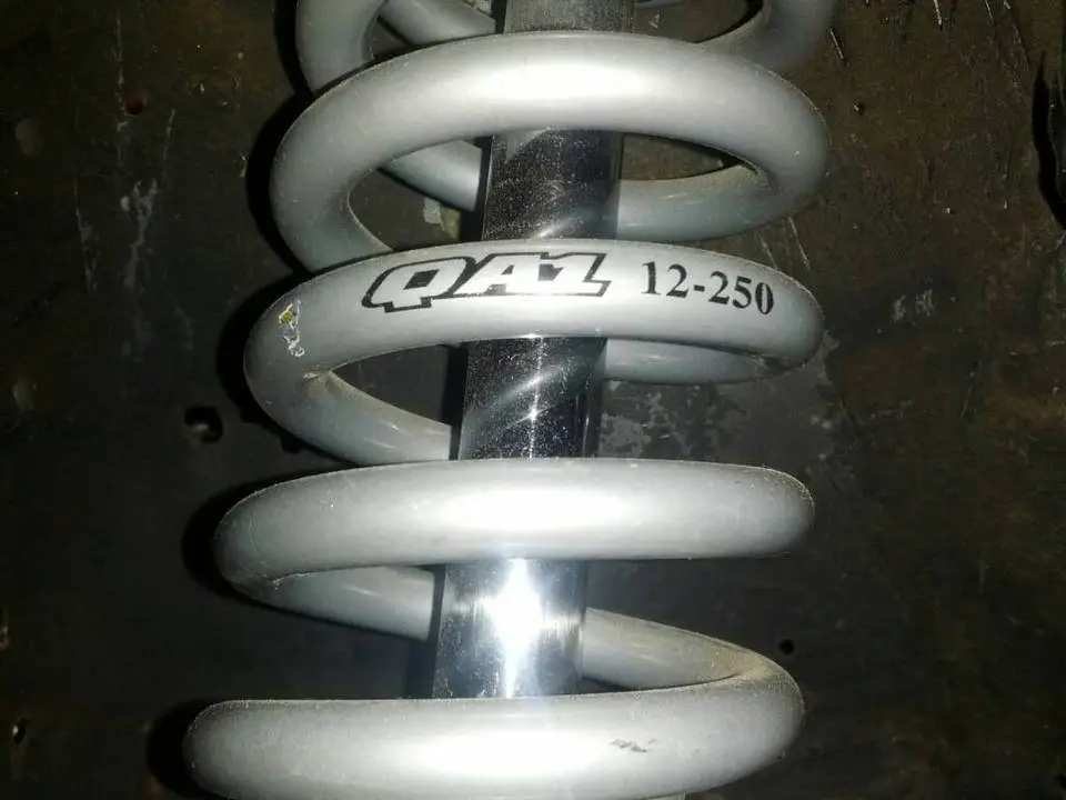

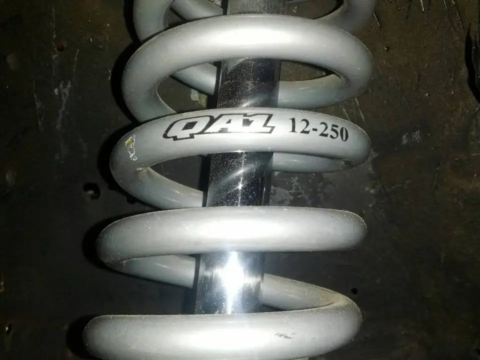

id go right to coilovers. upr addon kit is nice for the price. 12" 250# springs and all the adjustability you'll ever need. buy once and be done

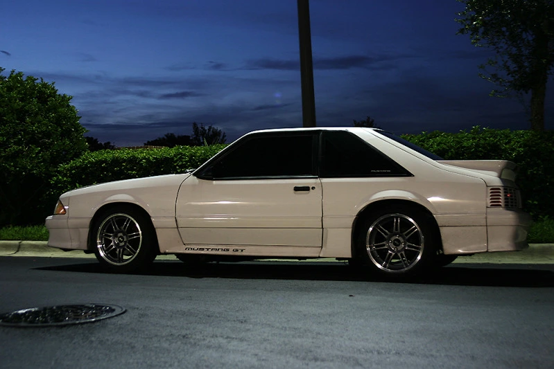

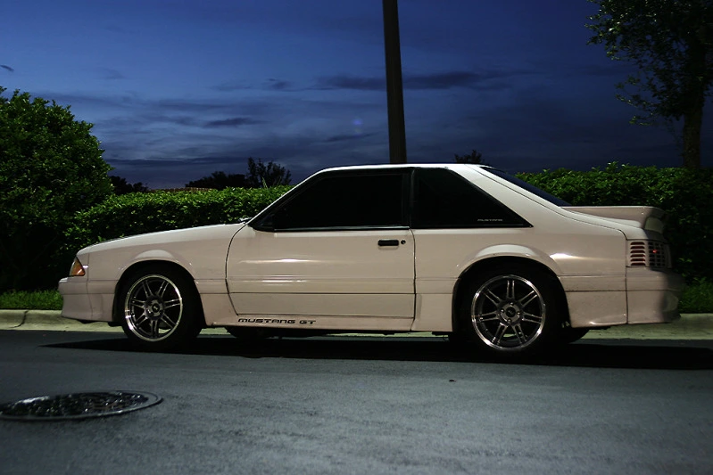

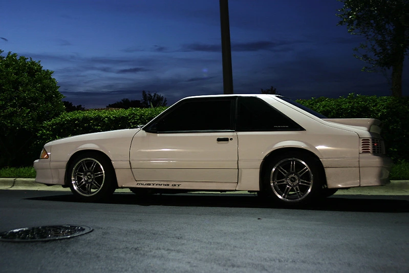

I wouldnt really call coilovers a budget setup lol, I spent $1000 on mine and that was supposed to be a "budget setup". I'd just get some decent replacement shocks and struts if its just a street/weekend cruiser, and I like Eibach springs but really everyone is just going to tell you what they used. I would look for different pictures of springs and find a height you like, then just search for reviews on ride quality, The Eibach Prokit gave my car a nice stance, and the ride quality was really good. Wasn't low enough for me though so I went coilovers.
Picture is with Eibach Prokit.
