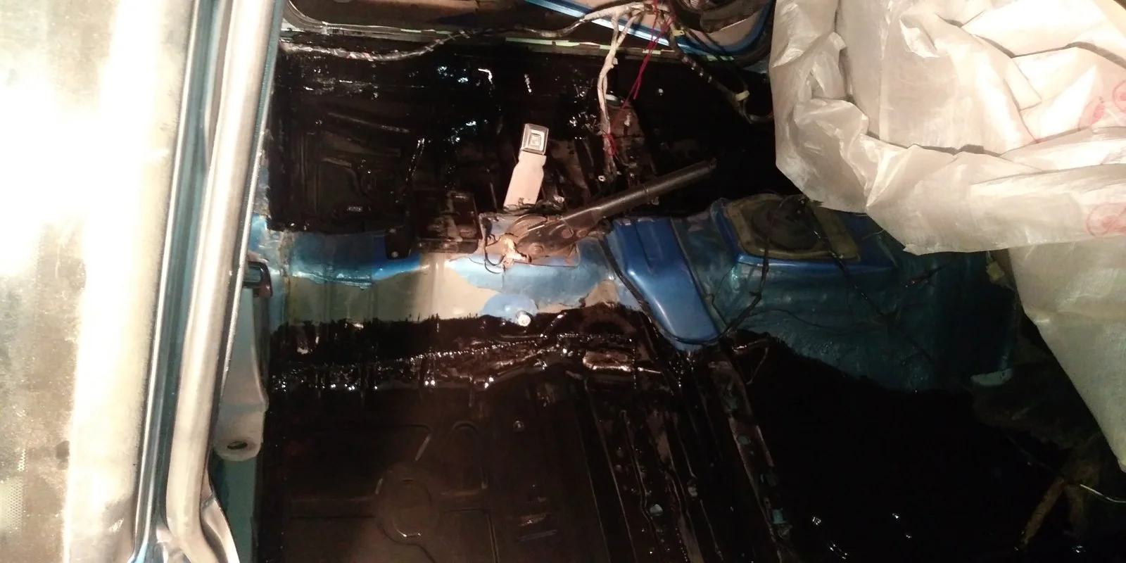

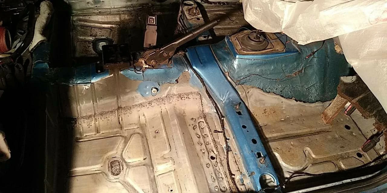

Its so labour intense because it needs clean bare or seasoned metal to properly stick.. It cant go over any other paint or sealer or it will just peel off and if there is any paint under the por15 and theres rust under that paint then u cover it with por15 that spot will rust under the por15 and lift the por15.. Also the metal has to be clean clean clean or the por15 wont stick.. The marine clean has to be used and then washed thoroughly with a hose.. The metal prep is bascially the same. Needs to be applied and the rinsed out thoroughly with the hose. Or the por15 wont stick.. If any marine clean is left behind the por15 wont stick... When i did my floorpans i had barely surface rust on most of my floors. Just the passenger foot part needed to be repaired.. Dont get me wrong por15 seems to be a good product. Just super labour intensive for it to work properly

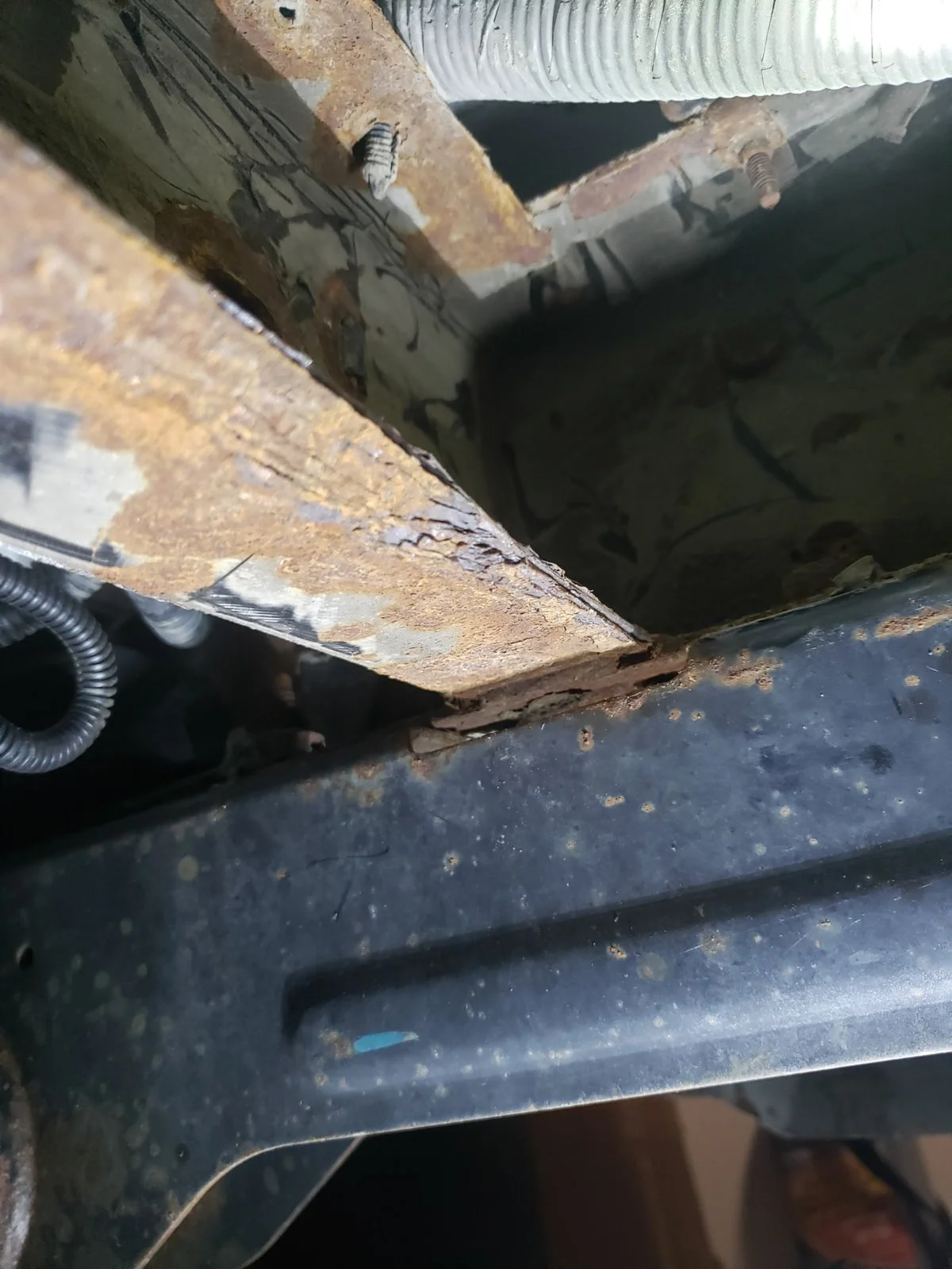

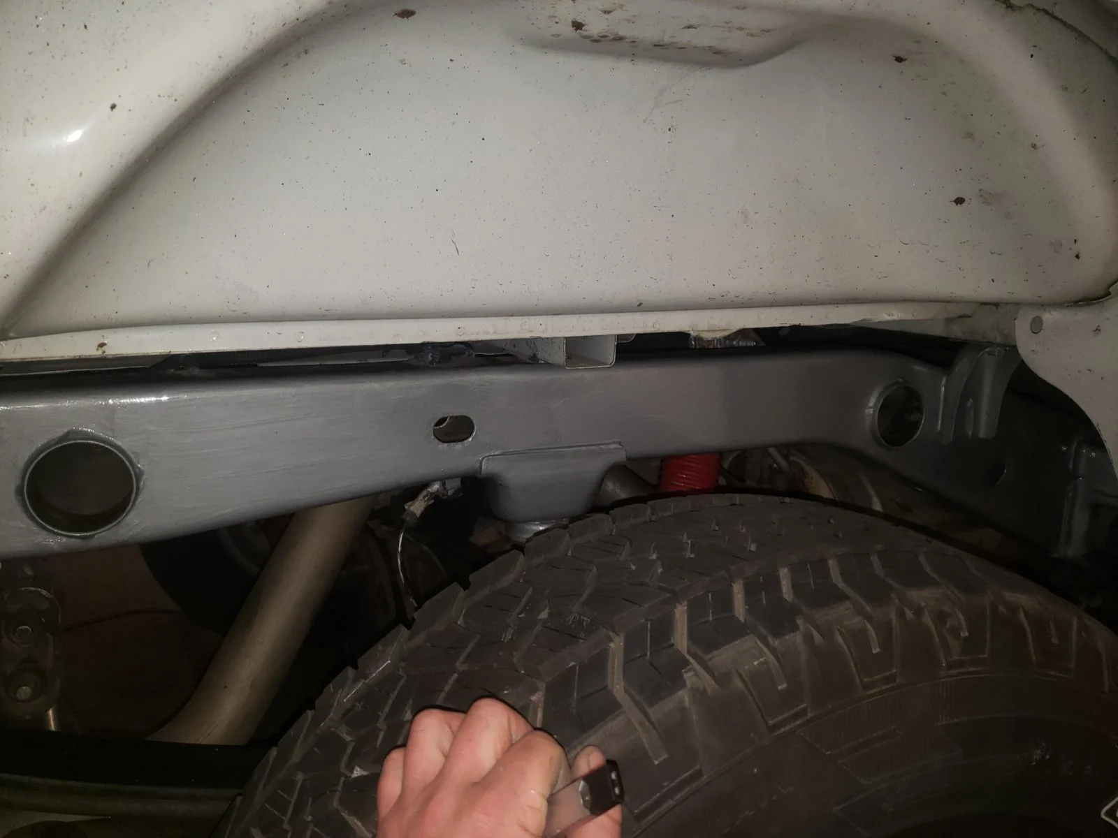

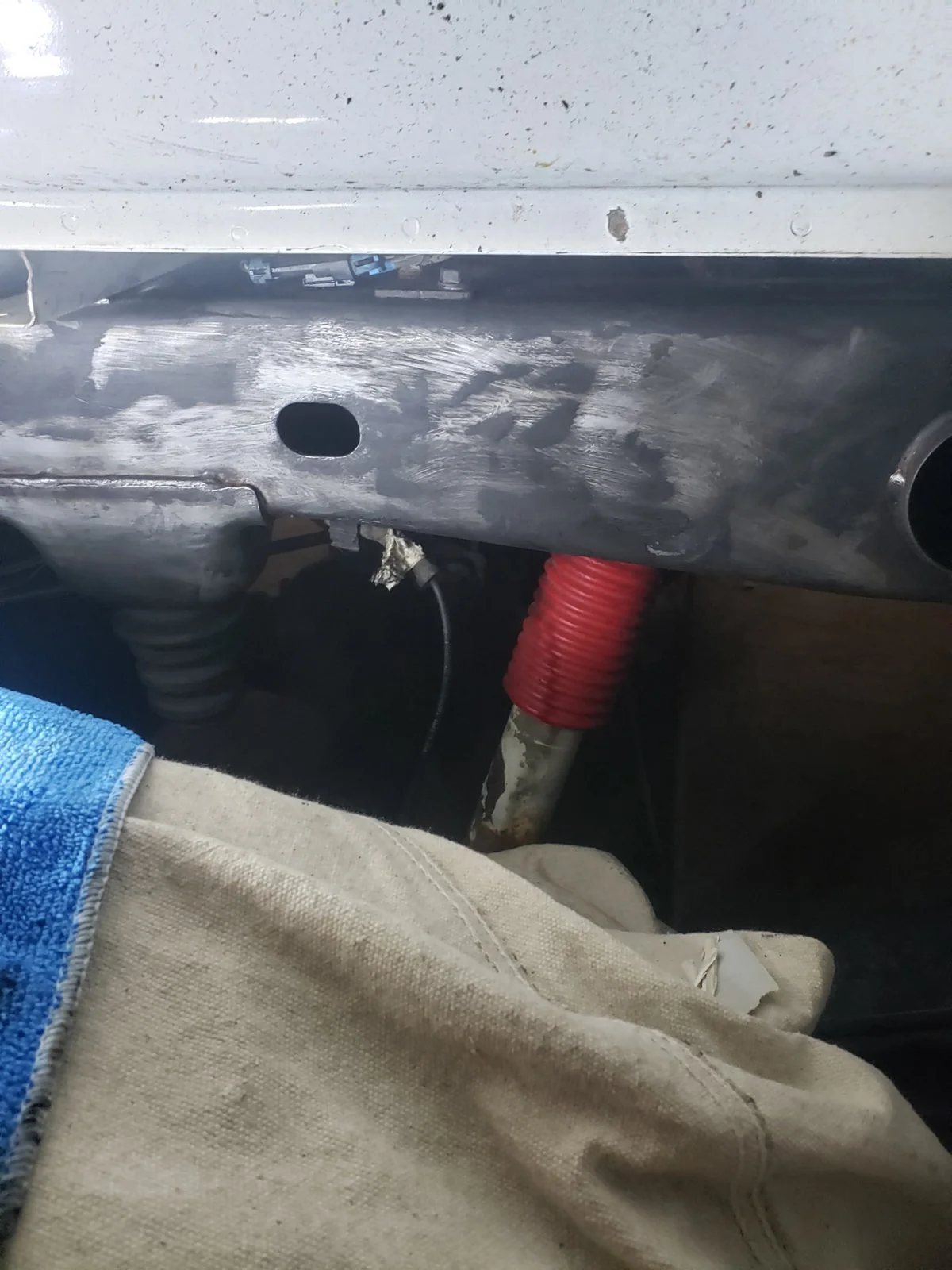

Use Eastwood platinum. Just recently applied it to my truck frame with a good amount of rust and I was impressed with the results. You do have to sand down the areas with heavier rust but not down to bear metal. If the underbody has hardly no rust then all you gotta do is whip area with acetone and paint

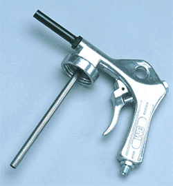

Also available - Schutz guns and soft and semi rigid wands for application in frames and such.
But if you kink the hose it squirts out the air bleed in gun top and right on yr face.
