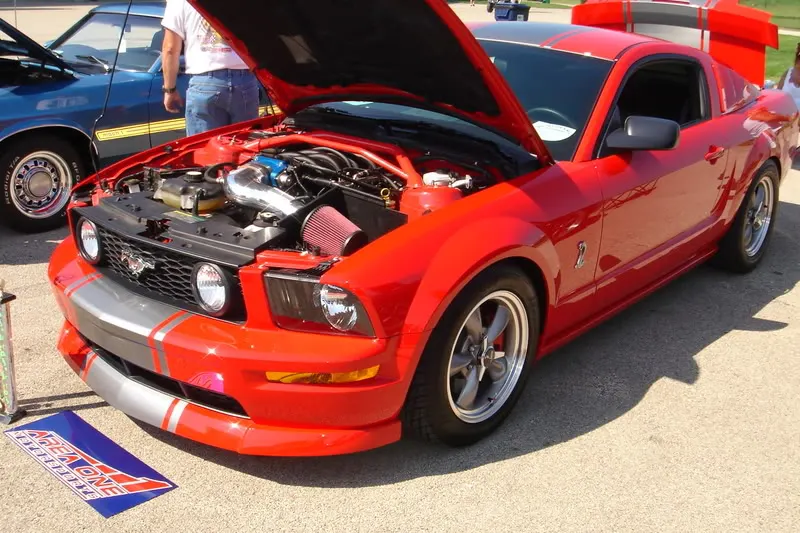

I Love my Granatelli Motor Sports Polished CAI with performance chip tune...
Cobra Badges eh?
