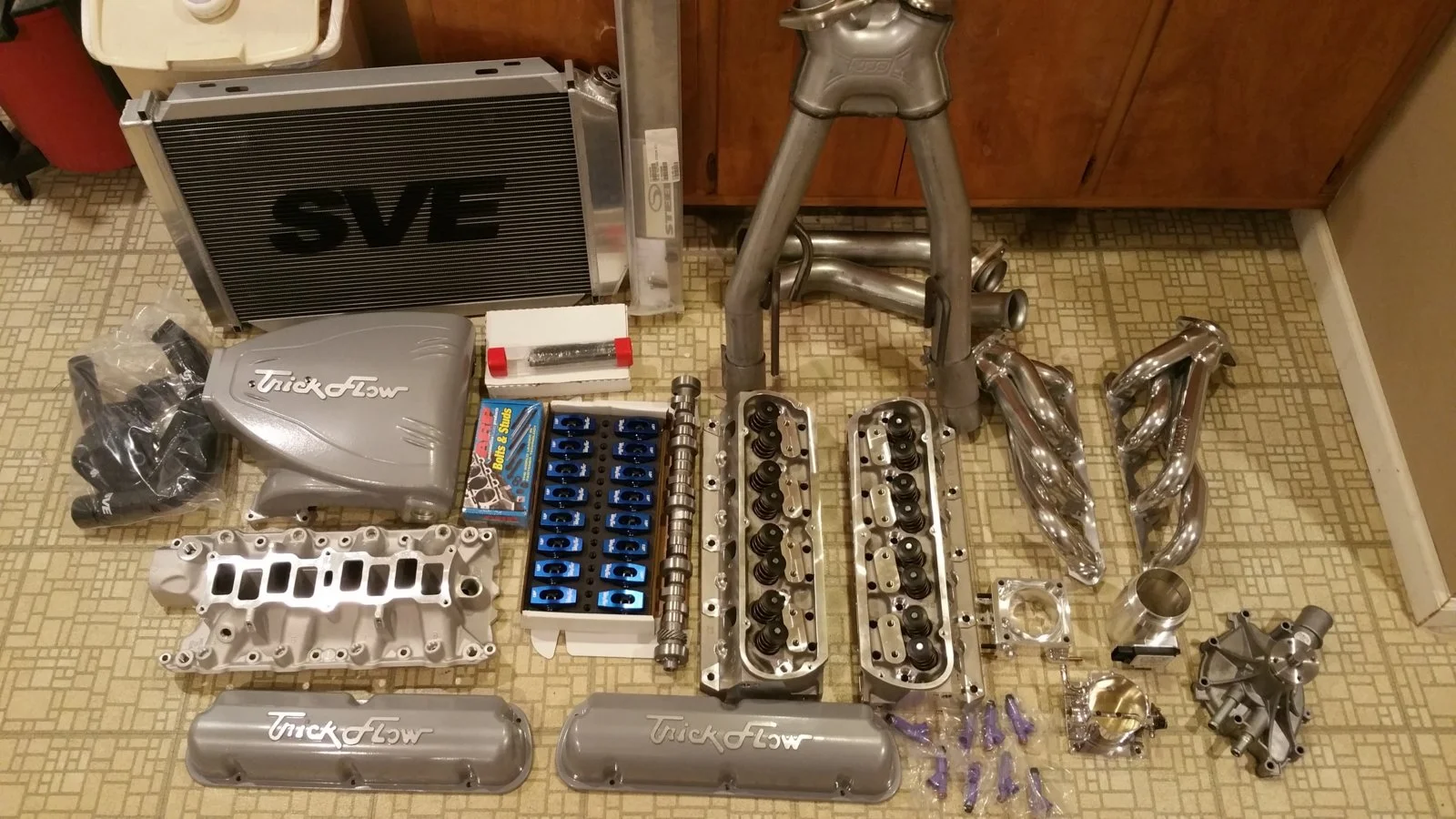

I did the Trick Flow kit for a performance increase and also for it's simplicity,, but unfortunately it didn't end with 2,600 bucks. Bigger throttle body,, Maf, injectors and since it was all apart then came water pump, 3 row radiator, lifters, headers and I'm probably forgetting something, point is once you take them apart it's hard to keep yourself from blowing the budget.

Purchased all of this about two years ago, I didn't necessarily need to replace everything but if it was coming off I was putting new back on. It was just over 4,000 bucks. Btw this was taken in my basement, my wife never would of let me do this in the kitchen haha.
