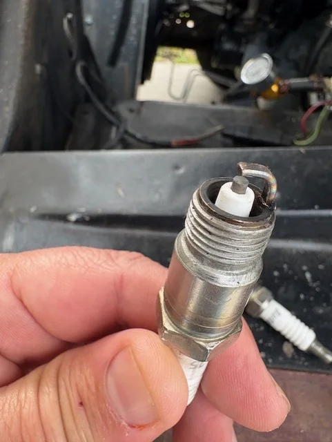

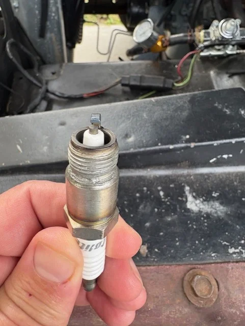

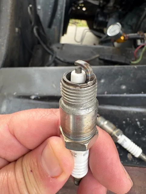

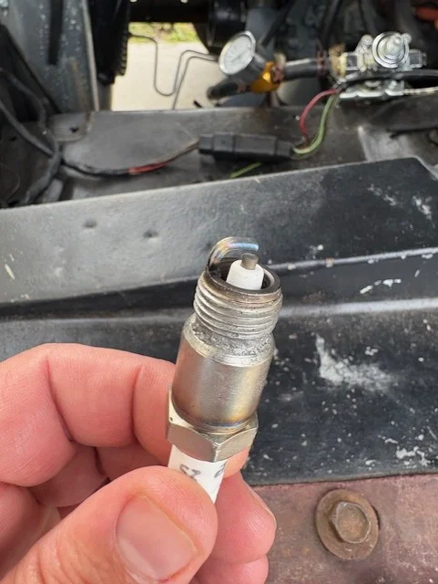

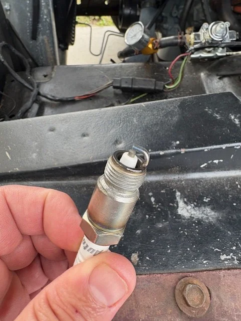

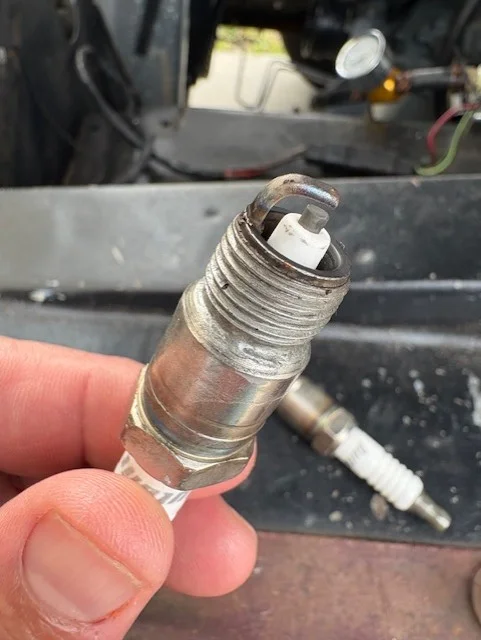

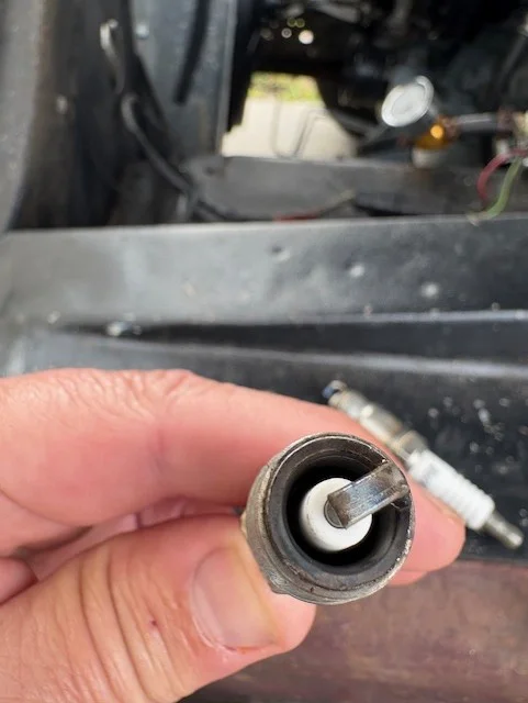

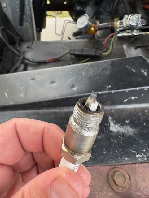

I think I figured out an area where I can do a nice WOT hit and immediately shut it down and pull off to check the plugs....Here is my question:
Is it ok to pull a couple plugs while the engine is that hot or am I risking damaging the threads in the heads?
Ok so I found a spot to do a decent WOT pull from about 25--80ish...These are plugs 1 and 5

Blue strap means to much timing! I would replace plugs (atleast the blued ones) and pull atleast 2 degrees, test again. A carb will be inherently rich, put cats on if you want it to smell better.
Tune for leanest cylinder...
