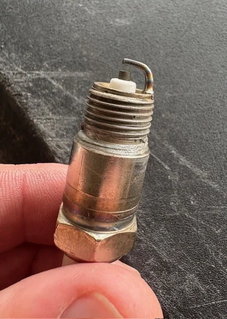

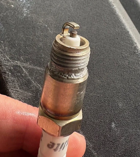

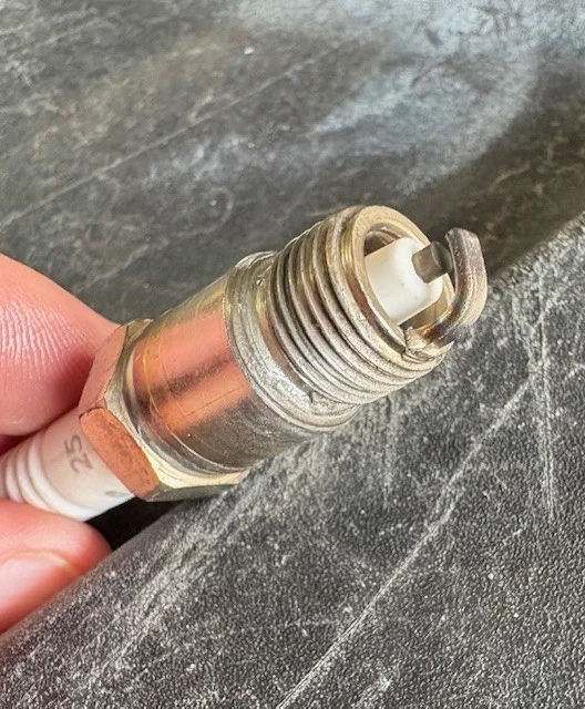

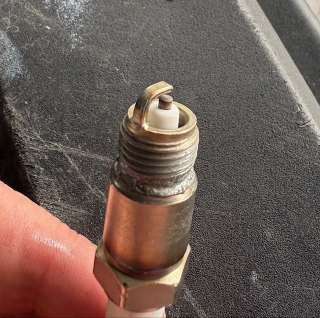

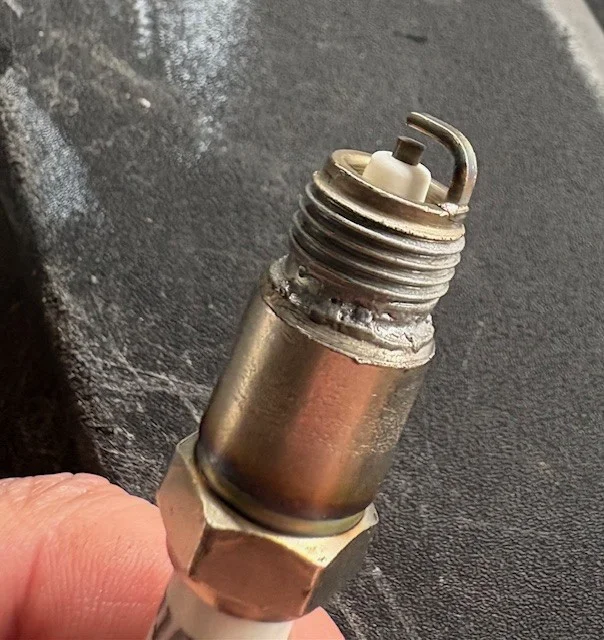

These are the pics of the new plugs A25's gapped at .045..I did some pulls but as I said getting back through my neighborhoof is about a 1/2 mile of idling....I did do a small WOT hit down our street then kille dit but was only a 1st gear hit and not very far....I will say that the engine wasn't quite as "peppy" as before and was backfiring out the exhaust again after the pulls.

Plugs look good with regards to the heat mark on the strap. Gasoline engines tend to have it closer to the threaded body of the spark plug where yours is. As clean as those plugs are it looks like you are running lean to me. I would think that the center electrode porcelain would have a little brown tint to it but yours is white.

Lean to my eye, and I'd take a degree out to try to center the temp band on the corner of the strap. Don't see any detonation there, yet, but that doesn't mean you won't get more in a higher gear.

Actually, I reread what you stated, @forango, and after 1/2 mile idling back, I don't trust the AFR diagnosis. You really need to cut the motor off and pull the plug right away for accuracy. Also, what's up with the popping 'after' the run? Do you mean that you're popping due to going lean on decel? If so, don't do that when plug reading. There's no reason to care what it's doing when the load is that low.

Timing mark getting pretty close to the base of the strap. If your reading plugs for everything shut it off, pull over, swap a few of the old ones in and drive it back. Corners plugs if you don't want to do them all.
