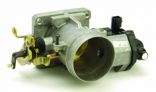

I agree on your gear choice, but disagree on the throttle body specs. Cobra throttle bodies are 65mm, not 60mm.
PN M-9926-B50*
