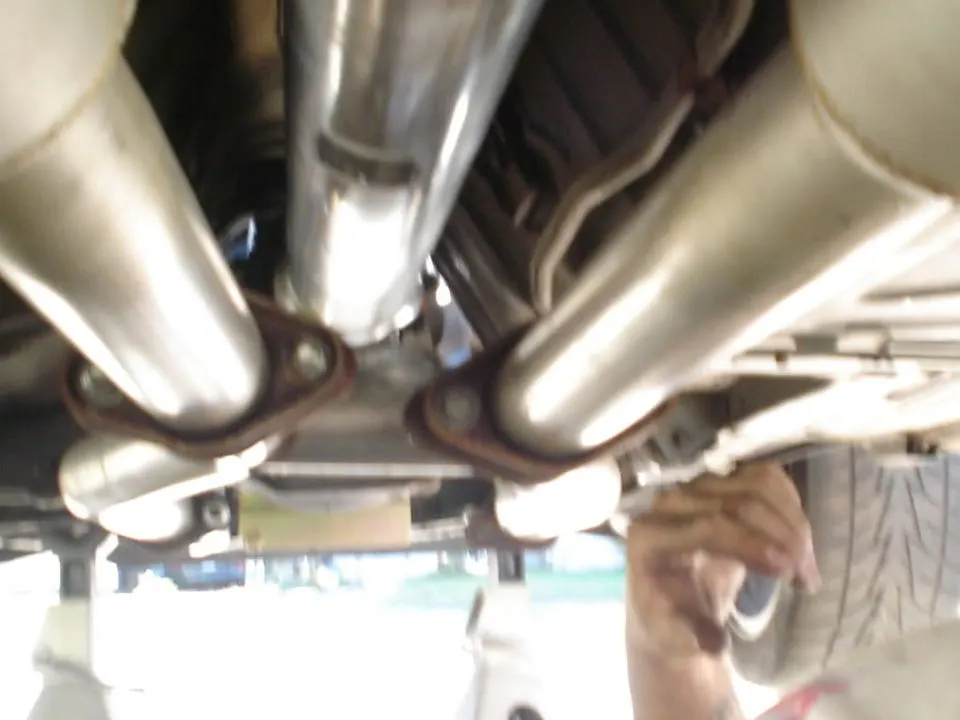

I put my starter in yesterday.lol heres what my bbk long tubes look like,you can barely see them from the side of the car.
