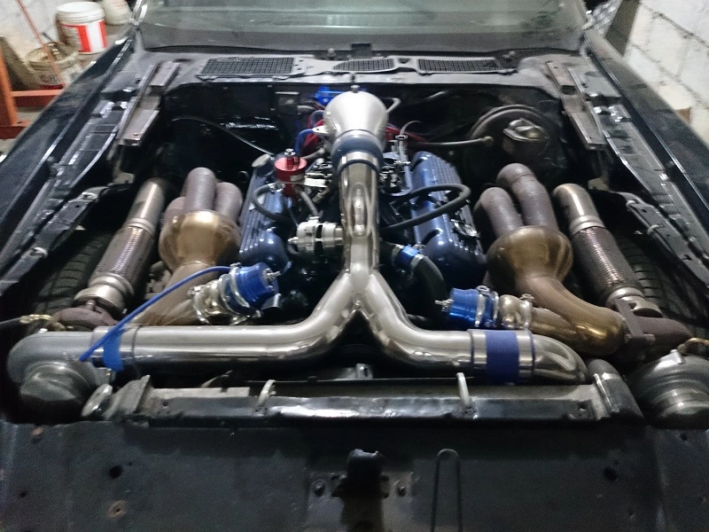

I know another guy, here, local, who used the same G265 I found. He attached it to a twin turbo 8.2 liter GM V8. The tranny shat itself about a month later, at the dyno. The car twisted its driveshaft, diff, and rear subframe apart along with the tranny. Right before it burst, the dynograph indicated 860NM of torque at the WHEELS (600whp/860NM@4600RPM:p). It's obviously not made to handle that kind of abuse.
My entire point was, it is a significantly stronger transmission that a stock/WC/Z T5. I never said it'll handle a highly boosted stroker Windsor motor, I merely said it'll handle a moderately boosted 302.
Here's a picture of the car I spoke of. It's a 1979 Trans AM, 8.2 liter twin turbo marine GM engine (450hp stock/NA), currently running a stock Muncie 4 speed. It's chewed up 2 of those already, by the way. He's running MS1, twin GT 35's, set at 8 psi.
