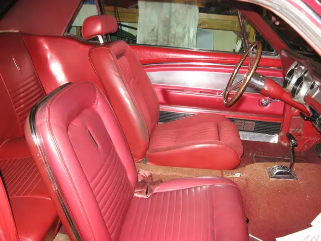

I used a pair of foxbody seats, $60 for the pair and they were red to match my interior. I'll recover them with TMI covers to match the original horizontal stitch when I'm done Classic Automotive Interiors - Restoration and Restyling Products for Classic, Fox Body, and Late Model Mustangs.

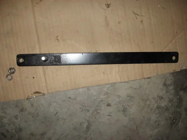

Not a lot of work, drilled the 'feet' off the fox sliders, made a 1" plate steel spacer and mounted in original holes. I don't weld so it was all done with drill, hacksaw, file, gained ~2"+ of slider room as I'm 6'1" and don't use the full extension even. Seats are at the same height as my '67 seats but I now have full recline, headrests, electric lumbar, etc. much more comfortable and supportive. The electric seats usually have the motor underneath which causes clearance issues and pushes you closer to the wheel at your thighs and your head to the ceiling.
Adapter/spacer 1" X 1/4" bar

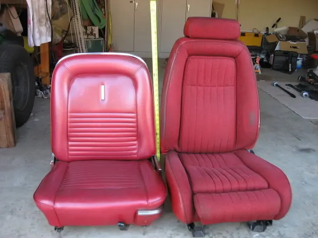

I'd start by measuring the width of the seat tracks/mount and the distance between the mounting bolts front to rear to get as close as you can to stock, you will probably have to make some adapter brackets either way but if one of the 2 measurements line up it's a lot easier to start with. Also measure the seat bottom width, has to fit between the door jamb lip and trans. tunnel, I've read posts where guys bought seats and couldn't get them to fit due to hip width of the seat bottom.
Also measure from the bottom of the track to the top of the seat bottom (where your knees and butt will go) to make sure they're not too high in the base area. Some installed newer mustang seats and they put them into the roof as the base was more raised. You can see in my 2nd pic that the seat bottom height is almost identical, my height in the car didn't change, knees didn't get any closer to the wheel.

Jon's got good advice and his late model seats look like they were made for his '67.
