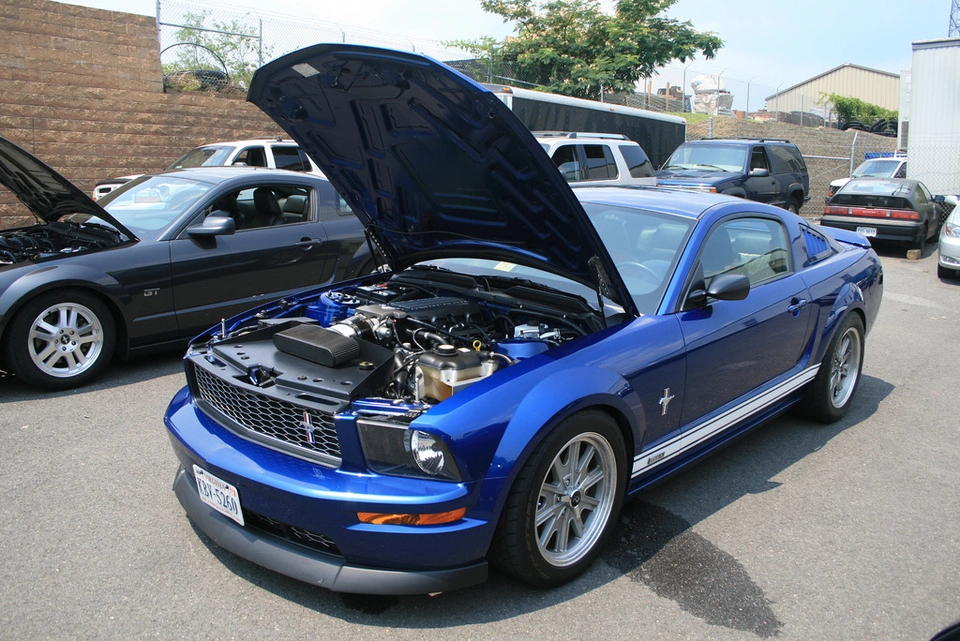

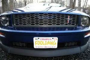

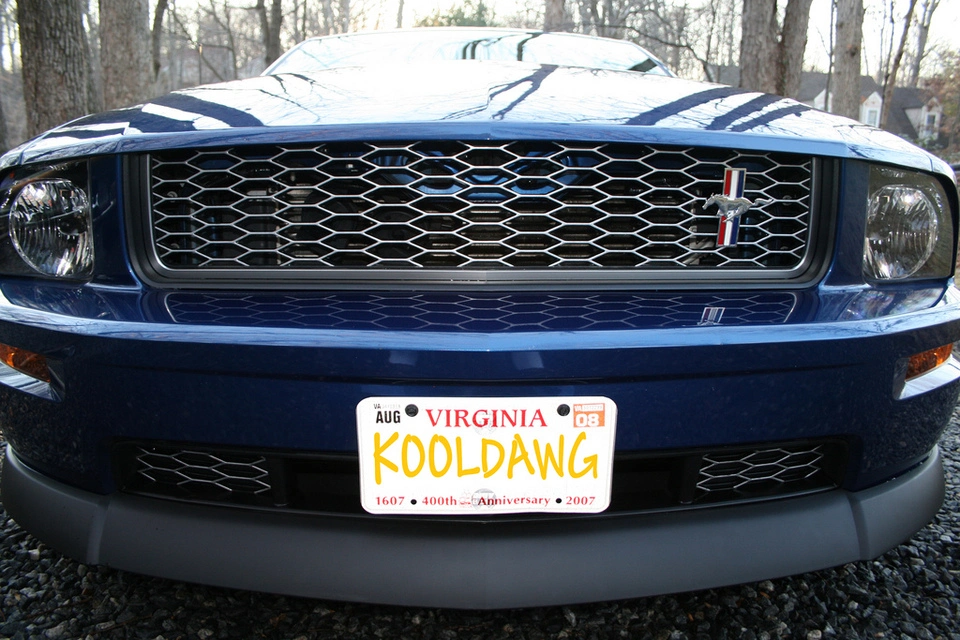

I do have the WMS intake and the ram air tray. It is their 80mm MAF so no retune was required, but I got a tuner anyway to get the many added benefits! Next year, when I get the LTs and cams, I will be stepping up to their 95mm MAF. Instead of a ram air hood, I got the Bullitt grill and cut out all the holes for increasing the air flow. This should really help as it also eliminates the fog lights which block two of the three intake holes on the ram air tray.
