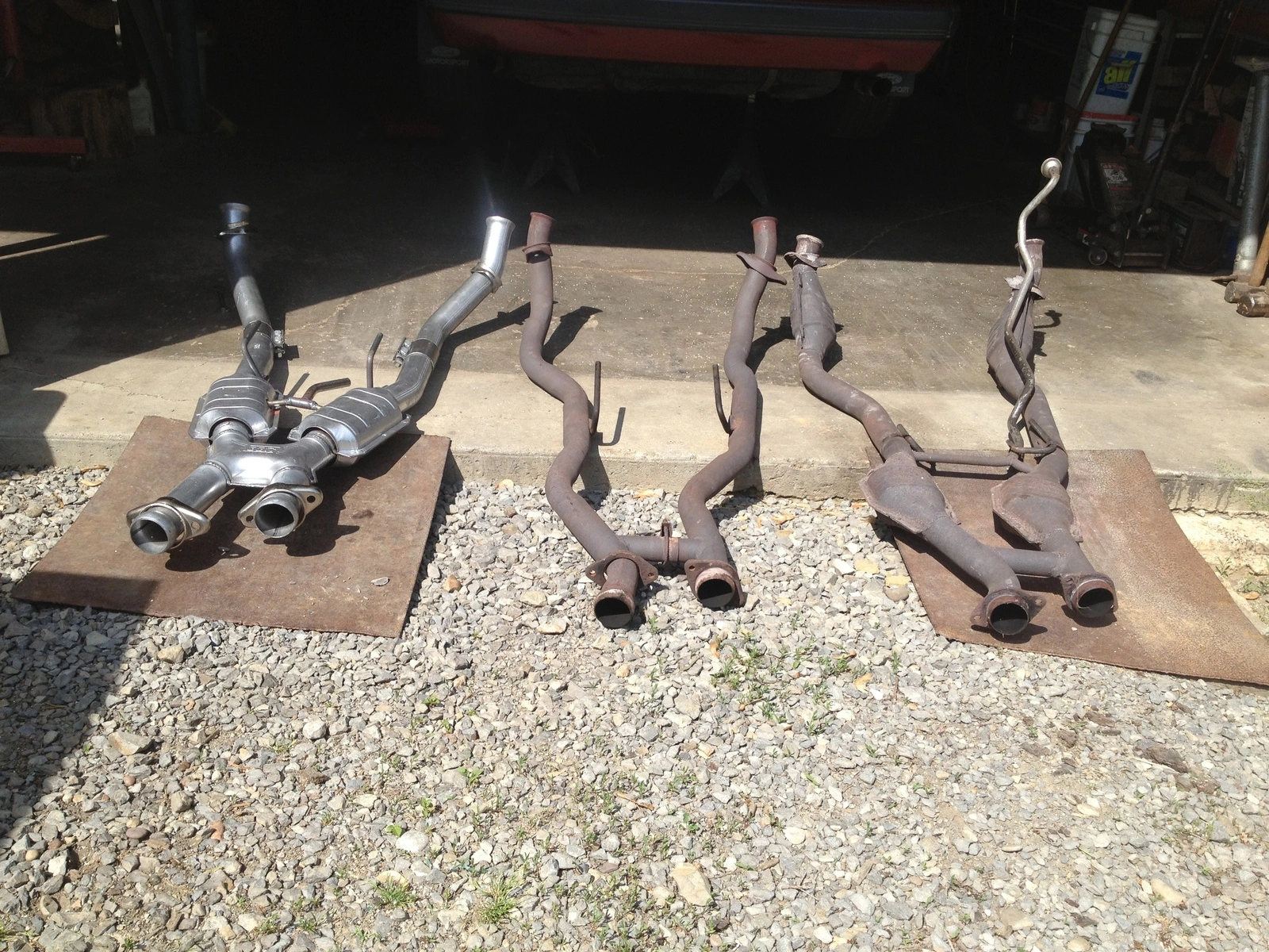

If you do go with a x or h pipe without cats keep your cats you might need them to pass state inspection. I just put on a bbk x-pipe with cats at the beginning of the summer. It sounds great when you get on it. Its expensive but I got tired of putting my stock 4 cat h-pipe on for a week every year for inspection. Here's a pic of bbk x, h-pipe, and stock 4 cat. your rattle could be he heat shields on the cats, I cut mine off when they started ratting
