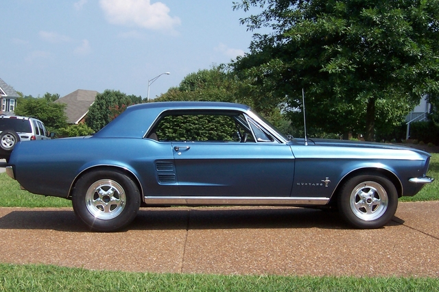

This was with Grab a Trac 560's. I liked the way it looked like this. The original 6 cyl spring lowered it about 1.5"-2". Doesn't Summit carry Moog?
