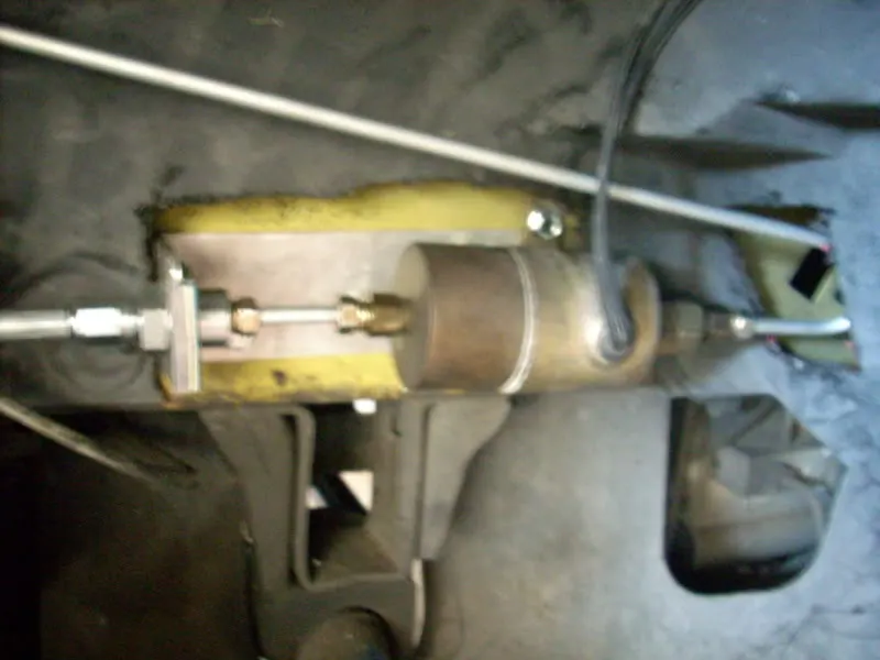

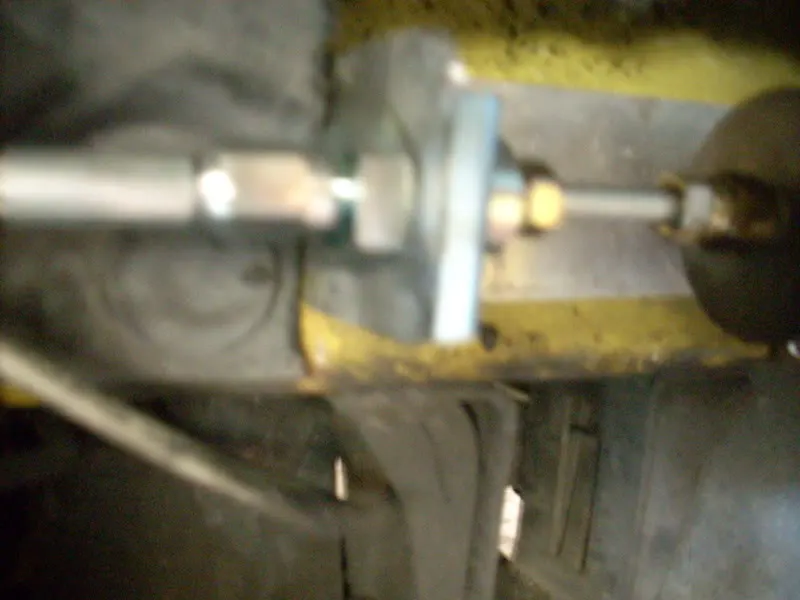

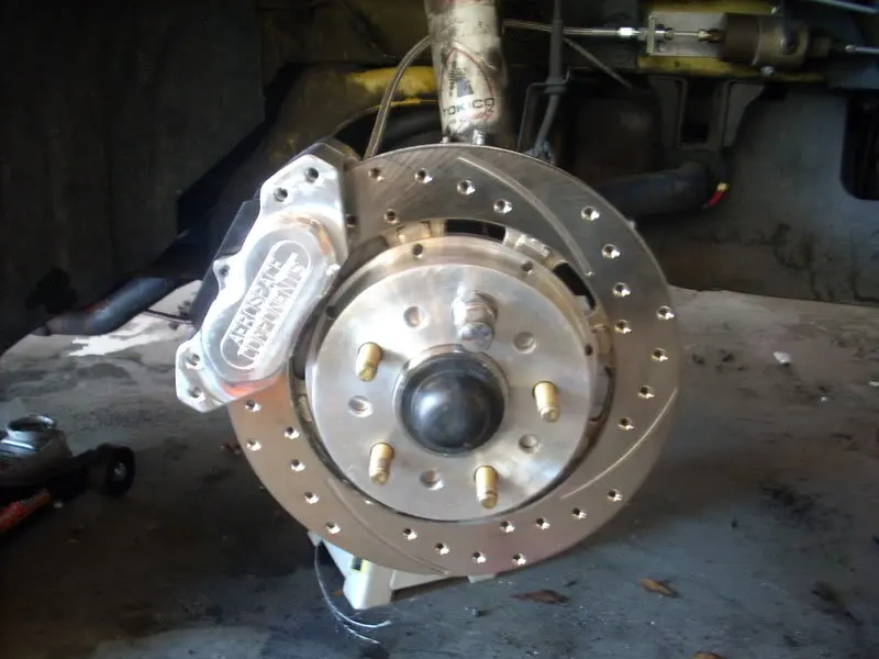

revhead347 Apparently my ex-husband made that mistake. 20+ Year Stangneter Jun 14, 2004 9,303 1,649 214 Acworth, GA Nov 1, 2008 #2 Nov 1, 2008 #2 I mounted one on each side of the car right before the brake use. I used the generic Summit line locks. At the time they were like $40/piece, and they work fine. Kurt Attachments DSCN0219.webp 24.1 KB · Views: 232 DSCN0216.webp 30.1 KB · Views: 201 DSCN0220.webp 23.8 KB · Views: 210
