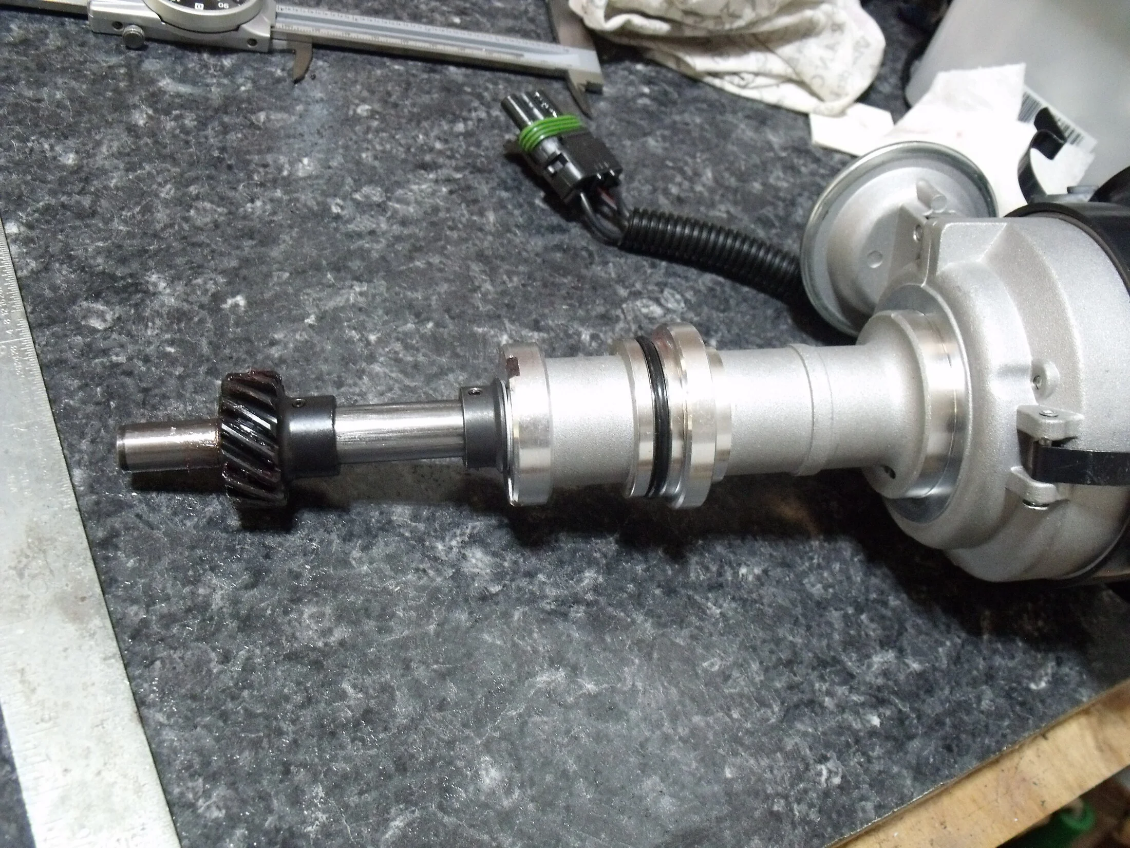

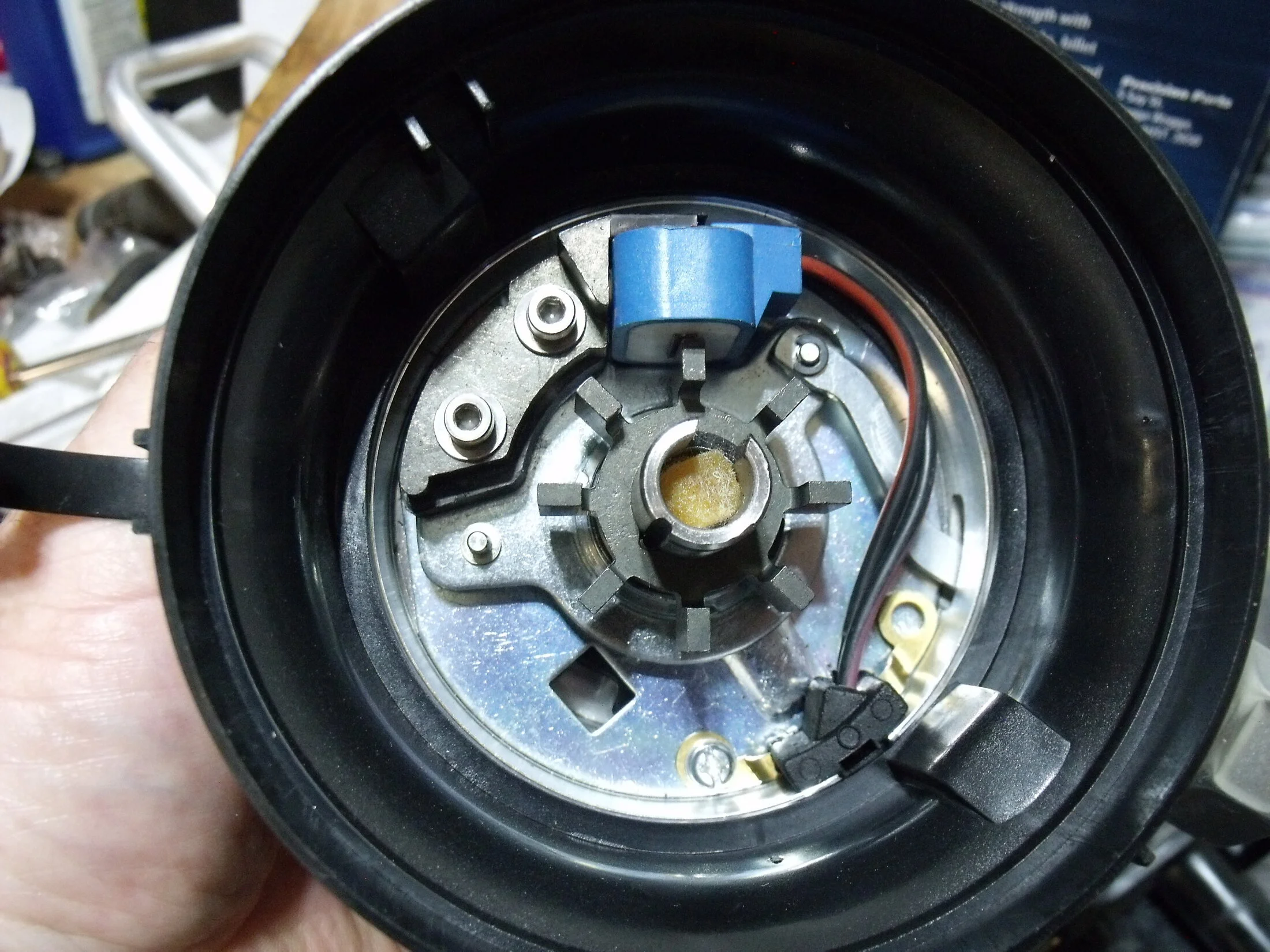

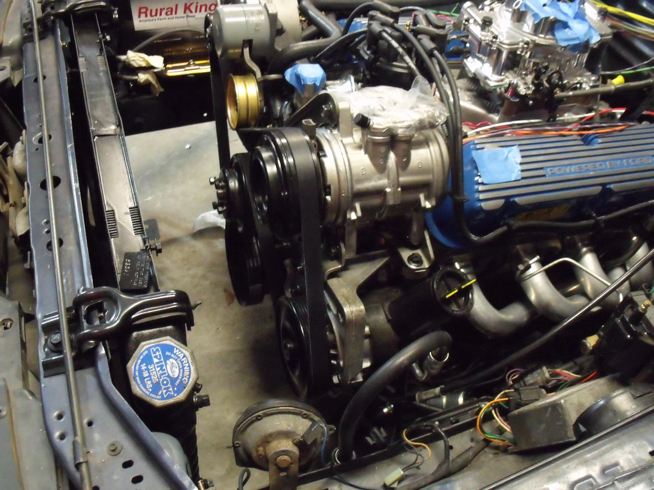

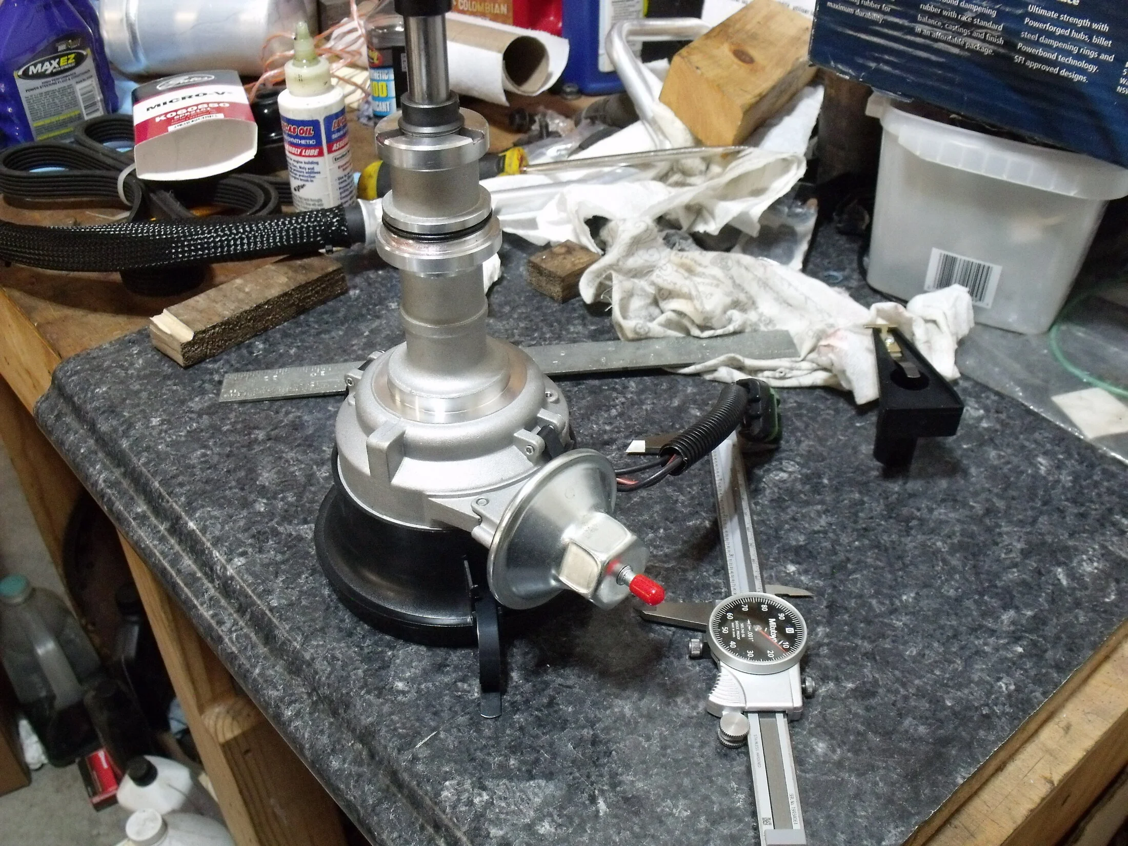

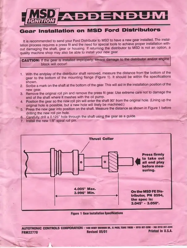

all over MSD but I run one in my T-Bird with the 351W and a 6AL with zero issues. Its not cheap so be forewarned.
