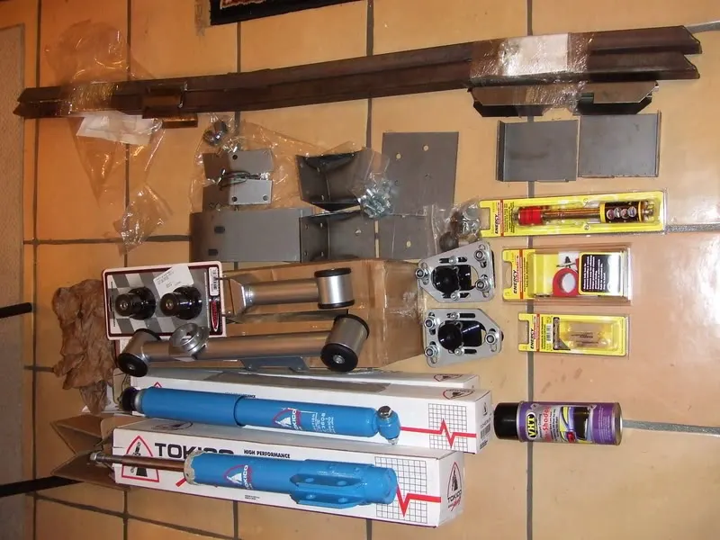

i just got all this:
plus some KYB quad shocks and maxspeed lowering springs. here's what i paid:
Tokico HP shocks and struts: $230 shipped
KYB quad shocks: ~$90 shipped
UPR upper and lower control arms: $160 + shipping
Prothane axle bushings for UCA's: $30 shipped
UPR full length subframe connectors: $90.99 + shipping
torque box reinforcements: ~$50 shipped
maxspeed lowering springs: $50 from a local guy
Energy Suspension sway bar endlinks: $15 from Autozone
Energy Suspension sway bar bushings: $20 from Autozone
MAC c/c plates: $120 off ebay like 3 years ago
so minus the MAC c/c plates since i got them so long ago, i just spent ~$735.99 for my new suspension setup. my car is totally street, sees the track MAYBE once a year. just giving you an idea of what you can get
