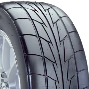

Yep, alot of peeps running around with 8" rims and 275's out back. I plan on getting some Nittos in the next couple of weeks, but mine will be 305/35's for my 18x10's..... :nice:
Interested to see how long they hold up since I rarely put uneccesary miles on the car..... :shrug:
