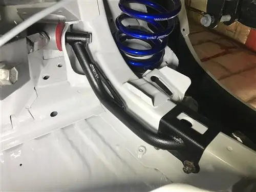

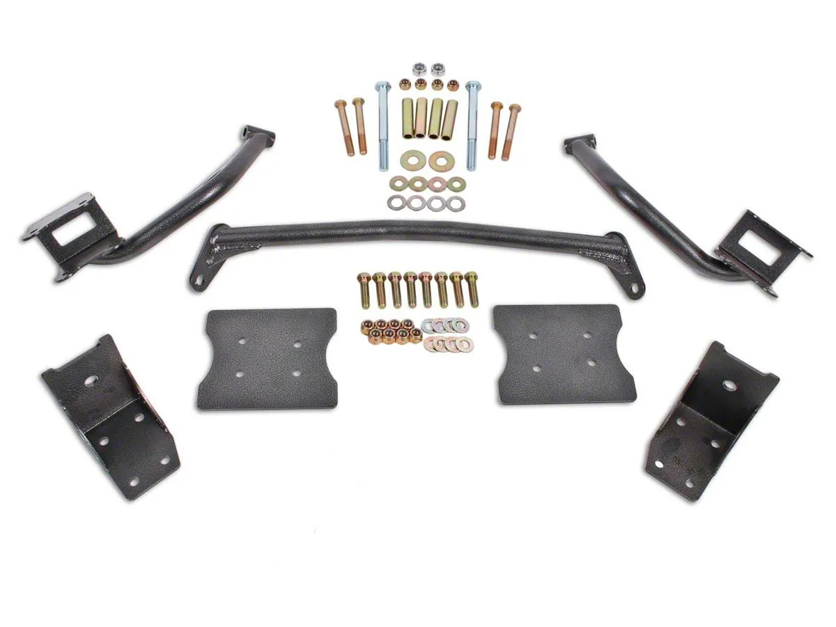

I installed a set of bmr ones yesterday, the style with the tube uppers that tie into the frame. They’re actually really nice, and a little easier than having to drill the uppers through the floor. The lowers are way beefier than ones I’ve installed previously. Very thick gauge steel.

It’s kind of close to the tank, but a good ways away. You just pull the wheel and shock off and have full access to drill the mount.
It tucks really close to the factory frame so exhaust clearance shouldn’t be an issue. Tank stays in place as well for the install. Honestly I think they’re easier to install than the other kinds. Lots of surface area on the lower plates and they’re beefy.

I was impressed with the uppers. After having don 2 sets of the wild rides style uppers and it’s always such a biotch to get the proper drill angle, at least with the drill I have at the shop. A palm drill may work better.
That bmr support bar looks like it would work good. So its 1 long bolt through that and the upper control arm?
I guess time will tell how well they actually stiffen the upper, first impressions are good. Yeah it’s a pretty long ass bolt, like 6in it so. There’s also a cross bar that ties the two upper boxes together.
