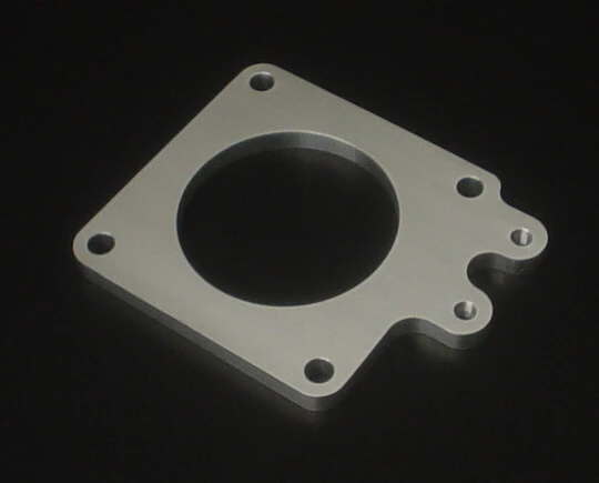

You could use this.
FORD 5.0 EGR ELIMINATOR PLATE
Totally eliminate the EGR on your 5.0 with this billet aluminum plate. Comes in 75MM and may require port matching of your throttle body and upper plenum. Uses stock hardware and gaskets

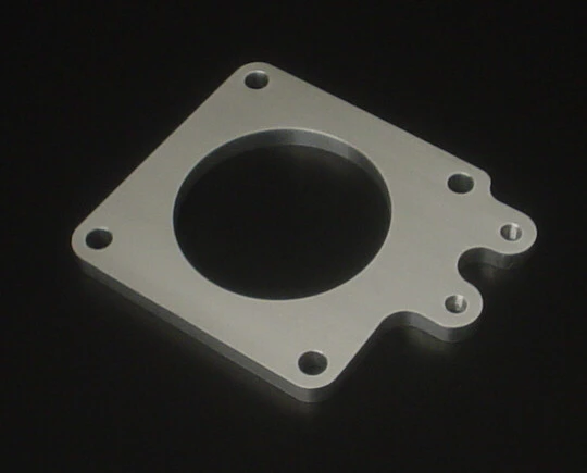

You could use this.
FORD 5.0 EGR BLOCK OFF PLATE
Billet aluminum EGR plate. Easy way to eliminate EGR but retain the factory EGR plate. Uses stock hardware and gaskets.
I would suggest looking here.
http://rjminjectiontech.com/?p=9
Hey 04, thanks for the pics. I was wondering if there is any manufacterer that makes the plate that totally deletes it for the stock throttle body size. And if not is there any other place rather than upr products that makes the small egr delete (one that bolts to factory spacer). Thanks everybody for the variety of options.
