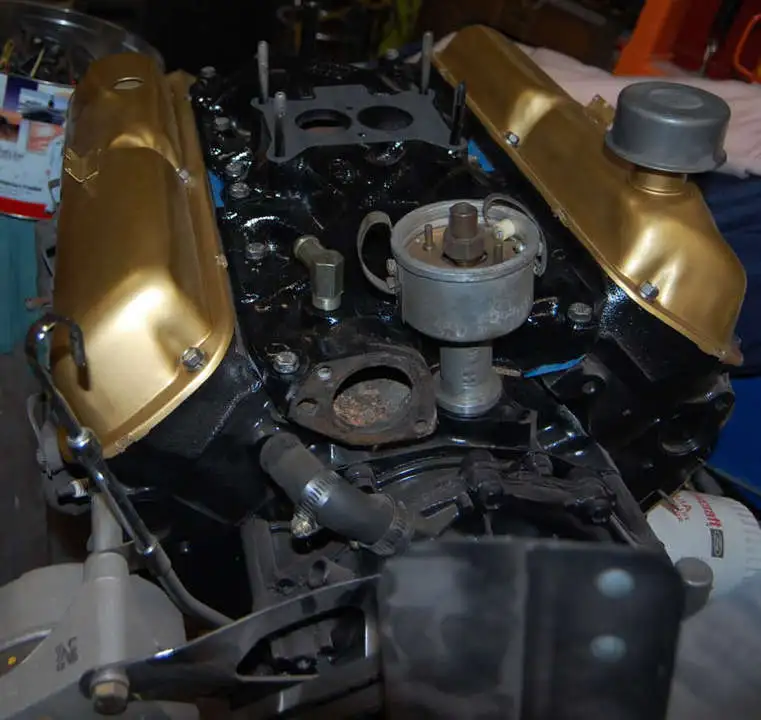

I got a load leveler from Harbor Freight. It already has brackets with bolt holes in them for mounting to the motor. Here's what I have:
The question is, where is the best place to lift the motor? I was thinking the bolt holes on the end of each head would be a good place. Where is the best place to atach the brackets to lift the motor? Here's my engine, a 1965 289 2v:
Thanks,
Steve-o
I have the same leveler and it works great, especially if you are going to go at it alone, as far as where to bolt it down to I would go into the heads on the sides where the alternator and or AC accessories bolt on to, be VERY CAREFUL the chain won't snag your distributor as I see you still have it in, shoot I see you have the alternator still on there, I would remove as many accessories as I could like the alternator and the oil filter anything that could catch on something that way I would have more wiggle room
Yes, I already planned on taking the fan off, but I guess I'll take the alternator and oil filter off too. The chrome alternator brackets have to go anyway.
I may as well pull the pulleys off too. I want to change to pulleys to single groove since I'm not putting A/C or Power Steering on the car for now.
And the dizzy is just filling the hole, that's not the dizzy I'm going to use. So that can come off too.

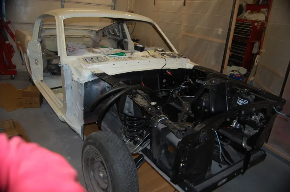

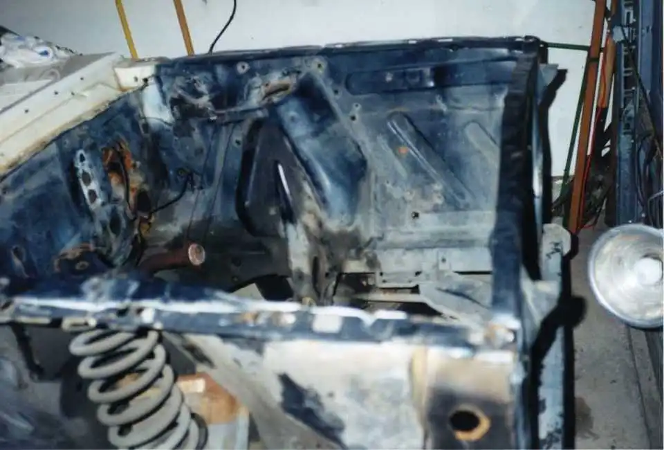

Here's a "before" pic:
Here's an "after" pic:

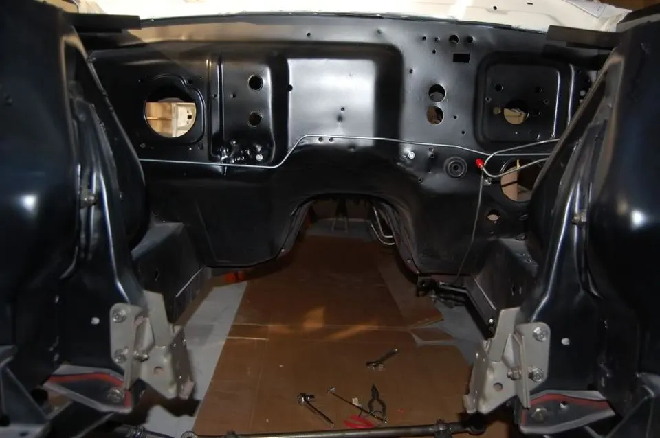

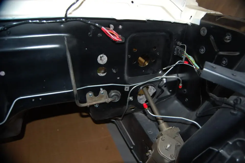

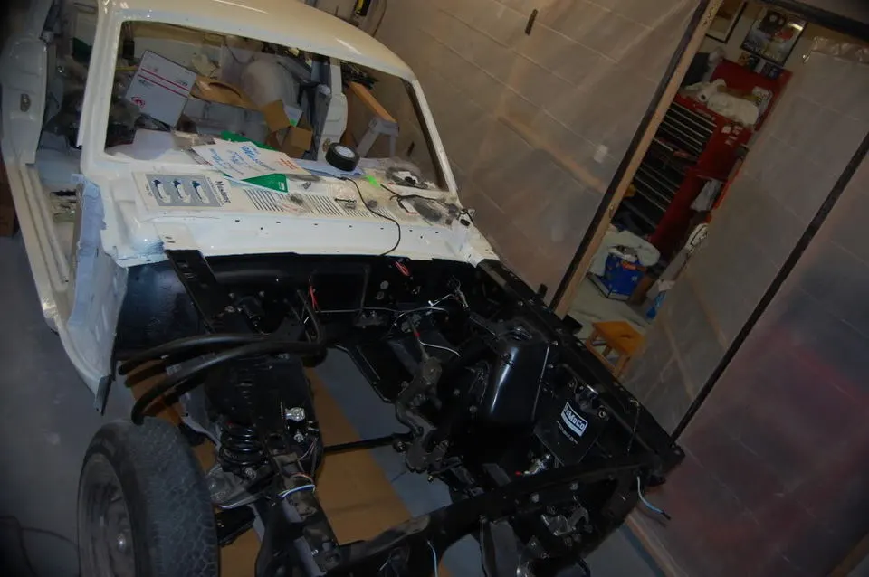

Yes, here is my engine compartment today. I still have to put the master cylinder, distribution block and proportioning valve in and then hook all the brake lines together.
Thanks,
Steve-o
