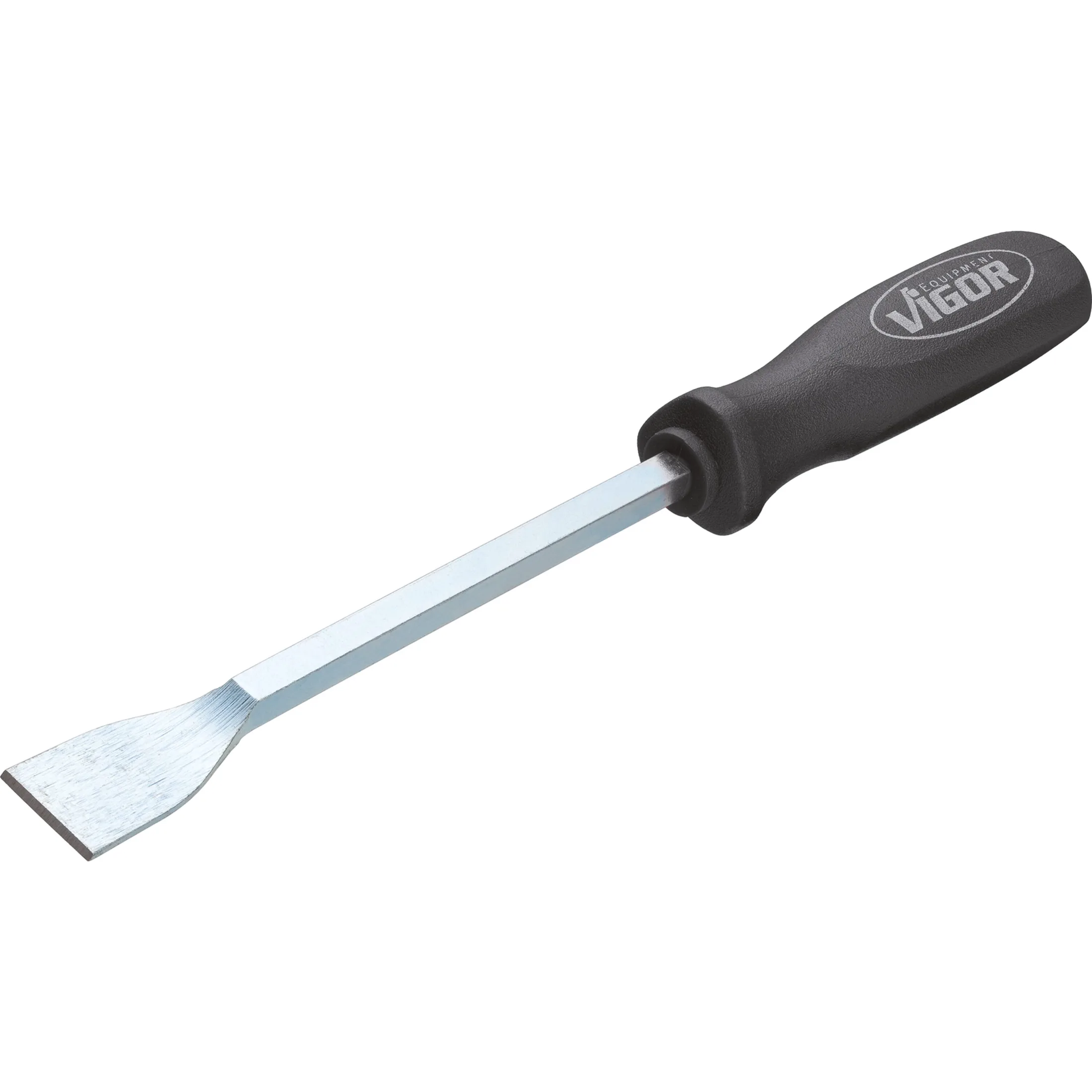

Actually, a broad knife on the dullish side works better than razor blades. Mine looks something like this:
The only thing I use it for is gaskets.
You can find something like it at parts stores, gas stations, the jungle website, pretty much anywhere.

This is similar to what I use to get a gasket off. I follow up with a brass brush to get the really small stuff.
