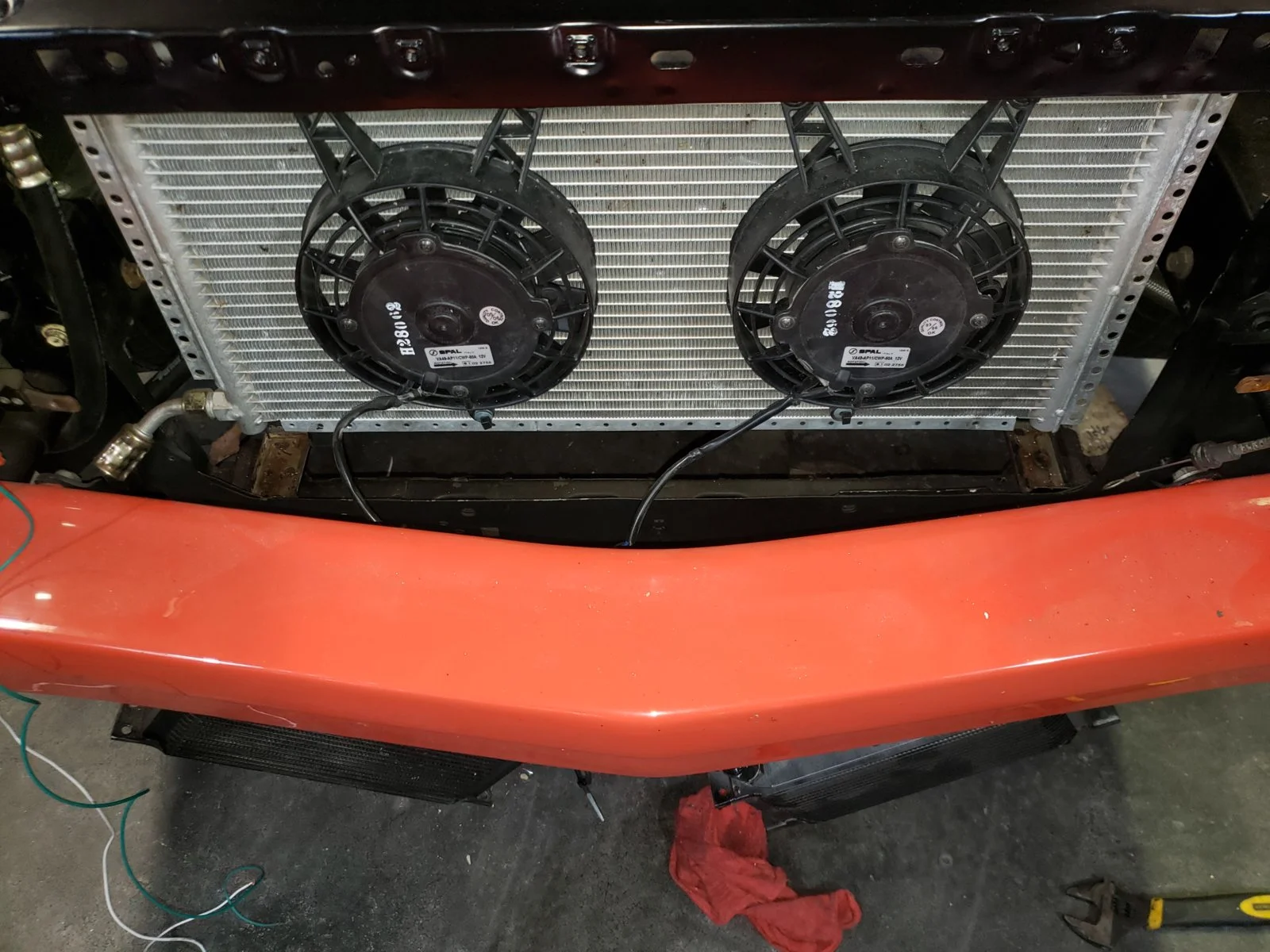

Ok. This time around, I added two additional cooling fans to the Condensor to aid in cooling the AC charge, and to help keep the engine cool in traffic. ( which now has 3 fans on its radiator)

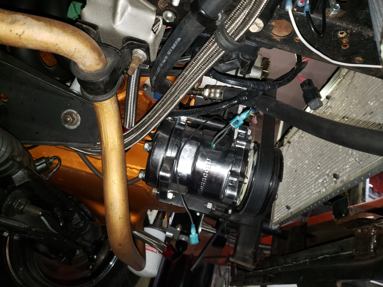

What is the EASIEST way to trigger the condenser fans? I guess I'll just run them off of the compressor trigger wire and use a fused relay off of the back of my internally regulated alternator?
That's a very simple way to get the job done, however you can trigger them to come on with the MS3 as well... but I like the kiss method on this one, don't make it harder than it needs to be.
Btw the ms3 does not deal with things like the ms2 does... you can shut the fans off when the car is at speed just like the OEM do, this can be done with the supplemental fans as well if the ms3 controls them. Or place the cooling fan circuit in series with the auxiliary fans, the ms3 can turn the fan on when the AC trigger happens... and the when the ms3 shuts the main fan off at speed the auxiliary fans shut off as well.
Fans can get in the way air flow wise when the car is at speed (above 40mph) and yes there are over temp overrides to turn the ac off and the fans on.
All this is done in the software.
