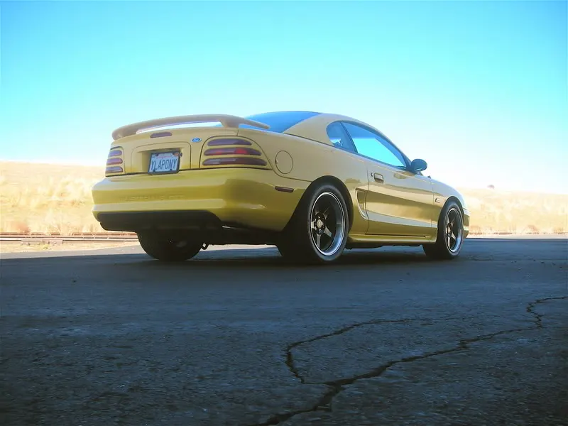

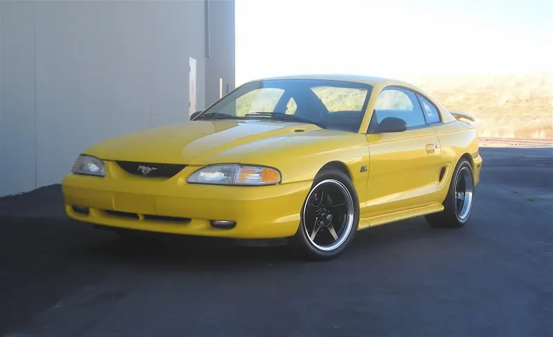

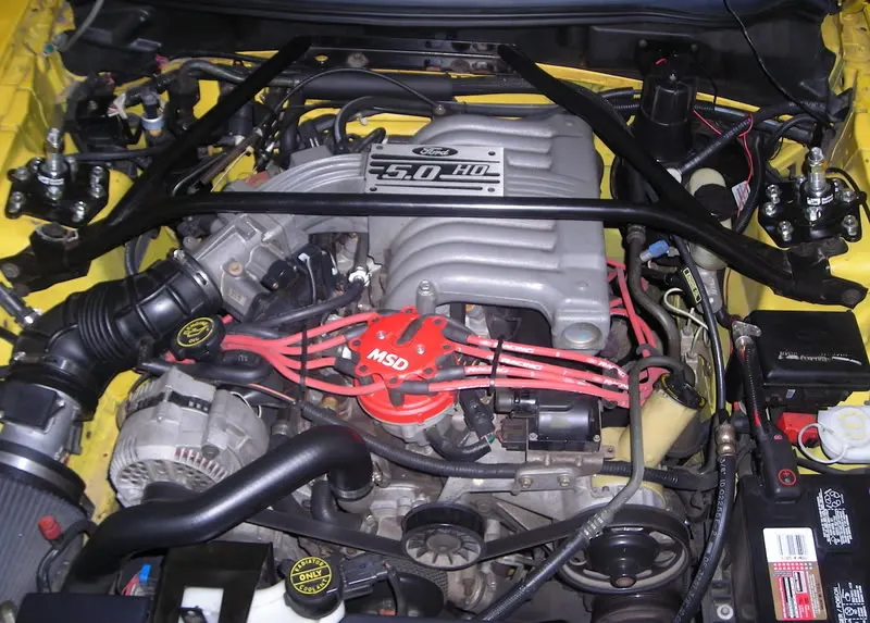

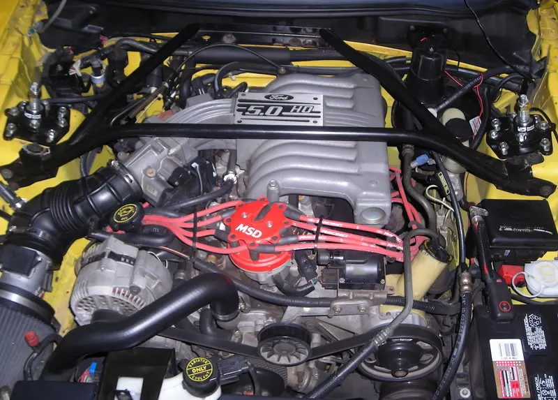

This is how it looked stock when i got it...
Here it is now....

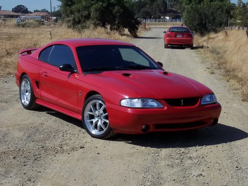

IMO the 96-98 Cobras rule! You can find a nice one for 6k (mine was 6 grand three months ago) and have a great dd with good mileage. I get about 22mpg and my foots always on the loud pedal. If I drove like a sane person I would get 25-26 mpg. Cobras respond great to exhaust and computer upgrades. Gears make a huge difference too, I have 3.73's and love them. Most Cobra owners say dont go smaller than 4.10's but since I want to go FI and drive it every day 3.73's seemed logical. As for power I only have a o/r H-pipe, Flowmasters and a chip and my car puts down 299.8 rwhp and will spin the tires all the way through second and bark them in third.
BTW EPIKGT, that is a real killer looking 5.0 :nice:
Thanks...& yeah the 96-98 Cobra's do rule....Yours is clean too....Im gonna one day get a 94-98 cobra front bumper, 95 R hood, & S281 spoiler on my 95....

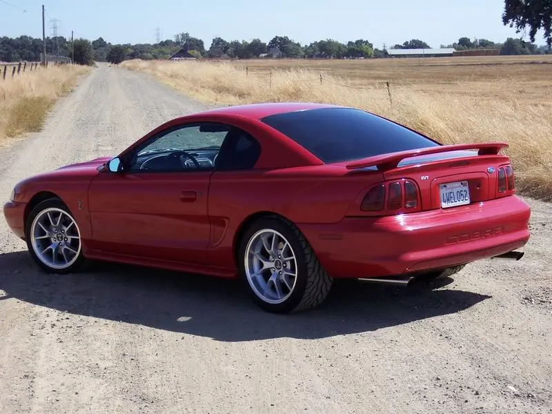

Heres my old 97...The 96-98 Cobras are the best looking SN95's minus the 95 Cobra R...
