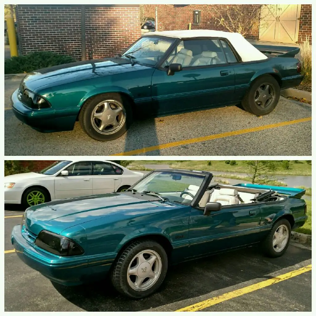

Rear ones are easy. Unbolt the quad and main shocks and slowly let down each side. You can remove the springs by hand.
Front ones are a bit trickier, but no compressor needed unless you aren't comfortable
Rears do look simple, A friend and I started on the fronts last weekend, got the passenger side done, it was a slight pain in the rear. Driver side was a different story, Finally i said screw it I'm getting a compressor lol.
Got her lowered today. She looks good. I dig it.
