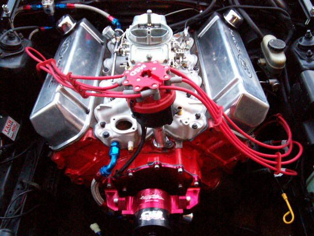

if u want power brakes u are going to need k member spacers
That is not true. I used stock k-member, no spacers. runnin power brakes and the motor clears the booster with the tall valve covers, and FRPP swap mounts, P/S, alternator, and e-water pump with a one-off serpentine setup.
Heres a two year old pic with the serp setup off .
And if i could do it again, i'd go bulletproof small block 331ci, single turbo.
