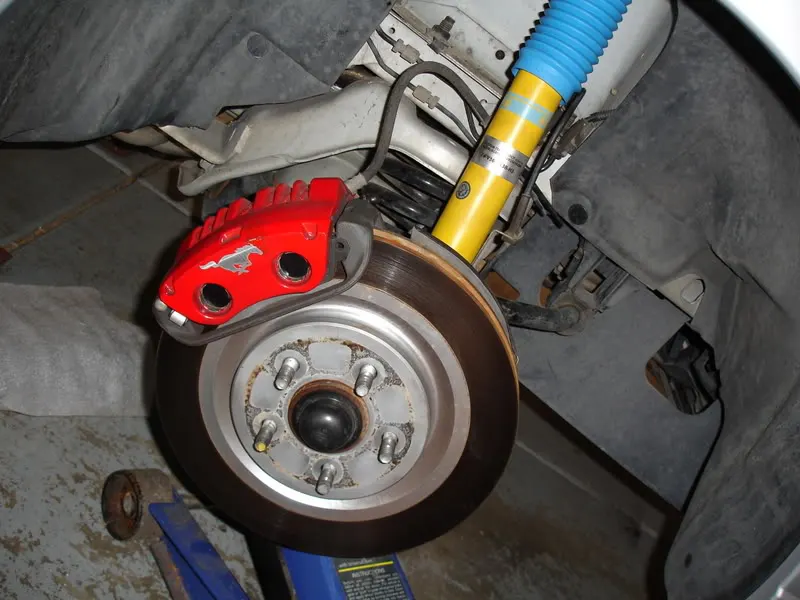

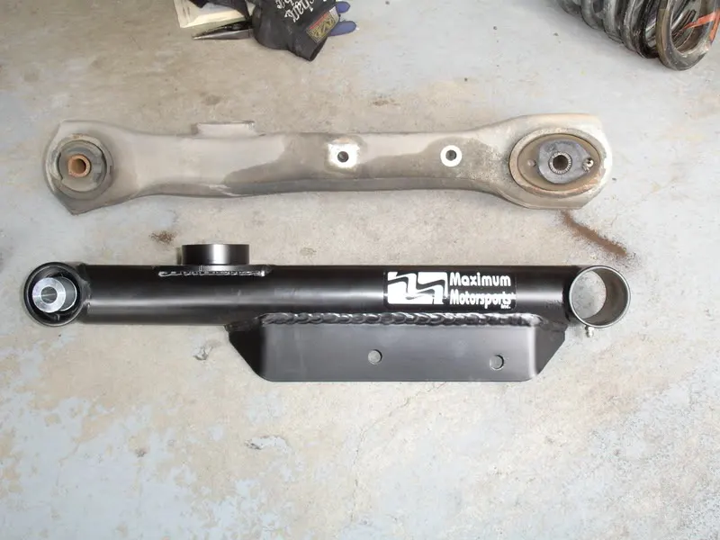

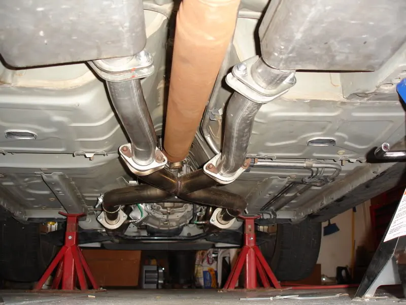

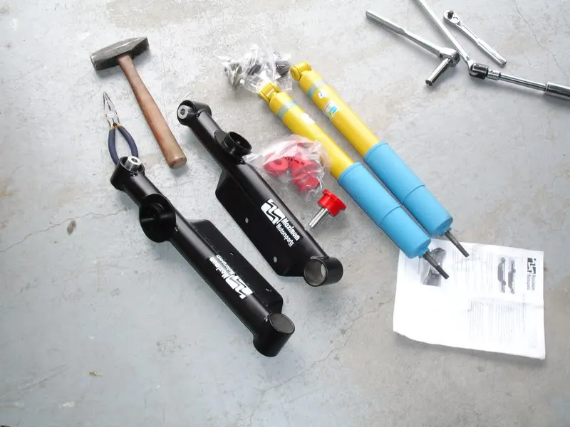

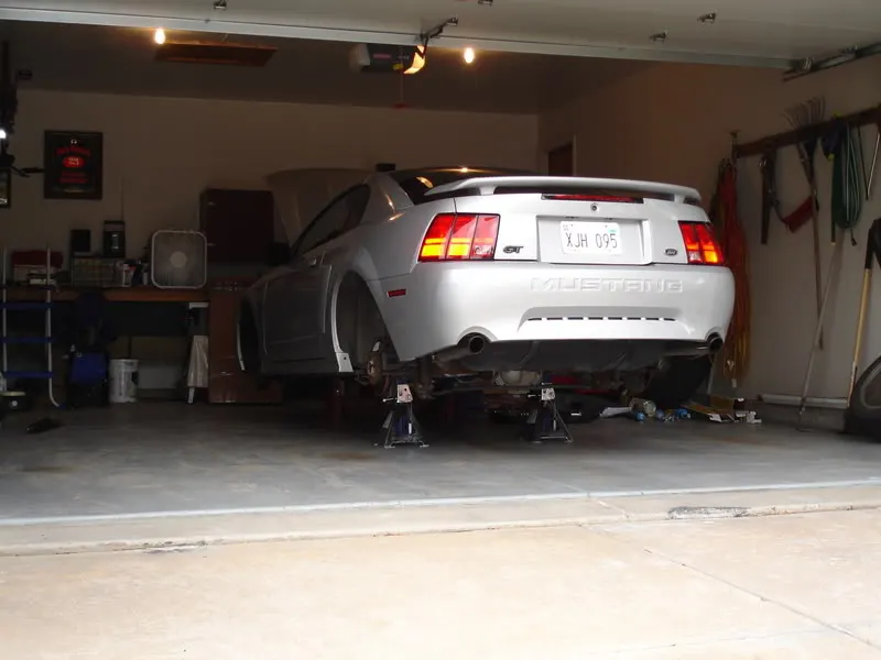

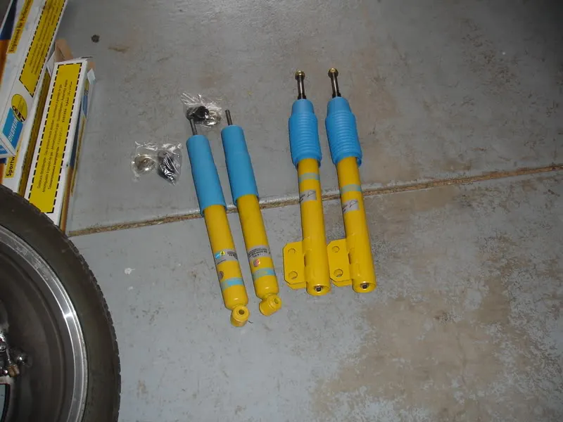

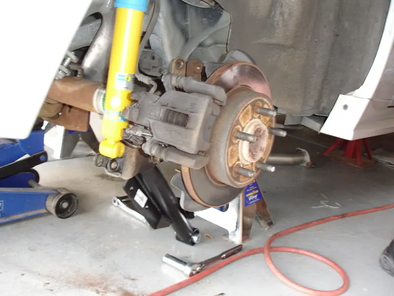

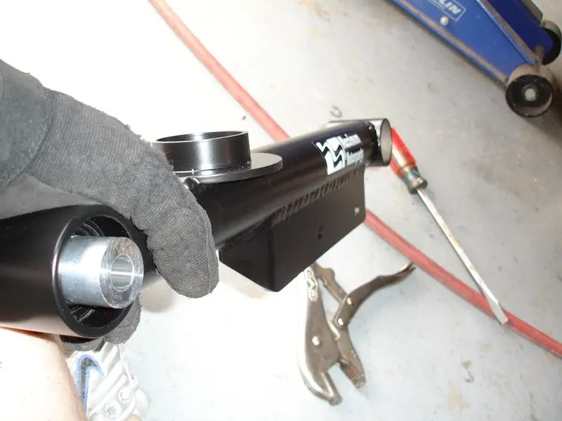

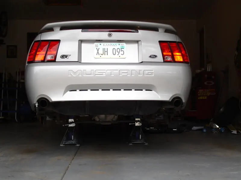

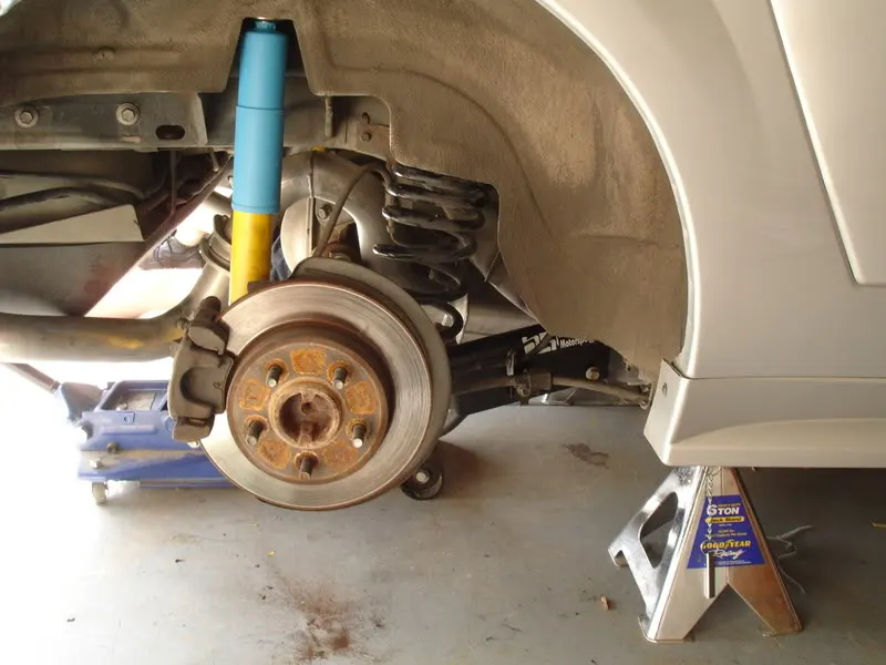

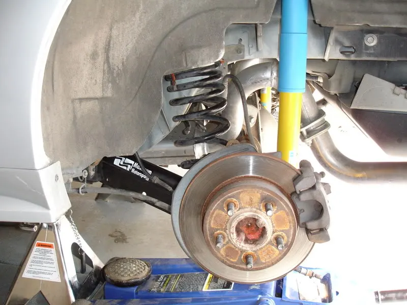

The install-
The install was pretty easy. The only thing I had a problem with is my struts didn't come with any instructions, so I didn't know I had to cut of the rubber isolator from the factory strut and transfer it over. After that it was a breeze. I didn't completely take down my catback, I was able to loosen the bolts at the x pipe and that gave me enough clearance to swing the mufflers out of the way to access the LCA bolts. Tightening the LCA bolts to 111ft lbs was a challenge. There was no way for me to get any leverage on my torque wrench from under the car... needless to say I almost crapped myself

And of course, here are some pics-
The install-
