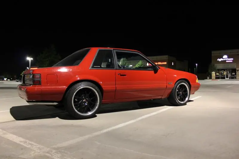

The car it's going on:

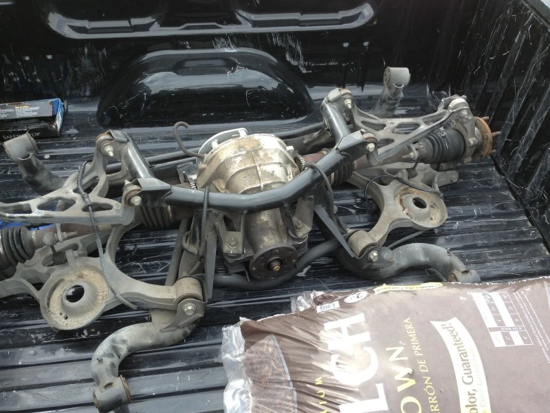

The rear end:

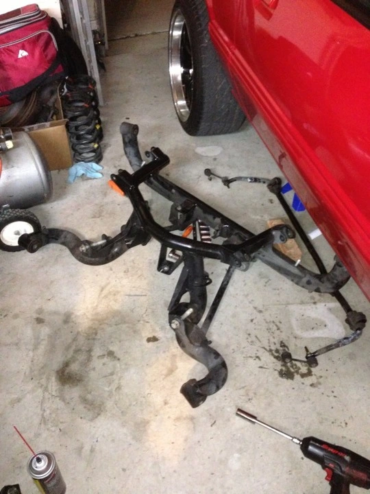

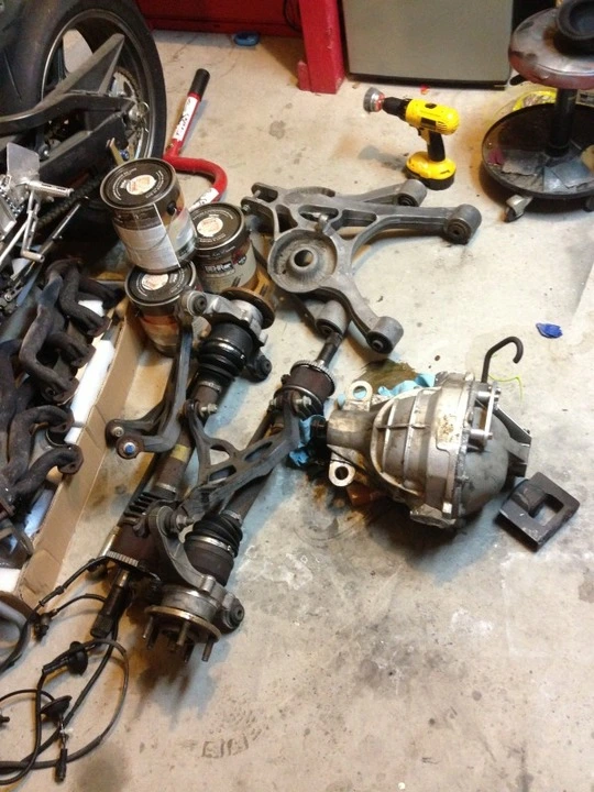

So I got my IRS all disassembled and I'll be cleaning it up completely, making it look new before it gets installed. One of the main reasons for taking it apart right now was simply to get the subframe mounted up without all the additional weight as I'll likely be doing it myself. Also I ordered the aforementioned bushing kits so it'll be easier to install them with it all apart. As it currently sits in my garage...
As you can see, it's very dirty but I'm going to clean it and paint it to make it new again.
