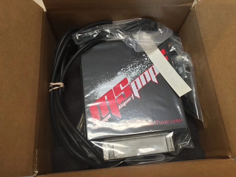

Nope, one thing at a time. I got the MS2PNP installedish (passenger floorboard) for now to start it up. Fired up on the first try with a really high idle, got the trigger offset corrected so that with the spout in the timing shows 10 degrees like it should but I still idle around 1500 RPM. I'm attaching a data log (after setting back to "use table" and burn/save) and hope that now I just need to verify my TPS and reset my idle adjustment screw... correct @hoopty5.0 @a91what ?

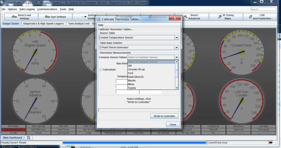

Now question about calibrating the MAT and CLT @hoopty5.0 @a91what, it looks like I'd need to know what the voltages are for those sensors as the MS unit assumes they are GM sensors... how do I find those values? It didn't seem to be a setting like the TPS where I could get current. That said, I didn't do a lot of research on it yet and intend to do that as well.
You don't need any of that, just select the ford default value.
