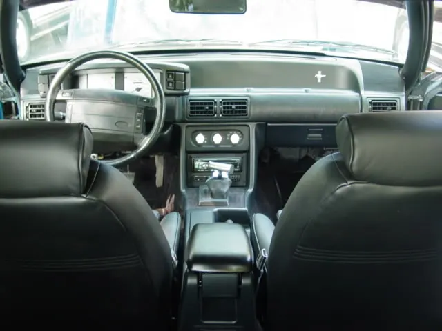

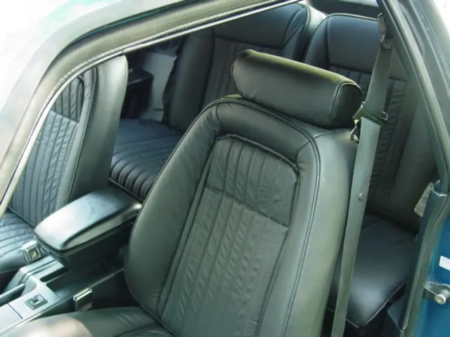

I really appreciate all the comments guys. Here are some more pictures for those that wanted to see em....

I don't remember how many coats I put on (probally 3-4). I just cleaned the hell out of it and kept putting light coats on until I was happy.
Yeah, I have been thinking the same thing about a steering wheel to top it off. Its really the only thing I dislike now. But now its time to start saving for my engine. I need some power to back the looks up.
