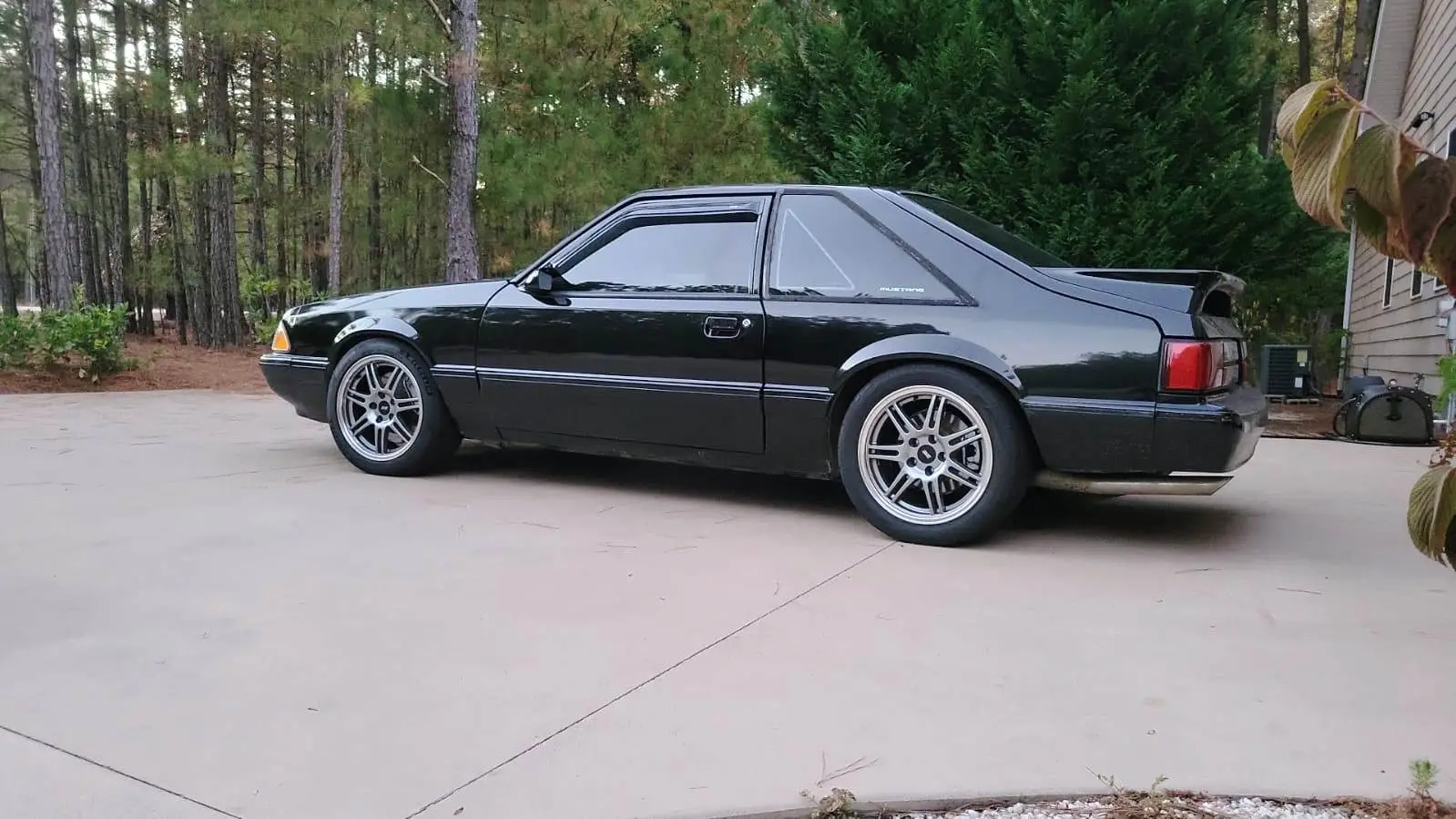

Had the day off and after installing a T56, the heavier bell-housing, putting in the Kil-mat, new 5-lug brakes, different wheels, all of the things I did last year, etc... I just got to wonderin' how the car's weight changed over that time. So, I stopped in at a gas station and topped off, pulled out all the extras in the car... no spare tire, took out the subwoofer, & all of my gadgets, and weighed the car without me. It came in at 3,220 lbs (scale precision is 20-lbs increments). It did 1,860 up front (58%) & 1,360 on the rear tires (42%).
Before heading over, I asked a friend to over-under 3,250 which was my best guess at where it'd come in. He guessed over. I would have, too. Completely topped off means that race weight with 12 gallons less & my fat azz in there would be closer to 3,400 lbs. All-in-all, I'm pretty pleased!
edit: ya know... I really thought I had weighed it before, way back when I was racing it, but I cannot find any evidence of that in my file or in this thread. Oh well. I'll bet it was at least 100 lbs lighter back then.

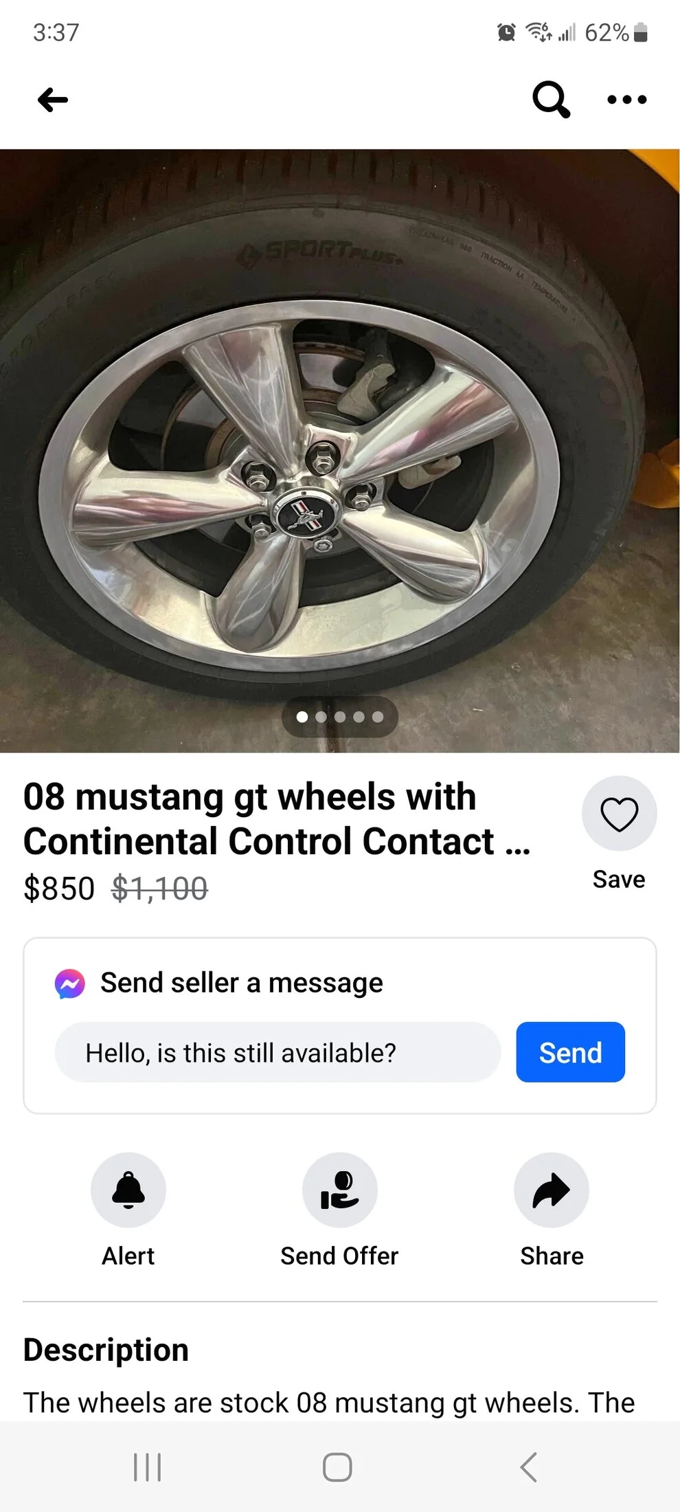

Can't run Nitto drag Radials & Michelin PS4S tires through the winter on Black Jack.
Anyone know if these would work for my winter wheel?
Som quick research leads me to believe the stockers were 18×8.5 with a 34mm offset. So, that would make the backspacing around 5.84". That feels like it should be pretty close for my 94-95 front spindles & stock fox length rear axles. Has anyone run em over Cobra brakes?

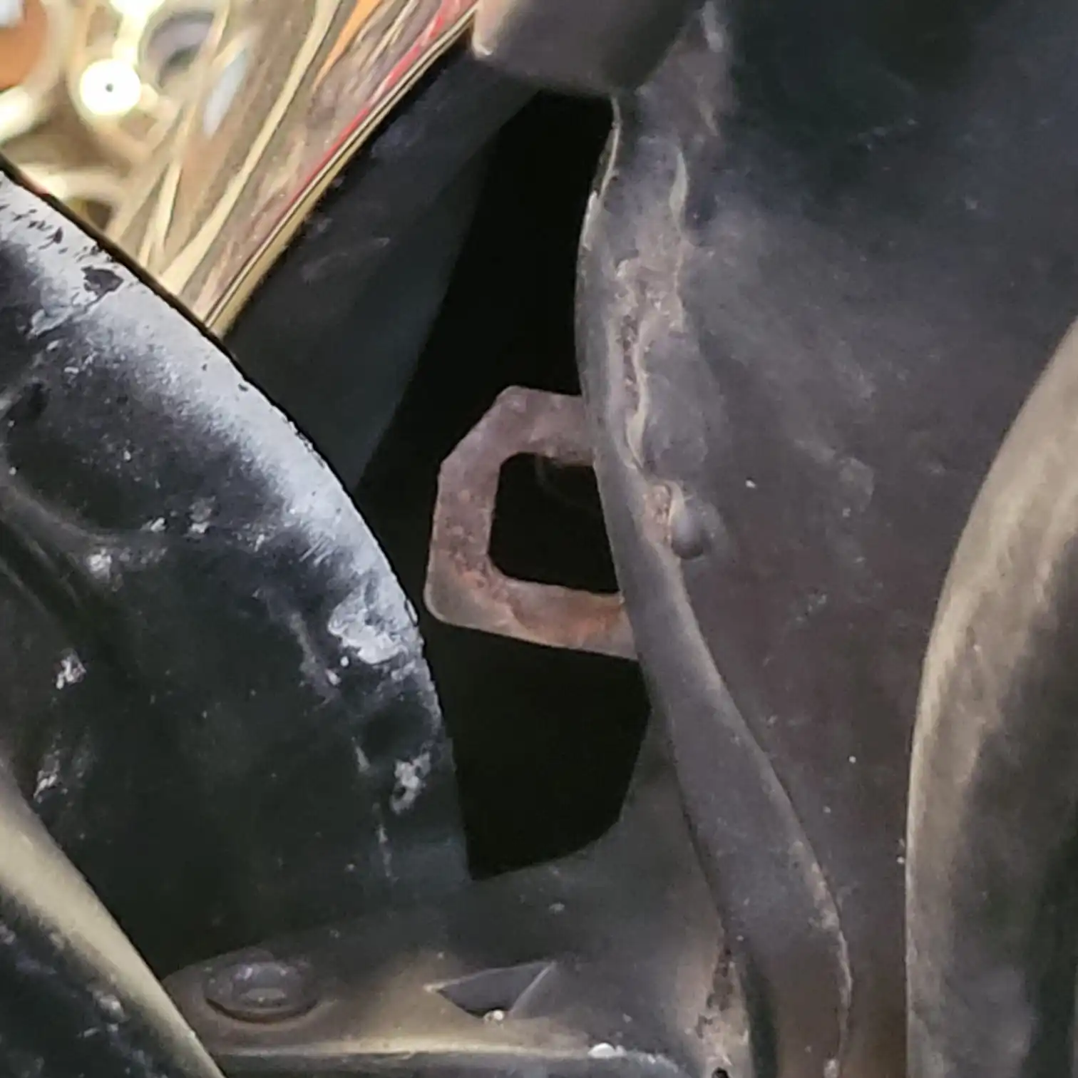

I'm out there trying to eliminate a squeek coming from the passenger rear suspension. I think I found the culprit, a worn lower rear shock bushing allowing metal-metal contact. I've got some bushings on order, and will zap it with a little grease for now. While I've got it on jack stands, I'm also gonna throw on the dust/splash shields I didn't realize I didn't have before I did the 5-lug swap. Put 'em on order about a month ago and just got consumed by other priorities. I spray painted 'em flat black. Not sure they're really good for anything, but I couldn't shake the feeling that the Cobra Brake swap was half-assed without getting a set. I haven't taken any side profile shots since the swap. BJ's dirty, but what the hell... Just my daily, after all:

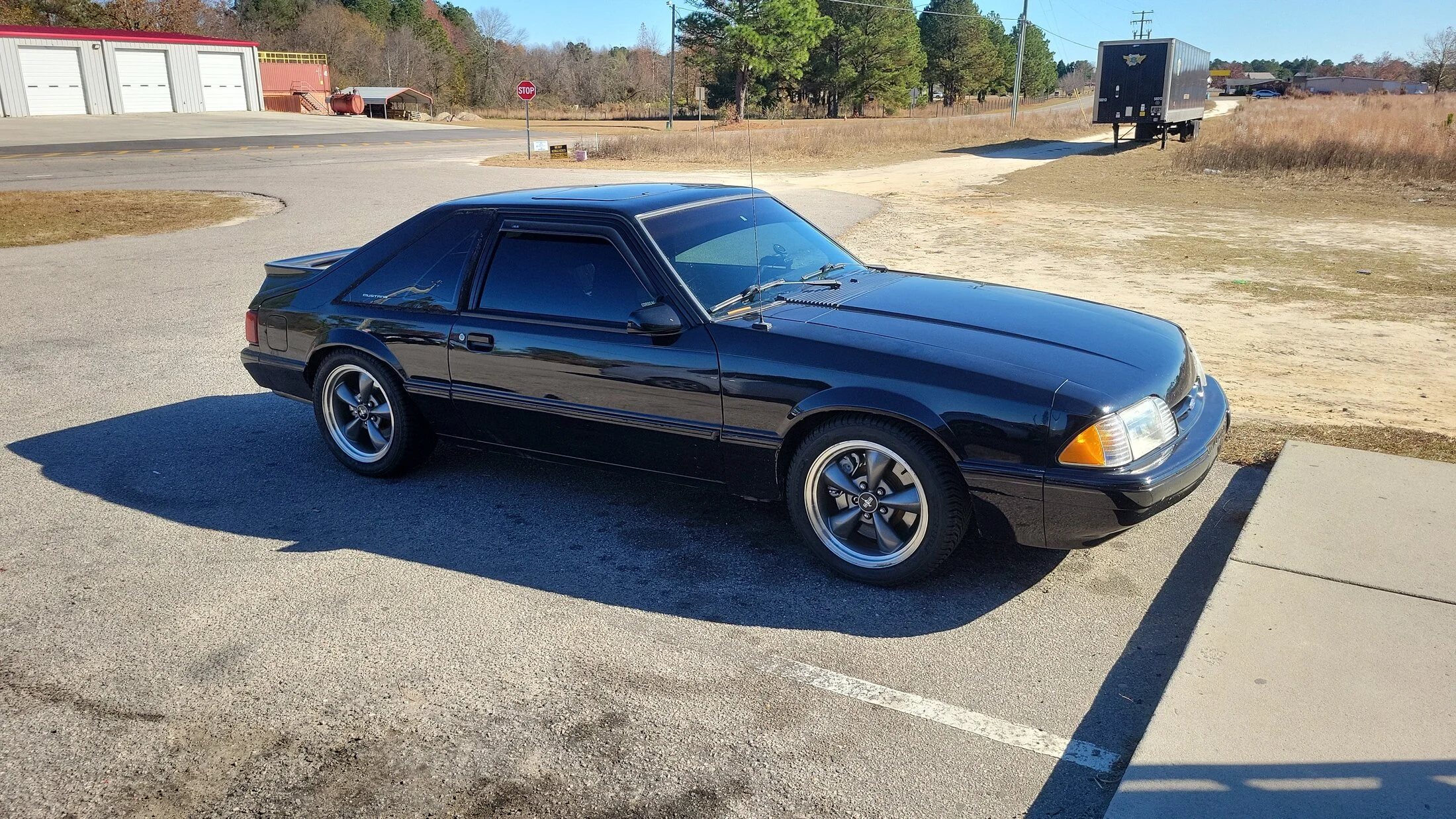

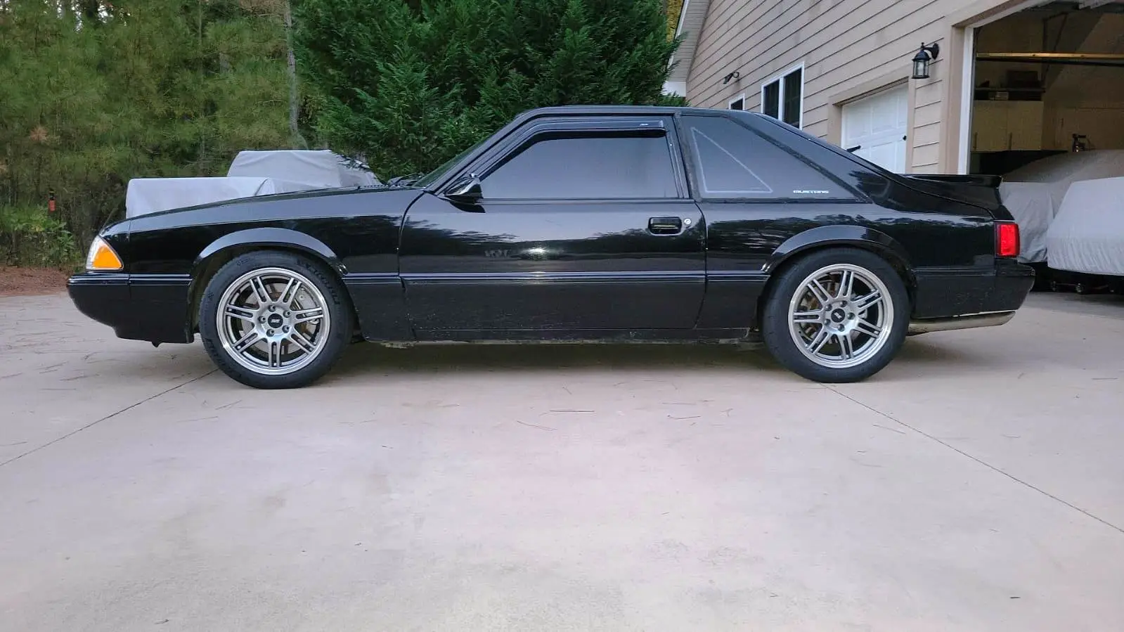

Mounted & balanced. Always liked this look:
Reactions: General karthief, Rdub6 and Mustang5L5

That’s a nice look.

Mustang5L5 said:
That’s a nice look.
Familiar one, no?
