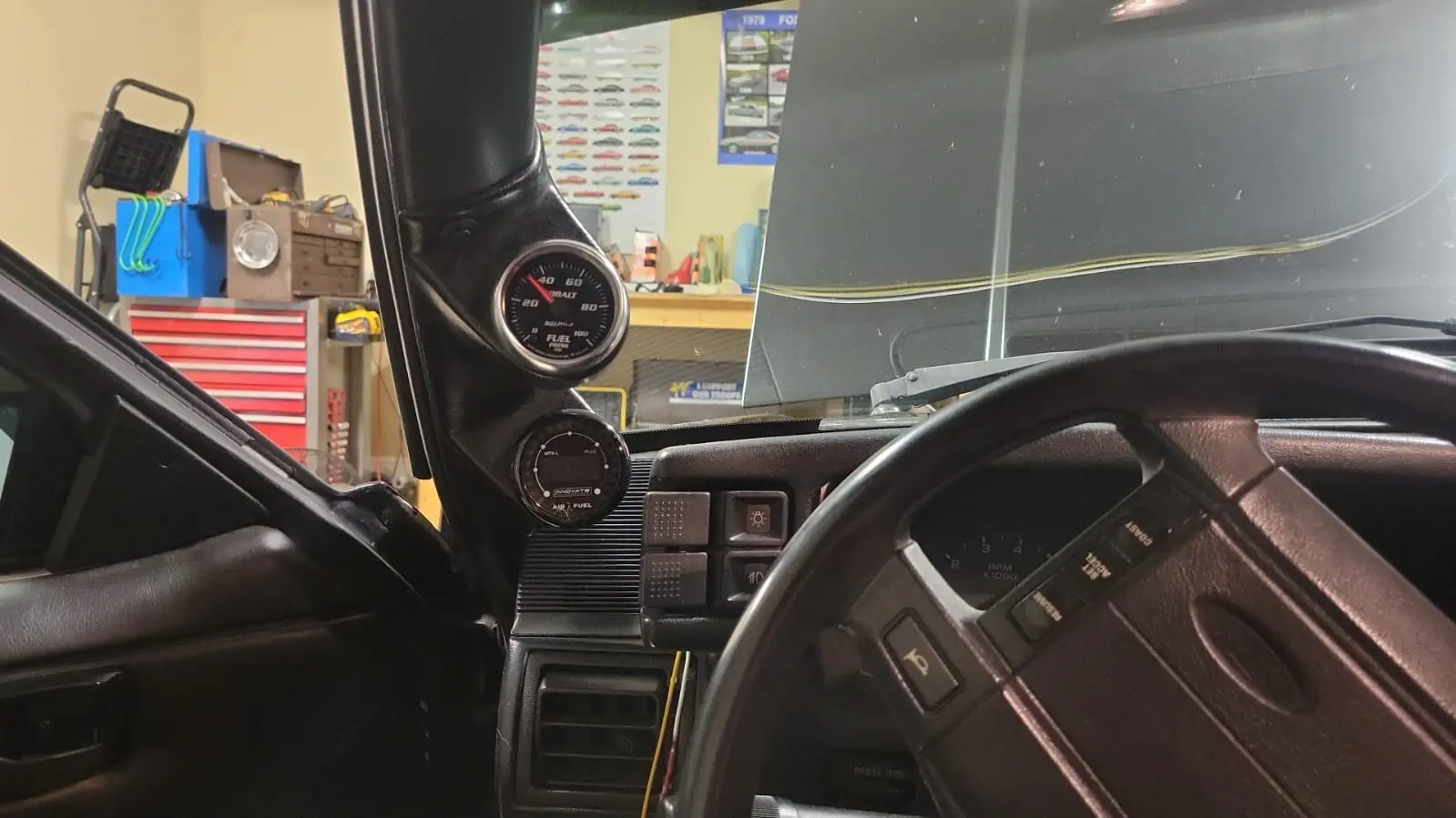

New Gauges:
Tonight I installed the new gauges. I borrowed my old gauge pod from Father Time/Snake Pit & installed the Innovate Wideband (MTX-L I think) & Autometer Fuel Pressure gauge. I still need to connect the white wire for the back-light & yellow to the EGR pin on the A9L for datalogging. I'm looking forward to being able to tune on AFR once I install the Moates Quarterhorse.
