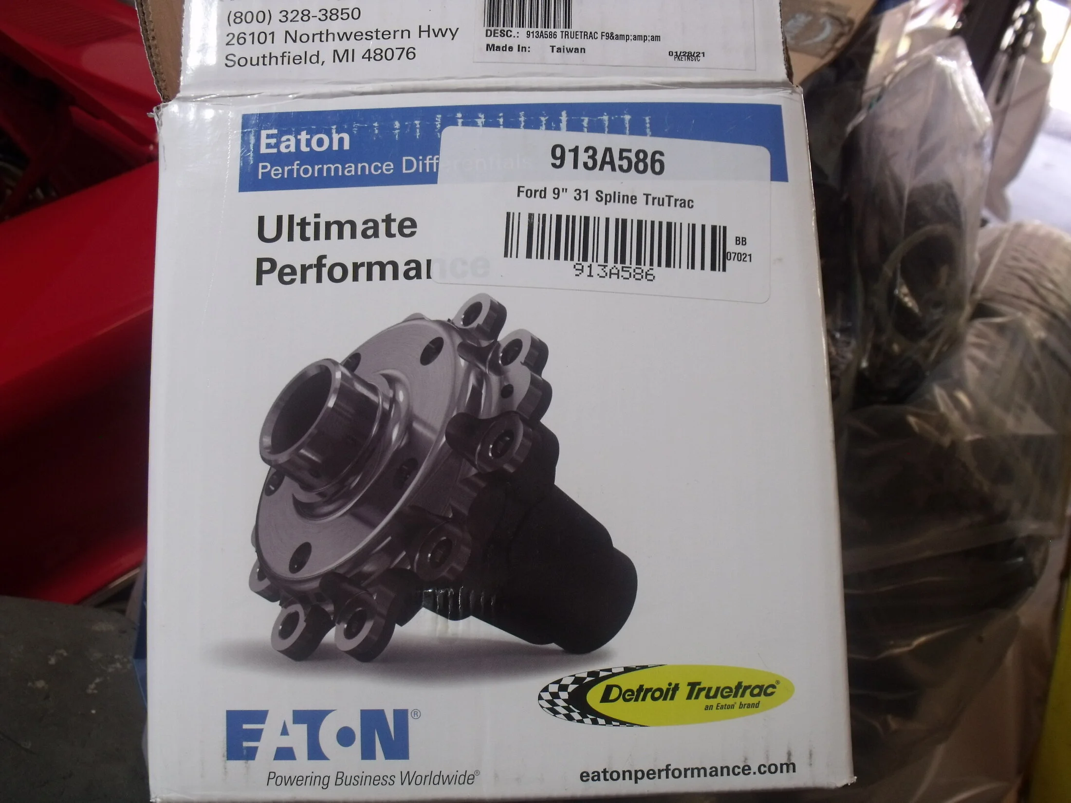

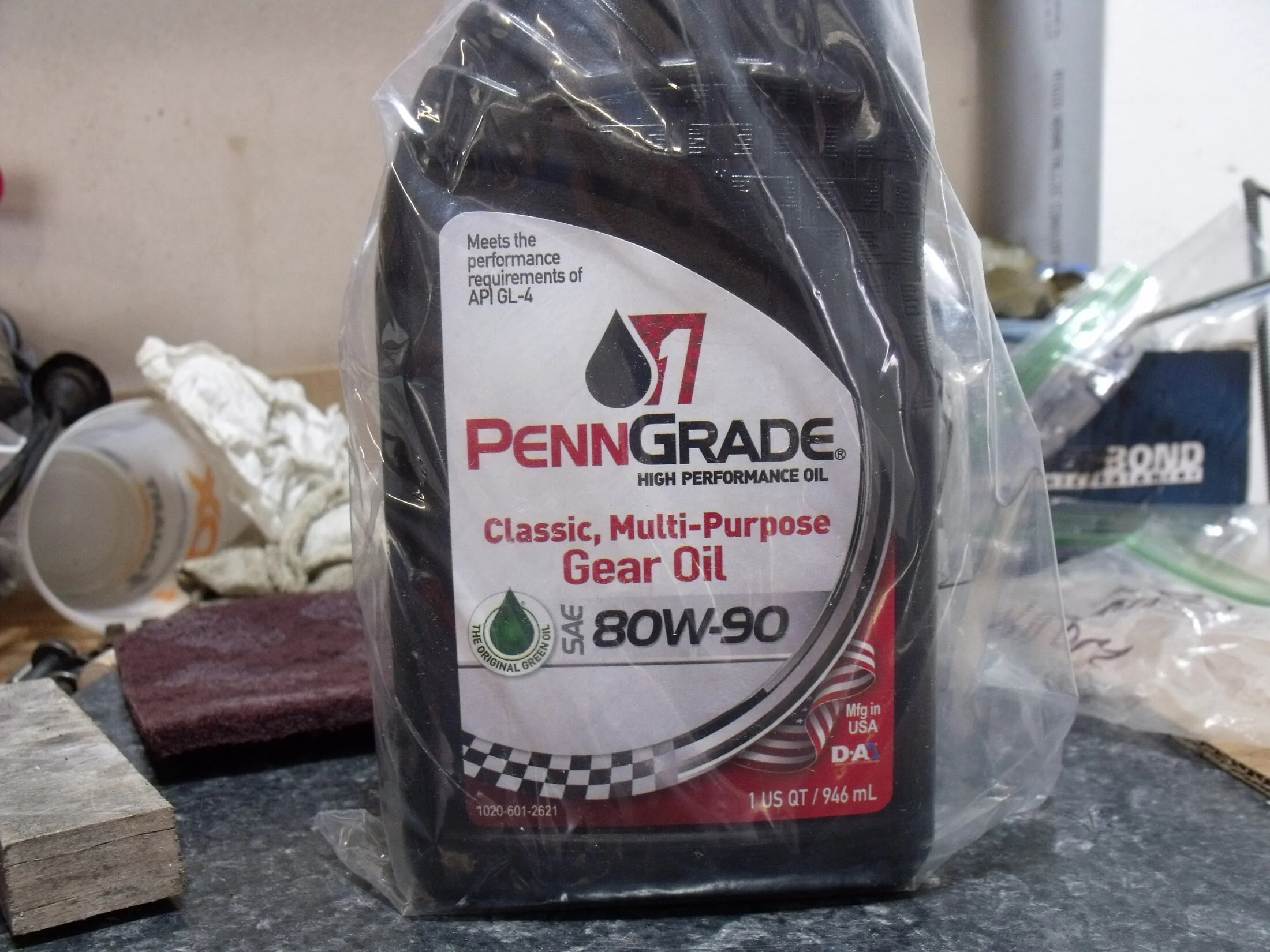

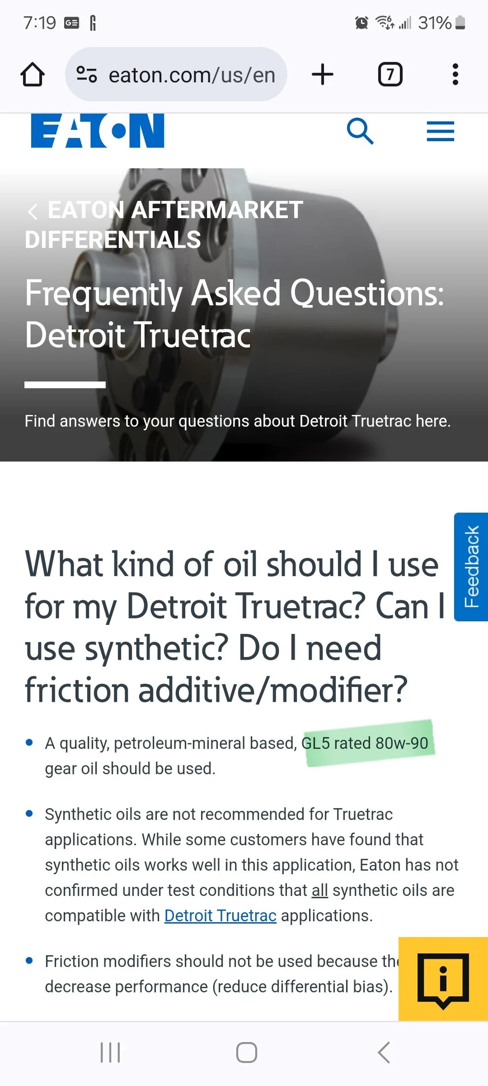

Is there any break in period I should be concerned with for the gears or Truetrac diff?
TRuetrac and gears both want a fluid change at 500 miles.. Using GL-4 gear oil as per required by Trutrac..
TKX wants a fluid change at 500 miles from new also...
Reactions: FastDriver
That line in the second bullet point about not recommending synthetics speaks to how thoroughly they test things & makes me think they won't recommend fluids until years after they come out.
