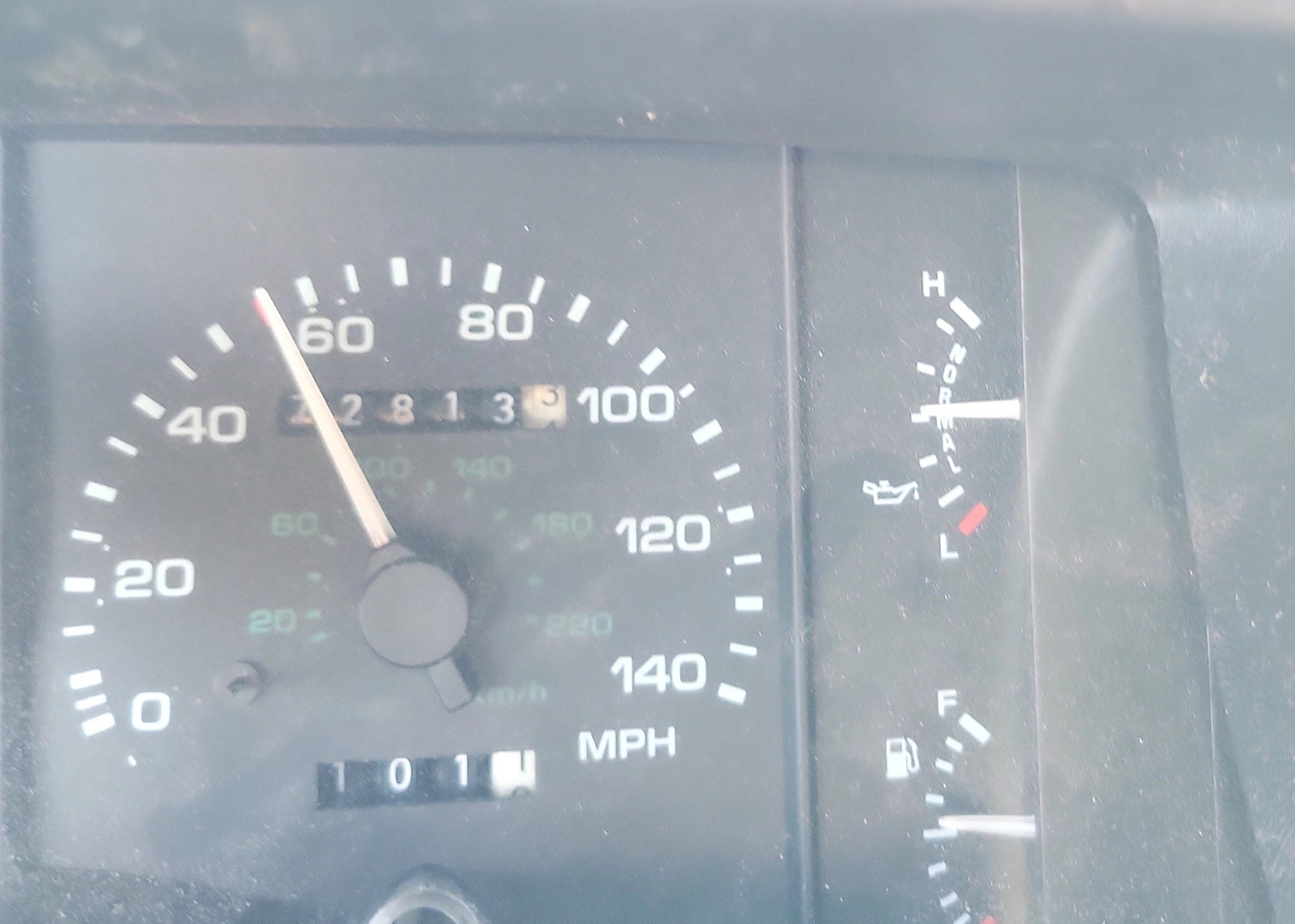

Guess I'm gonna baby it a bit. Might need that mexican block motor sooner than winter.

Sounds strong to me!
I think you will get lucky with it just the gauge.
Sending positive thoughts your way!

I hope it's just your sending unit!

Same thing as what happened in your video happened to me
Gave me quite the scare, ended up being sending unit but at the time replaced oil pump and some other things just cant remember as it was years ago. Good luck to you!

Fingers crossed it's just your sending unit.

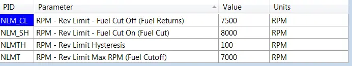

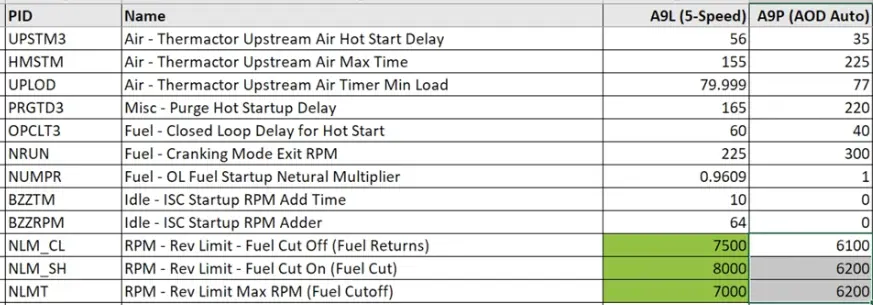

Well, I'll be damned... I've been saying that the factory limiter is at 6,250 for probably 20 years. Turns out, it's apparently different depending on the exact EEC. In the '93 Cobras, Cougar 5.0 says it actually is 6,250. In the A9L, I found the RPM limiter tables, but they didn't add up to any personal experience:
That looks like 7k (assuming it's used despite the fact that the notes tables in binary editor suggests otherwise). But, Cougar5.0 posts suggested that the MNPIP8 scalar actually is the A9L's effective limiter:
So, if I understand correctly, 6,504 is the actual rev limiter with an A9L. I just set this to 6.8k, my MSD to 6.5k, and my nitrous cutoff to 6.2k.
These files could be adjusted and saved, and therefore may not be Ford's original tune, but this is the "A9L.BIN", and it's supposed to be the stock values from Ford. Well, digging a little deeper, I found that the A9P (from a Leech motorsports video comparison) has a limiter at no higher than 6.2k:
Anyways, until you get your hands dirty, I guess you never really know anything for sure.
Edit after test drive:
On a test drive, I can at least confirm that I was able to hold a sustained 6,400 RPM after my adjustments, according to both the MSD signal & the EEC's RPM signal in Binary Editor's live dashboard. Therefore, I can't confirm with absolute certainty that changing the MNPIP8 changed anything, but I can confirm that with it at 6.8k, the MSD Digital 6+ at 6.5k, I can read at least 6.4k.
I went WOT and heard no detonation or anything concerning. After confirming with 1 or 2 brief test runs, I let 'er rip to the limiter and though I could feel torque falling off, my calcs still say it'll be more optimal to shift at 6.5k NA. With the juice set to cut off at 6.2K, I'm going to put a shift light in at 6k, now. I don't know how that will compare to the 5.6k pill I used to have in the light, but I'll report back after the next track outing.

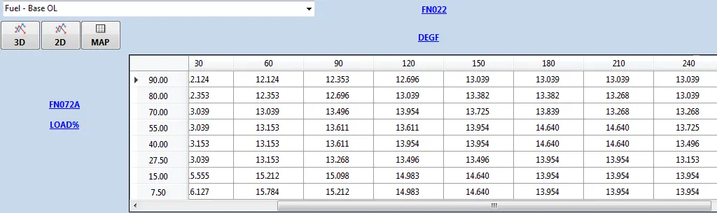

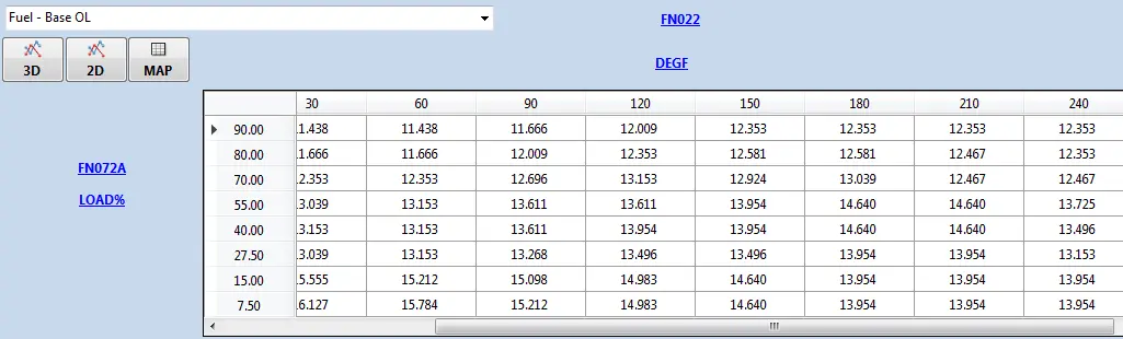

More tuning updates:
- Shut off the EGR so it's not trying to control anything, and should prevent any codes.
- Reset base timing to 10* (from 14) & bumped WOT spark only by 4* across the board
- Was able to find the "EVP" which is the EGR Voltage. I connected it to my wideband analog output from the Innovate MTX-L. So, now I can see & datalog my AFR within Binary Editor, which is going to be awesome for tuning
- In the Fuel tables, there's a WOT multiplier that the stock A9L uses to add something like 3-9% fuel. I removed that multiplier (set all = to 1), but I also messed with the tables. Here's what the stock Open Loop target AFR table looks like:
So, it looks like it's commanding 12.353:1 AFR from 150* on up. And... that's about what I saw from my WB O2 guage at WOT. I adjusted these targets to the following by multiplying the table values all at once:
So, these AFRs are ballpark where I'd like to see them. I went for a drive and ran it out a couple times. On the first pull, I was seeing 13.3 to 13.5, and on the 2nd pull, I saw as high as 13.7. That's definitely leaner than I'd like it to be. So, I went back and restored the WOT Fuel Multiplier table, for now. It's not my preferred solution, but it should get me by until I can get back to tuning again.
That supposedly multiplies the target AFR in the first tables by the multiplier, effectively enrichening the AFR by RPM.
When I datalog, I should get information that tells me if I need to make global changes (injector slopes), or local changes (MAF xfer function). I may also learn about more tables or settings that might be relevant. I'm basing setting that table to 1 because the Leech Motorsports guy was saying there are more elegant ways of handling Fuel Adjustments. Honestly though, as I review this again, I'm surprised I'm not seeing a Load (x-axis) vs. RPM (y-axis) kind of fuel table. So, this actually is still the way that makes the most sense to me. But, I'm open-minded to his techniques. Just need to learn more.
