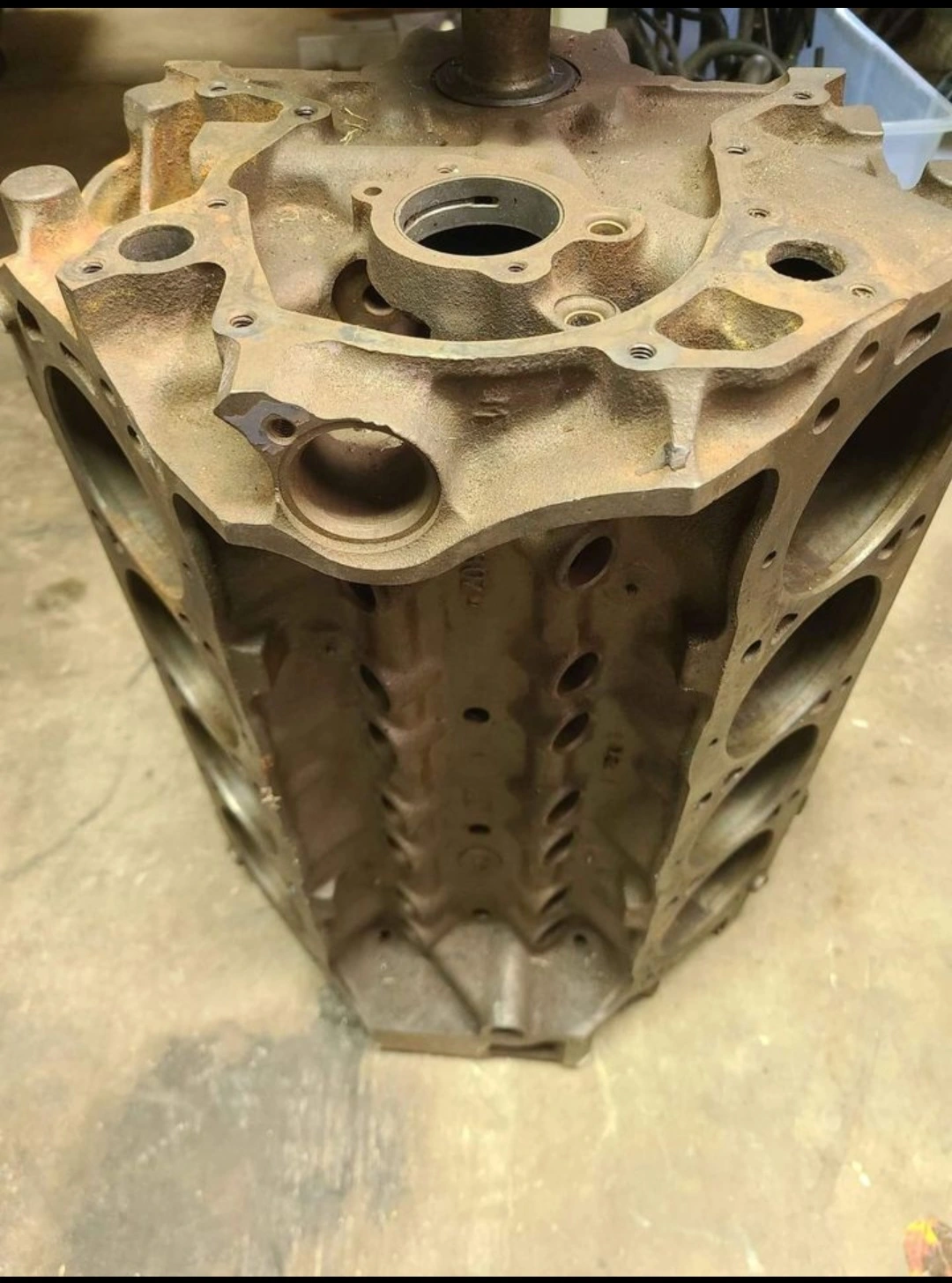

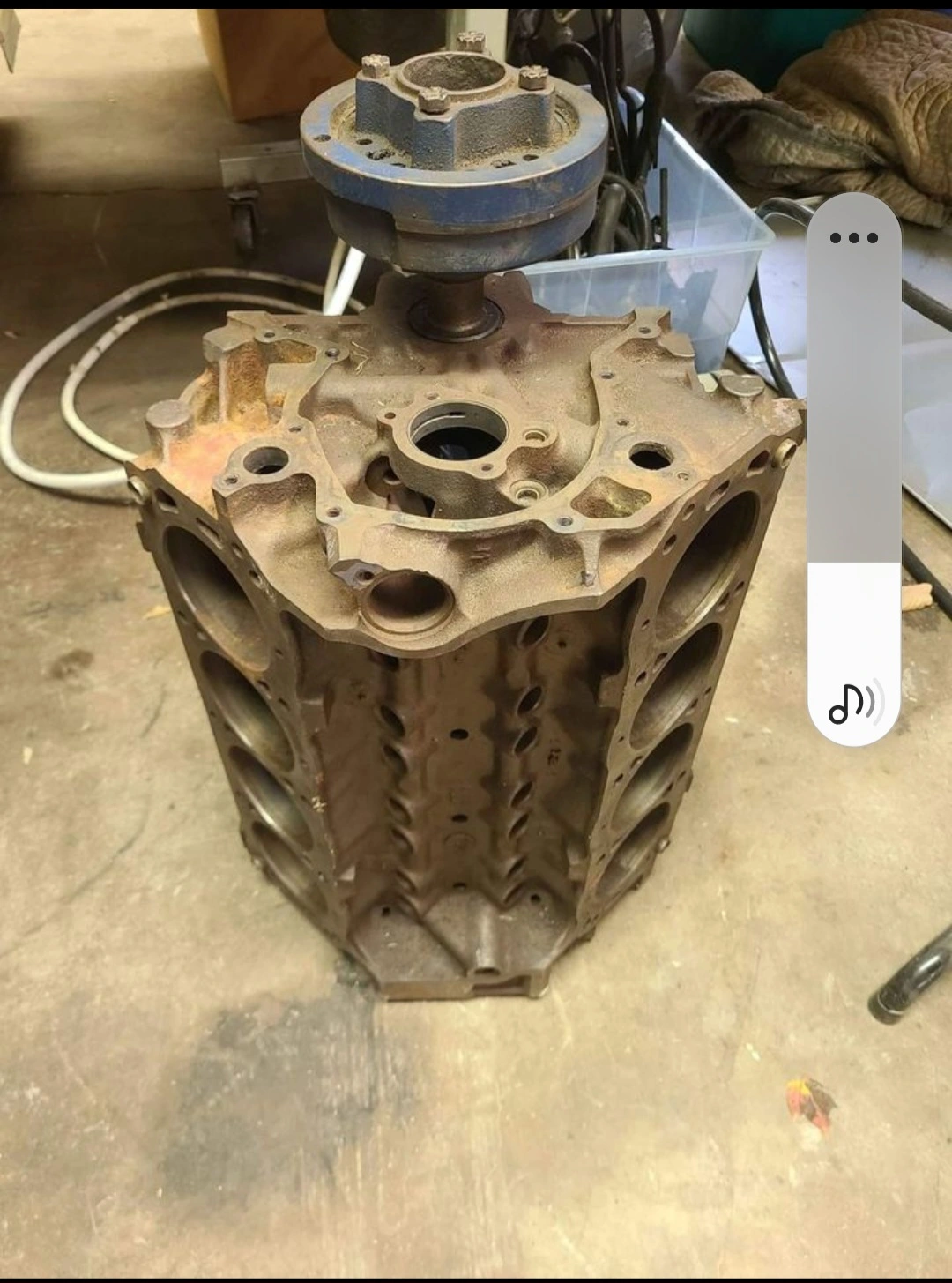

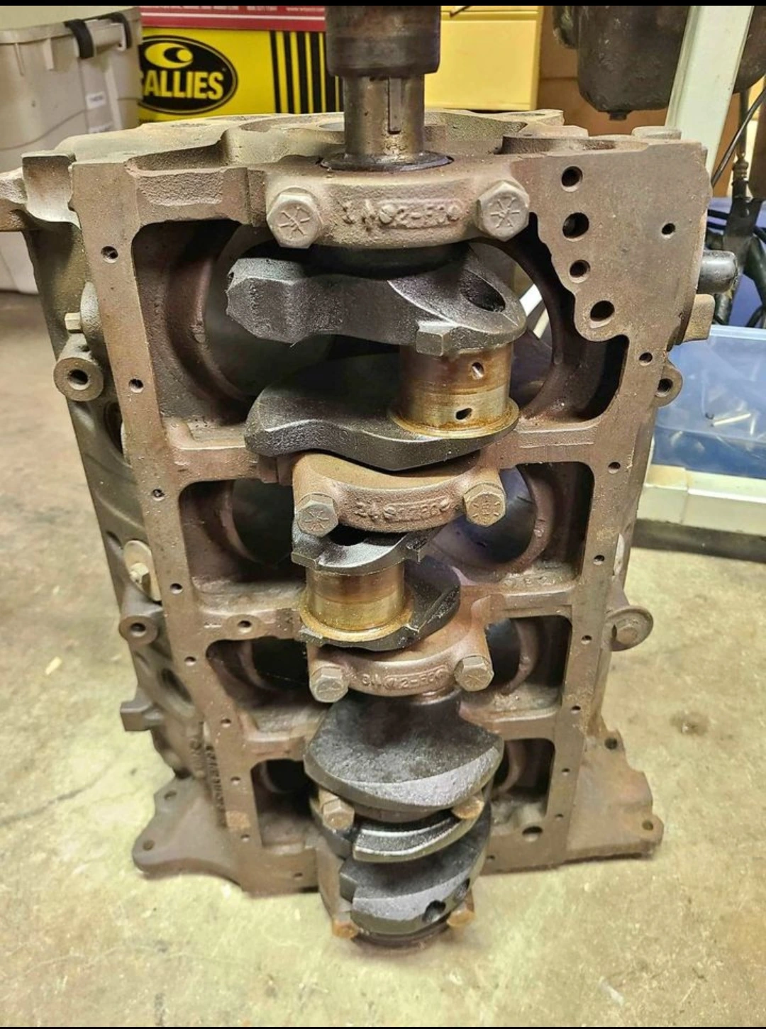

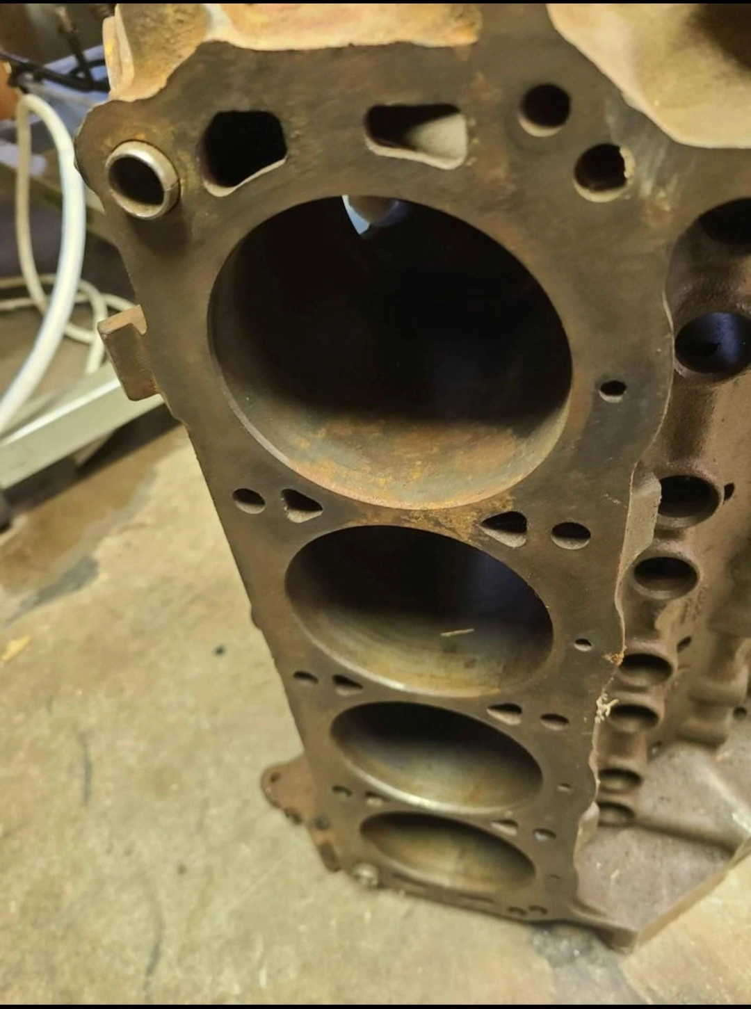

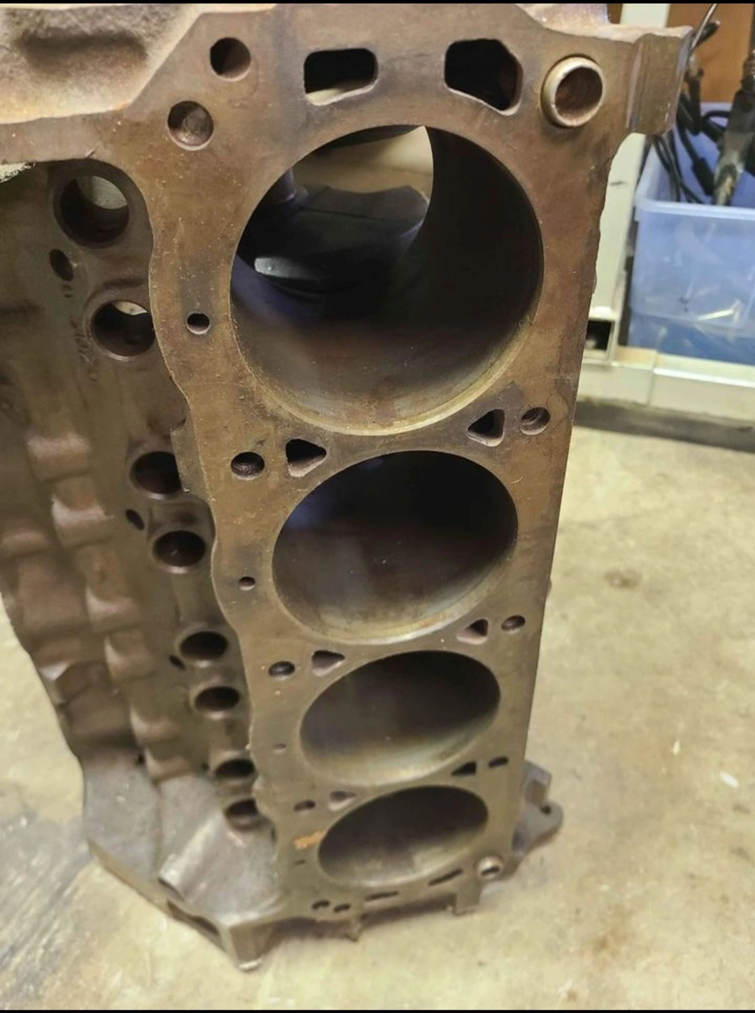

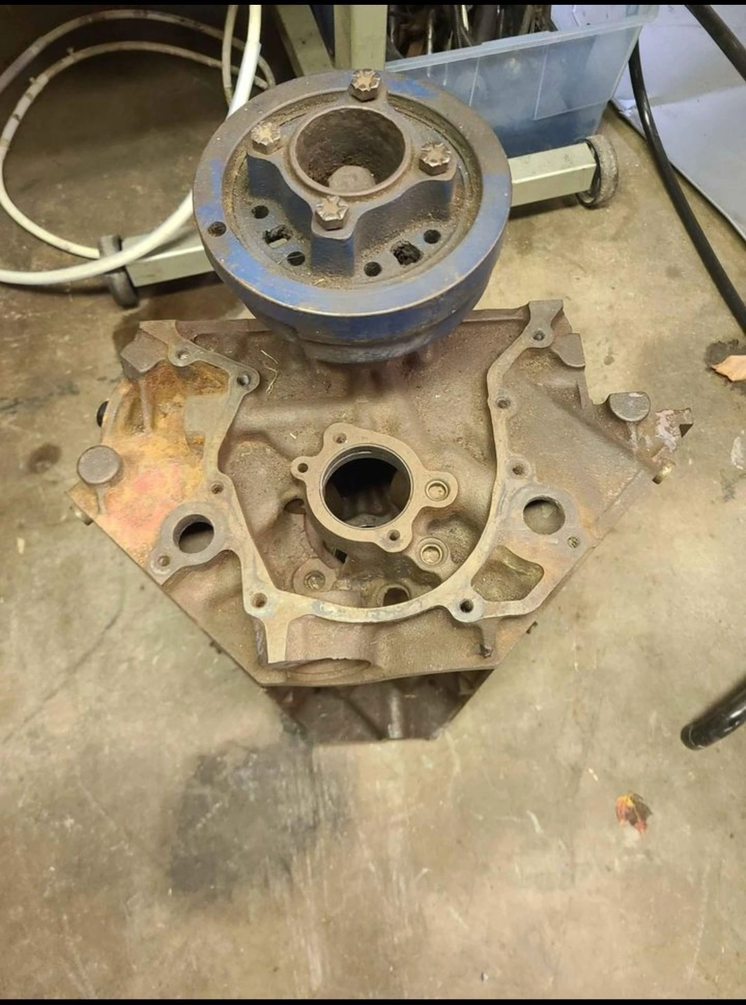

New build's foundation: Mexican 302.
I found a mexican block near my parents' home in Ohio for $400. The fella thinks it's still on its original 4.00" bore. I'm worried about the rust, but excited to give it a shot. If that doesn't work out, Michael Bell has one that's already been built for $600.
I also learned that apparently around '74, the mexican blocks added .020" deck height. I'd guess this was a compression drop due to gas era stuff. It would be good for turbo/blower motors on pump gas. But, I'm hoping the block I'm looking at is the earlier version, or that I can find some affordable pistons that will bring compression back to near 11:1, as the extra compression be preferable to me NA, and I dont think it hurts on nitrous.
Would be lovely if the crank and balancer check out too, and then all I need to get are improved rods and pistons.
For those who may find this later, it's hard to beat the info in this thread:
And, though the pics aren't showing up for me now, they may be the ones I reposted here:
The cliff's notes on why a mexican block:
- The #1 issue is keeping the main caps from chattering and walking. Girdles don't fix that, and balancing doesn't either. A rotating assy is balanced at TDC and BDC, but at 90*, the weight still has to be contained by the main cap. When you have a thicker cap and webbing, that obviously helps, and mexican blocks have wider and thicker main caps than ANY of the other production ford blocks - pretty similar to the original 1965 era HiPo 289 blocks.
- The early blocks and mexican blocks have blind main bolt holes, reducing the chances of a crack forming, they are slightly thicker under the main cap registers as well.
- head bolt threads of mexican blocks, and the early 289-302 blocks up to '74 or so, are all blind so there is no chance or issues with water leaking, whereas our later model roller blocks are not blind and headbolts must be sealed.
Reasoning specific to my build:
- I have maybe a 150-200k mi stock shortblock it would make sense to drop $1k+ into refreshing when I do the top-emd build, anyways.
- I plan on stepping up to a new combo that I hope will put me right in the danger zone of the accepted 5.0 roller block limit of 500 rwhp.
- I'd rather build another block while mine is still running and getting me to work every day. A motor swap is faster than an engine build.
- Might do better selling my current motor as a package deal when I can confirm it's in good running condition to a potential buyer.
- Already have 2 Dart block projects. Not looking to build another out. Let's keep things cheaper and I'll always be able to find another shortblock if I blow this one up.

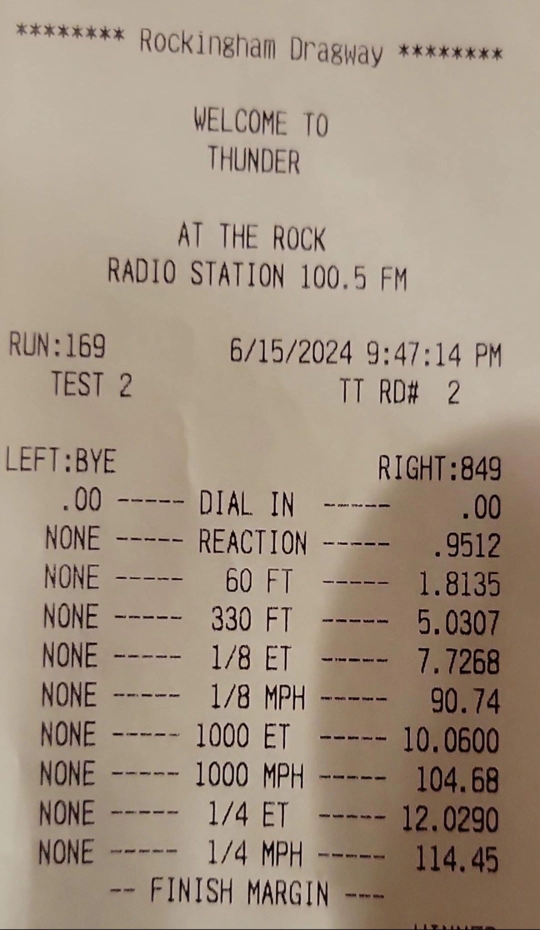

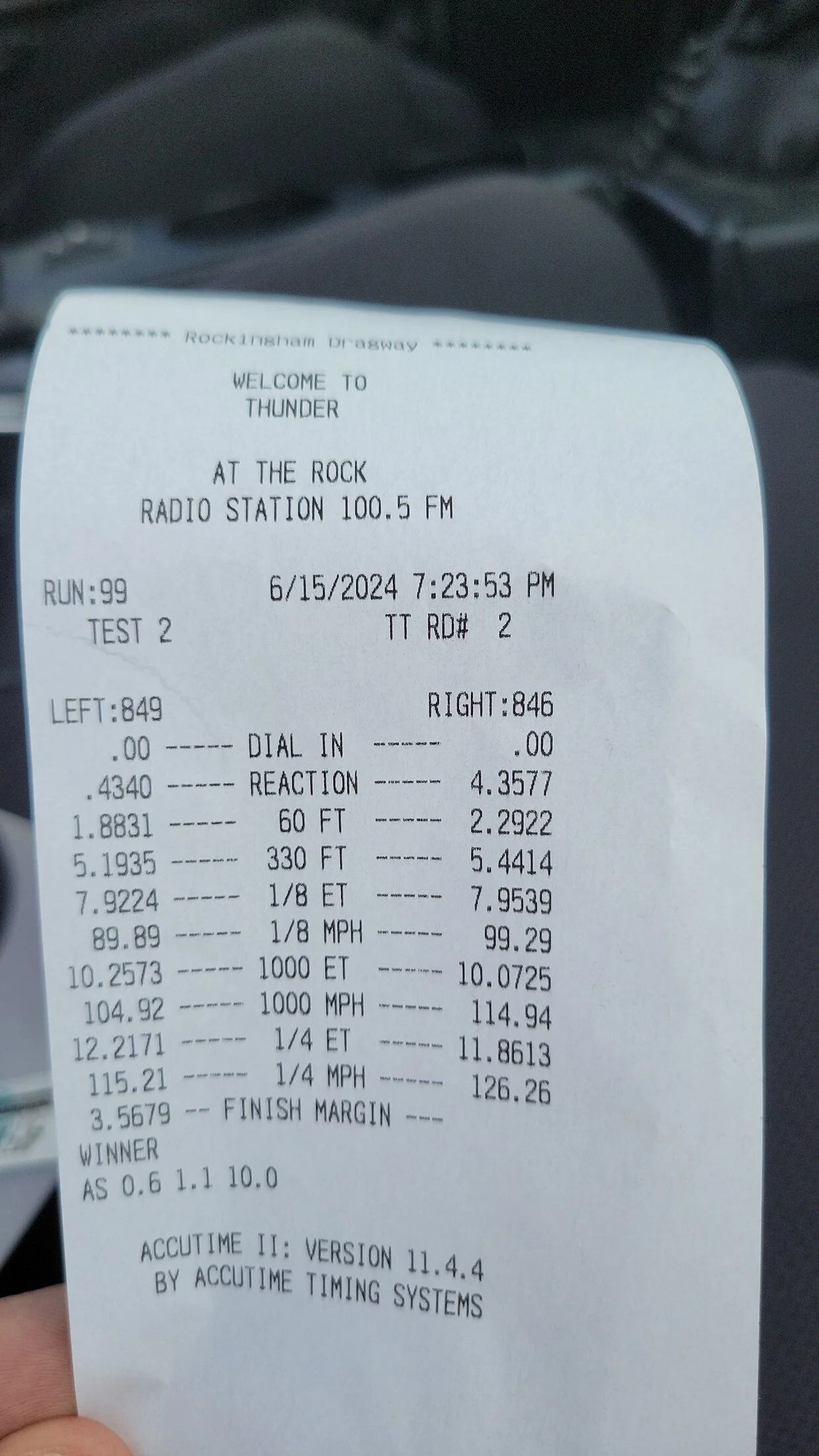

I'm at Rockingham now. 1st pass was a bust when I tried launching at 5k and bogged. Here's the 2nd pass from the limiter on a 100 shot. It's really a 65 rwhp shot according to the dyno. [email protected].
Car was hot. It's a sticky 92*out. DA is over 2,900 ft.
Right lane was a 2020 GT500. Guy's first time out.
Let's let the air and the car cool down before the next pass:
Reactions: 85GTStangGuy
Knock knock knockin' on 'leven's doooor,
hey, hey, hey hey yeah!
If I hadn't put that 3-4 lbs bag of ice back in the car, Black Jack would be an 11 sec car, lol.
Seriously, though, the launch felt great and was .08 faster than my best 60' last NA session. The 1/8 was Black Jack's quickest and fastest run ever. Something went wrong on the back half, and I could feel it. Now, the car ran and drove fine afterwards, but the slips validate what I felt. Even though my 1/8 trap speed was faster than the previous run's 89.88, my 1/4 mile was slower... 114.45 final run vs 115.2 on the previous run. wtf? I probably should have let out. Not sure if it was breaking up or maybe I short shifted to 4th and dropped out of the nitrous 3.5k min RPM window. I may pull the plugs, even though I've driven home on em to see what I can see. Maybe tighten them up a bit.
DA at this point was around 2250 ft.
Still, all in all, I was very happy with a [email protected]. In the near future, I'll bump from a 100 to a 125 and then to a 150, so long as the AFRs stay in a good place, and I don't hear detonation.
Edit: Note to self: This was run on the 125 fuel pill with the 100 n2o pill. As of 7JUL24, the 150 N2O pill (67) & a slightly smaller than 150 pill (36) is installed. The last test with the correct 150 fuel pill ran AFRs down into the low 10s. I suspect the Zex kit is done with its little lines at somewhere between 125 & 150. Have not retested AFRs, yet.

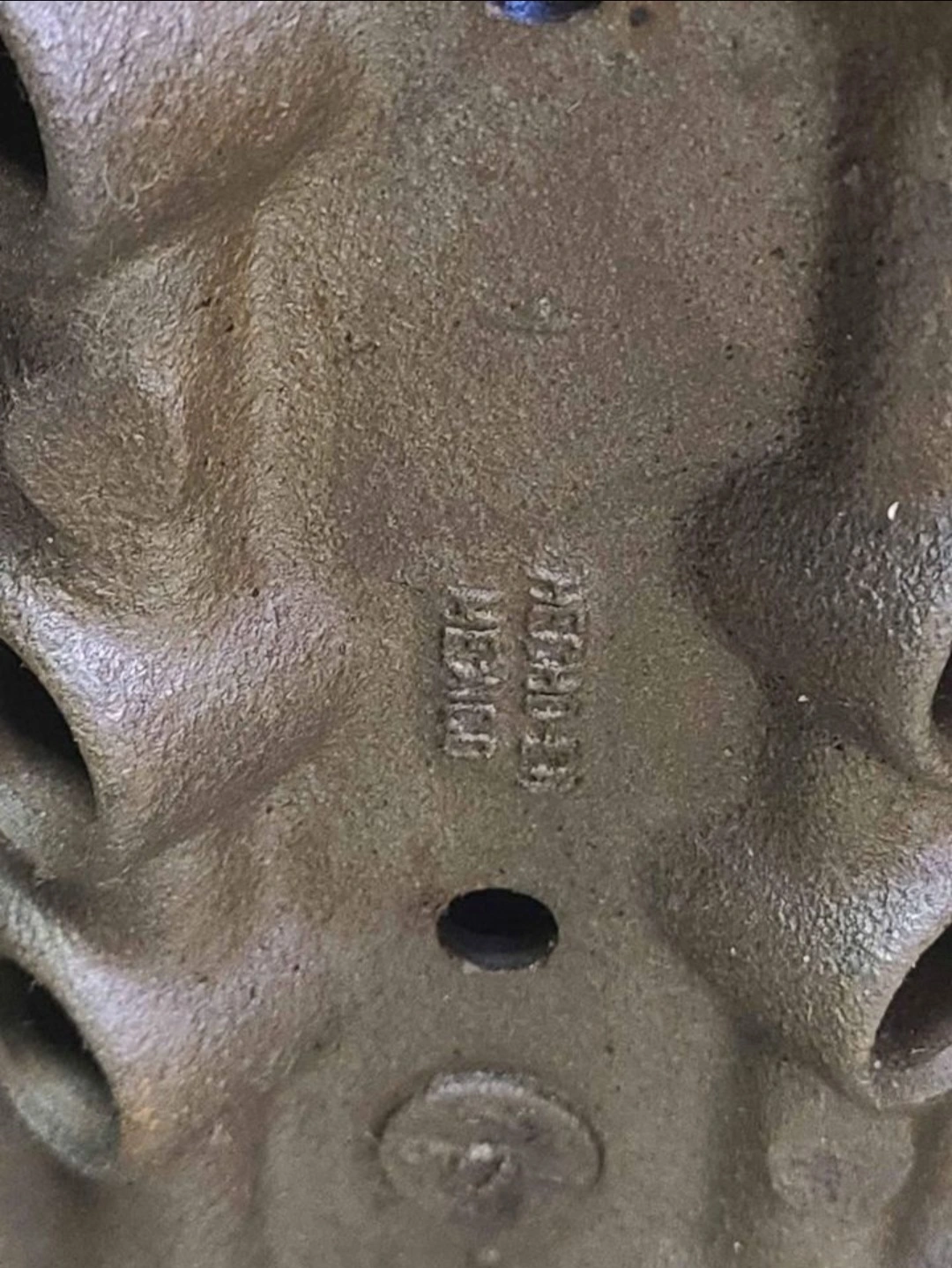

Just a minor point for information, I have a 78 Mustang that I bought new 10/1977 and it has blind head bolt holes.
Yeah, the 74+ blocks until the roller block era are the grey area for me. I understand before 74 is 'early' 302 that has blind head and main bolt holes, along with more webbing. The Mexican is the same as an early block, but also comes with the same main caps that came on the 289 HiPo, which I'm not sure are really any better, but they definitely aren't worse. Some say Mexican blocks have tougher 'nickel' metal, and others say their metal sucked compared to USA-made early blocks. I think 74 itself is considered early, but might be a transition year. Thanks for clarifying about the 77. I don't know why they're less preferred. I just know they are.
