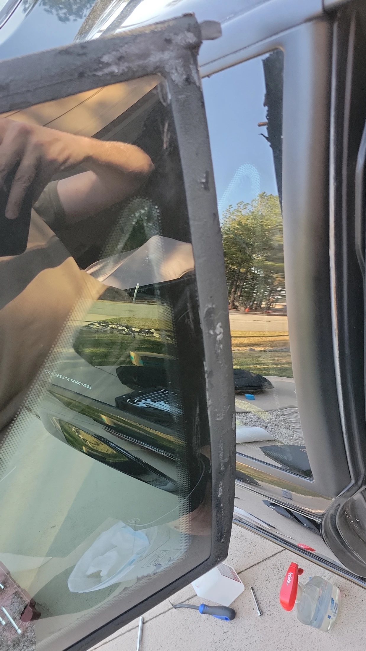

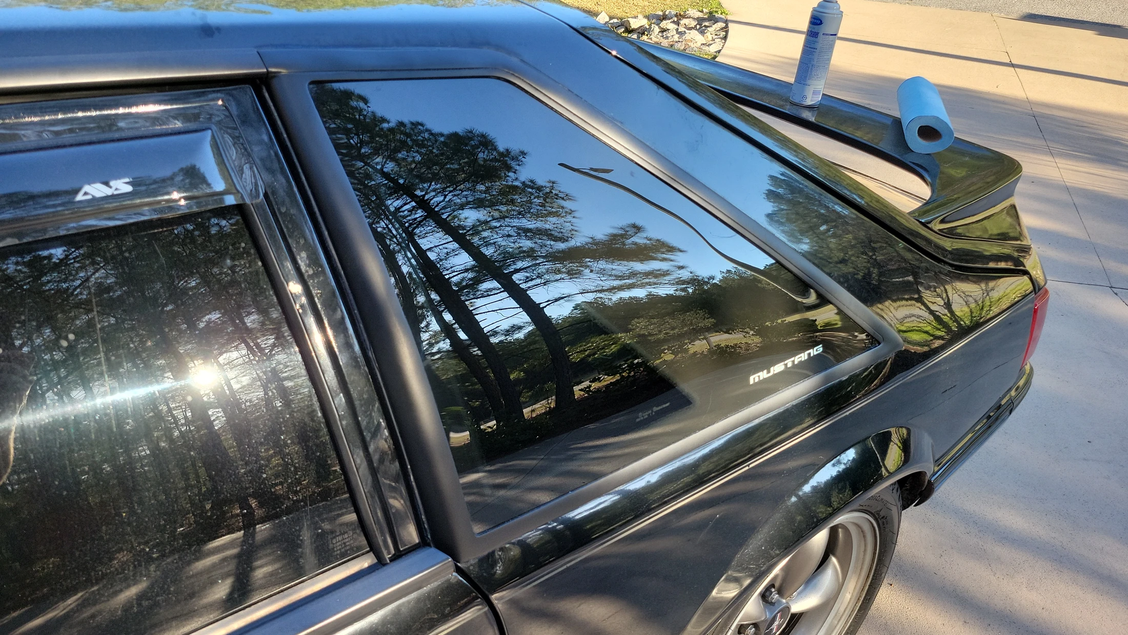

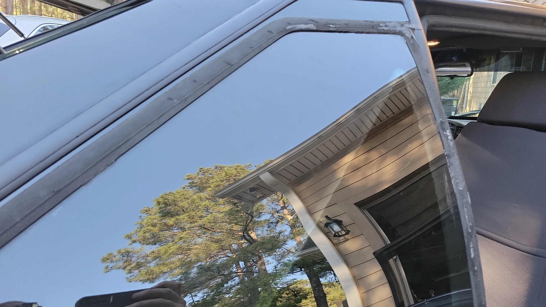

I finally got around to swapping out the 1/4 windows. The last owner covered them with glues 1/4 trim, which flew off at high speed and left behind glued and torn up trim.
When I took Father Time's windows off and replaced them with the best I could find, I sent the OEM ones to Greg Kaminski to be refurbished and he did a great job, as they were not in good shape. Anyways, Black Jack still looks pretty rough, but every step is one in the right direction.
The driver side was a real PITA. Someone used some kind of hard tack instead if butyl and I had to pry the trim off, which broke the glass.

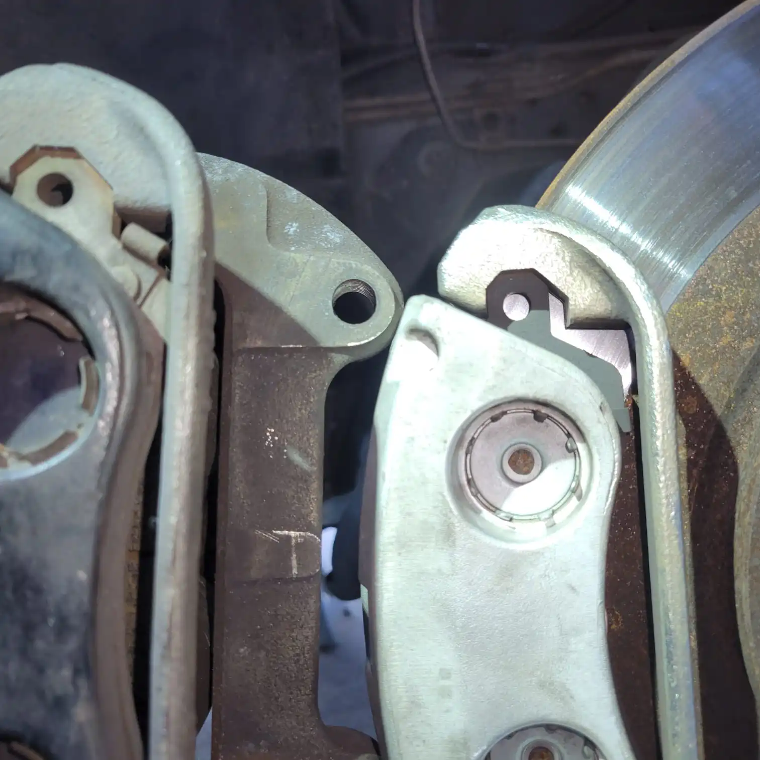

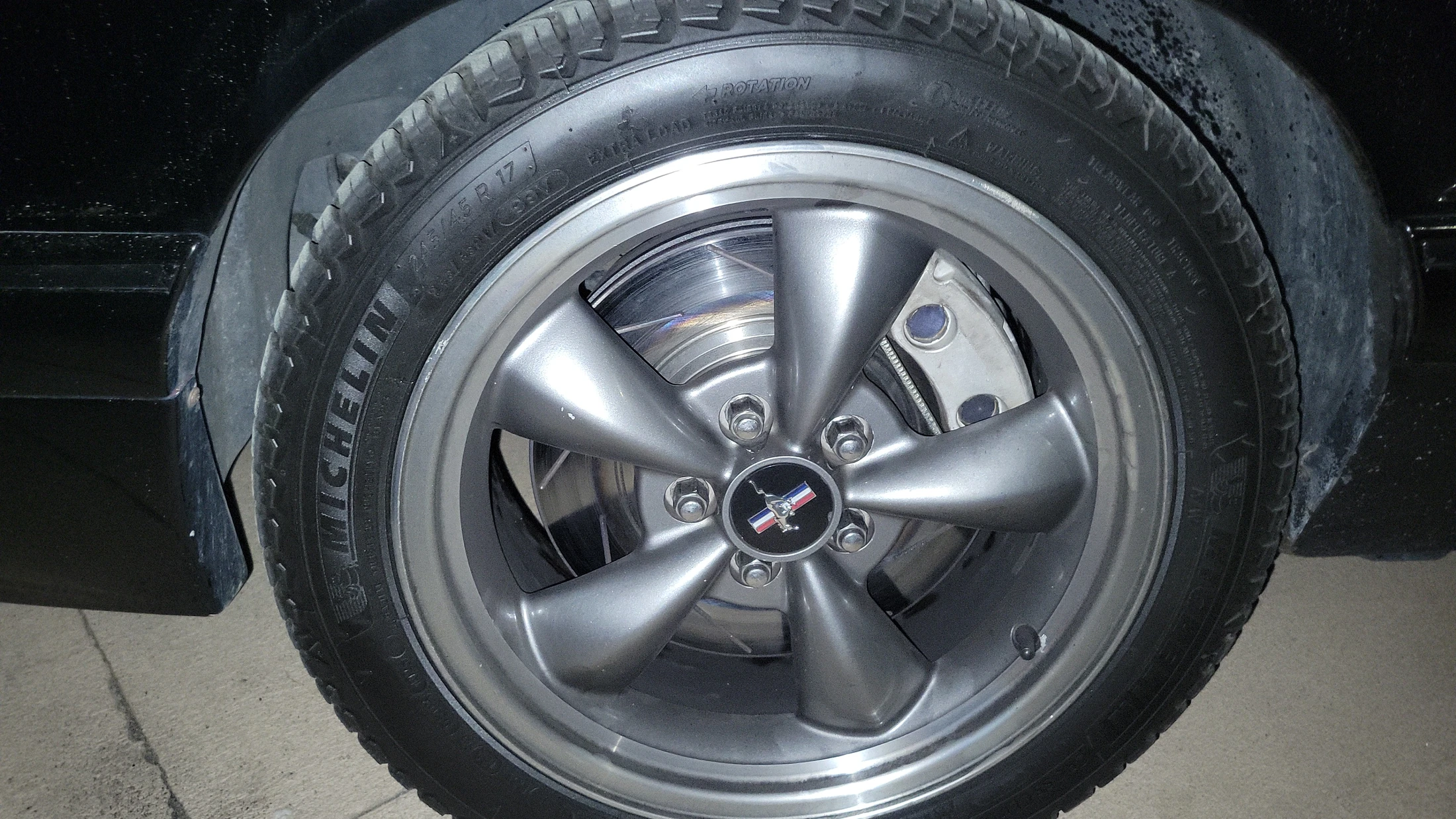

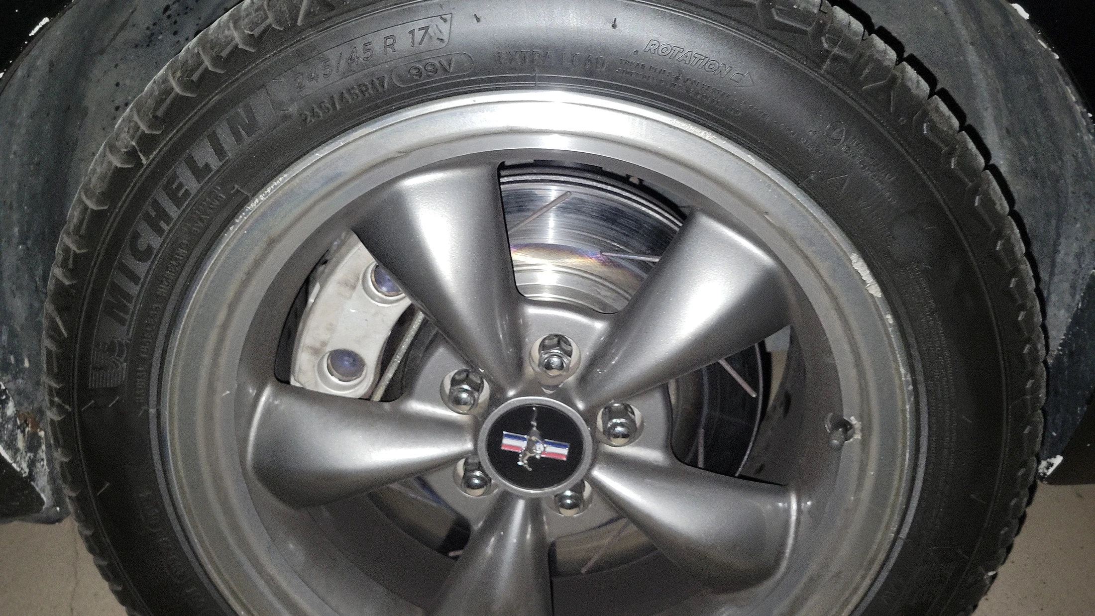

This may have been my brake drag issue:
The one on the left is my old Father Time Baer PBR caliper. On the right is the northracecars.com kit. Look at that tab and how it doesn't quite fit. That caliper, when pushed and pulled, danced around in that mount and I just didn't know better. I thought it was weird, and I must admit that it's an advantage to walk into the garage and inspect and test my other cars to ID differences. Anyways, I swapped the pads out, and on the test drive, no dragging, so far.
Oh, also, I've never been a fan of the 'swept area' issue on the inner radius of the Baer kit, but from this pic, it's obvious that's also a problem on standard SN-95 Cobras.

I wonder if there was some silly part in the box that looked like junk that was discarded.
I only mention it because I've seen "cheats" like that before. Two part part numbers, same part, with/without adaptor thingies.

It's possible, bro. Just feeling tentatively relieved. So tired of the brake drag.
New rotors, too. So, no more rust!

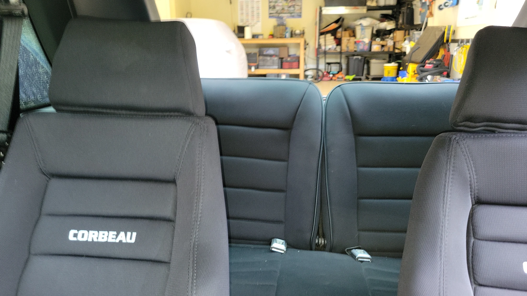

Rear seats:
After almost 2 years since I installed the Corbeaus, I finally got around to reupholstering the rear seat tops.
