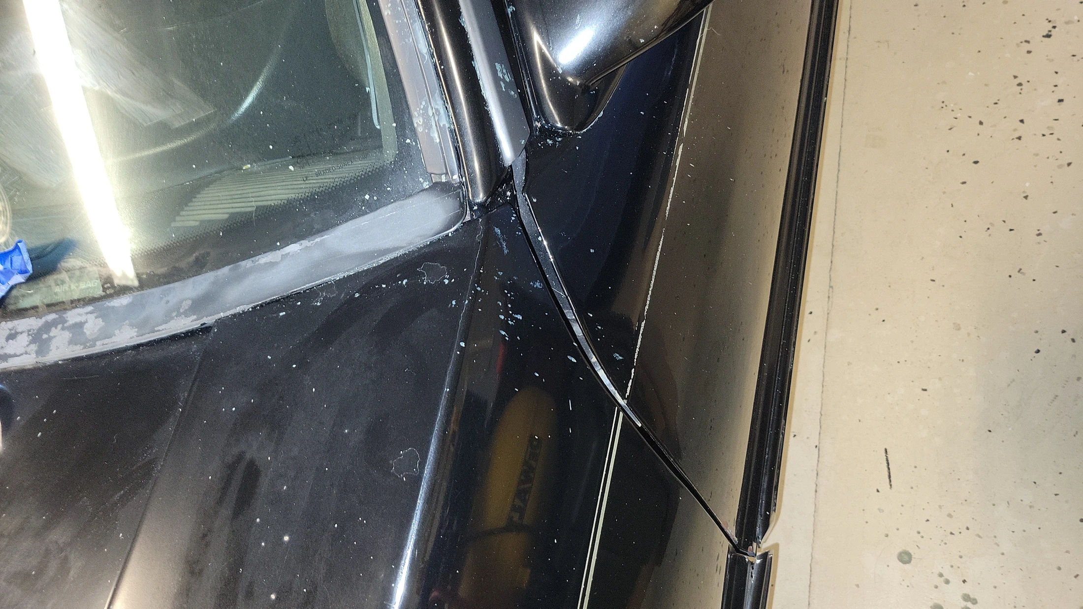

I'm off to a great start tonight. I prepped the cowl, taped off it's surroundings, Shook Up the self etching primer, and when I popped the top, it snapped the nozzle and sprayed primer all over the lower corner of the windshield in front of the driver the fender and the door. I covered it and got it into a trash can as quick as I could. Having no idea what the f*** to do, I hit the paint with alcohol, mineral spirits, couple of different types of pads in a frantic effort to get it off before it set. It worked okay, but not well.
Anyways, too tired to be upset. I'm on my way to try to find some more primer and start again. I have never in my life snapped a nozzle off of a can just by taking its top off, and especially while standing over a car. I think it's a sure sign from a higher power and I'm not meant to do body work.
:poo: happens. All right, that's my vent session. It's time to get on to whatever's next...

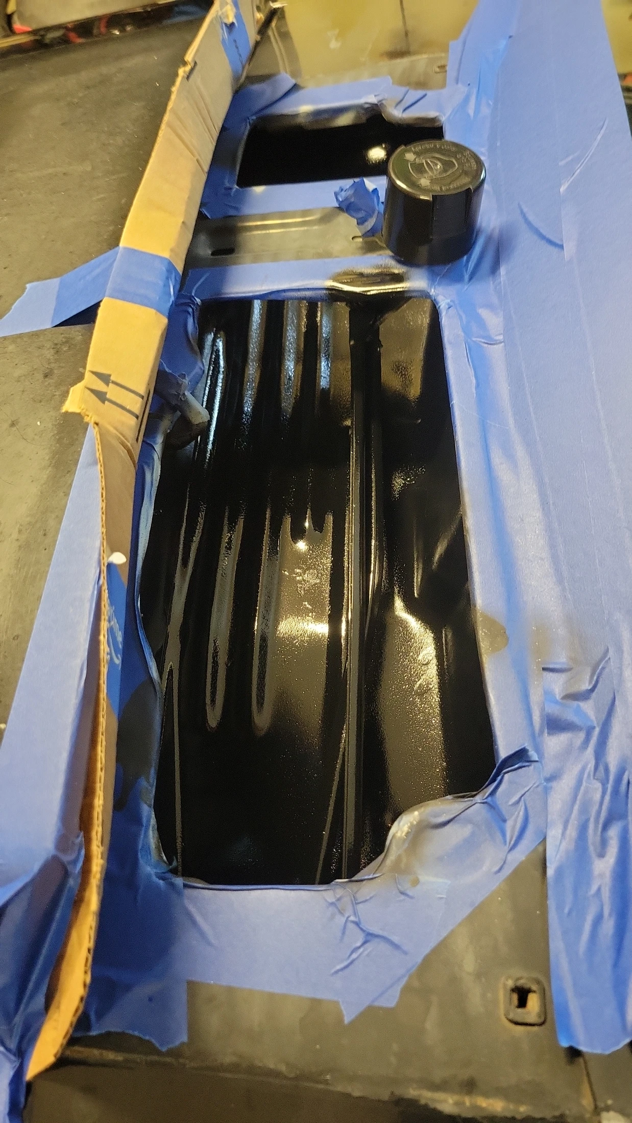

Got a few coats of engine bay primer in there, and then 2 coats of black engine enamel on top. Learned something with that stuff, too. The Raptor flat black hated being inverted and sprayed poorly, running quickly and clogging, while trying to get to the nooks and crannies. Both the Rustoleum primer & paint cans allowed spraying from any angle, which was MUCH nicer, and easier to apply evenly. I'm a tad worried that mixing paints from the flat raptor to the gloss rustoleum might cause a reaction, but we'll know in the morning.
Alright... solved one problem & created another. It's not pretty, but at least the cowl rust is in check:
