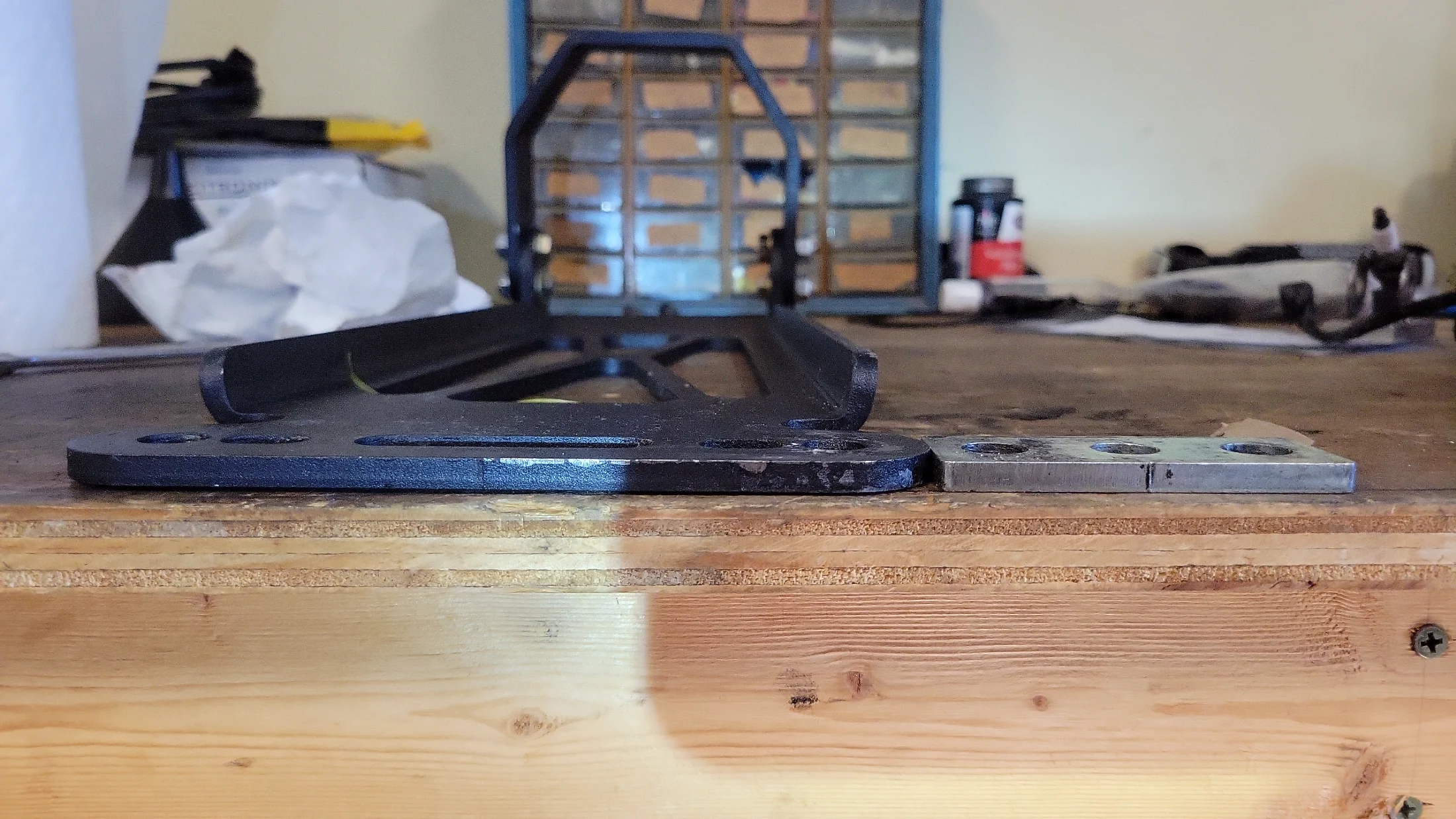

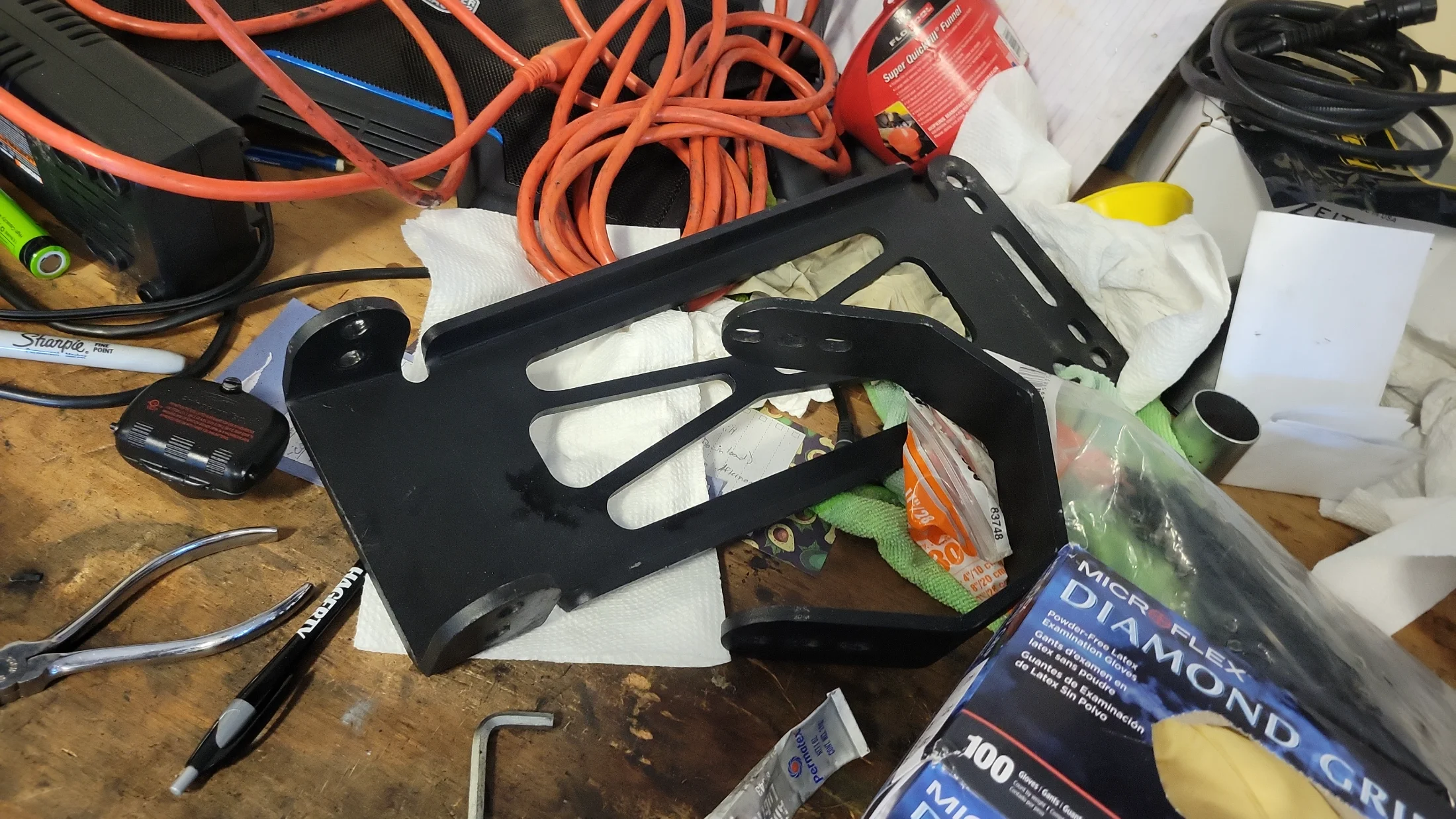

I'm including a picture of the original spacer beside the Stifler's mounting plate. I haven't measured them, but I'd bet they're both approximately 1/4" thick. The loop wasn't contacting the tunnel, either. There was plenty of clearance.
I still don't understand exactly how something hanging off the back of the transmission could produce such a severe vibration tied to engine RPM. My best guess is some kind of structural resonance. It absolutely blows my mind.
And I owe rednotch some serious credit! He kept pointing toward the transmission mounting arrangement and the possibility of resonance, even describing a similar experience with an HPM crossmember. I couldn't wrap my head around how that could explain an engine-speed vibration, particularly one that occurred while stationary. But he was absolutely on the right track! And when he asked where the vibration was strongest, I reported feeling it at the transmission tailhousing and safety loop rather than the engine. Pretty enormous clue in hindsight!
Frankly, I'm done experimenting with that thing. I'll install a conventional driveshaft safety loop and call it a day.

Nice that you figured it out.
I run the same Stifflers driveshaft loop and don't have any issues at all.
I don't know if it has anything to do with me running solid engine mounts and a solid transmission mount or not.
Glad its gone. As for the loop, I can't say I'm a fan of that design, good chance the tail housing gets trashed with a regular loop if a d/s fails, but that one almost guarantees it does with its mounting points. The spacing looks identical, I assume your running a poly mount? If you have a stock style rubber one, you might want to try it with that and see if it returns or not. All mine have the old hpm style one, think summit has them the cheapest now https://www.summitracing.com/parts/sum-g7905
